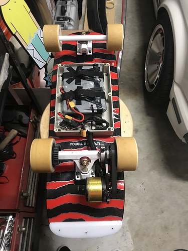

My very first build, a 6s4p, with an antispark switch, and two TB VESCs. Not the best wiring since i did not solder much and just have a lot of wires, and did my best to squeeze everything in.
Ridden for a couple weeks when pic was taken

My standard practice is to use small braided sleeves over small wires like the PPM wire and sensor wires. Also to use velcro to adhere the components to the deck. Hot glue onto connectors to ensure they do not rattle loose, and placing the wires so they do not overlap each other. Another thing i like to do is to use the rubber feet that’s used on furniture, pasted onto the battery. Or to doubleside tape a layer of craft foam, 2 to 3mm thick, onto the enclosure. Having all components cushioned and not in contact on the hard surface on an enclosure is :ok_hand:
Any other tips would be greatly appreciated, but yea this is how i would go about settling my internals. Now it’s your turn :wink:
