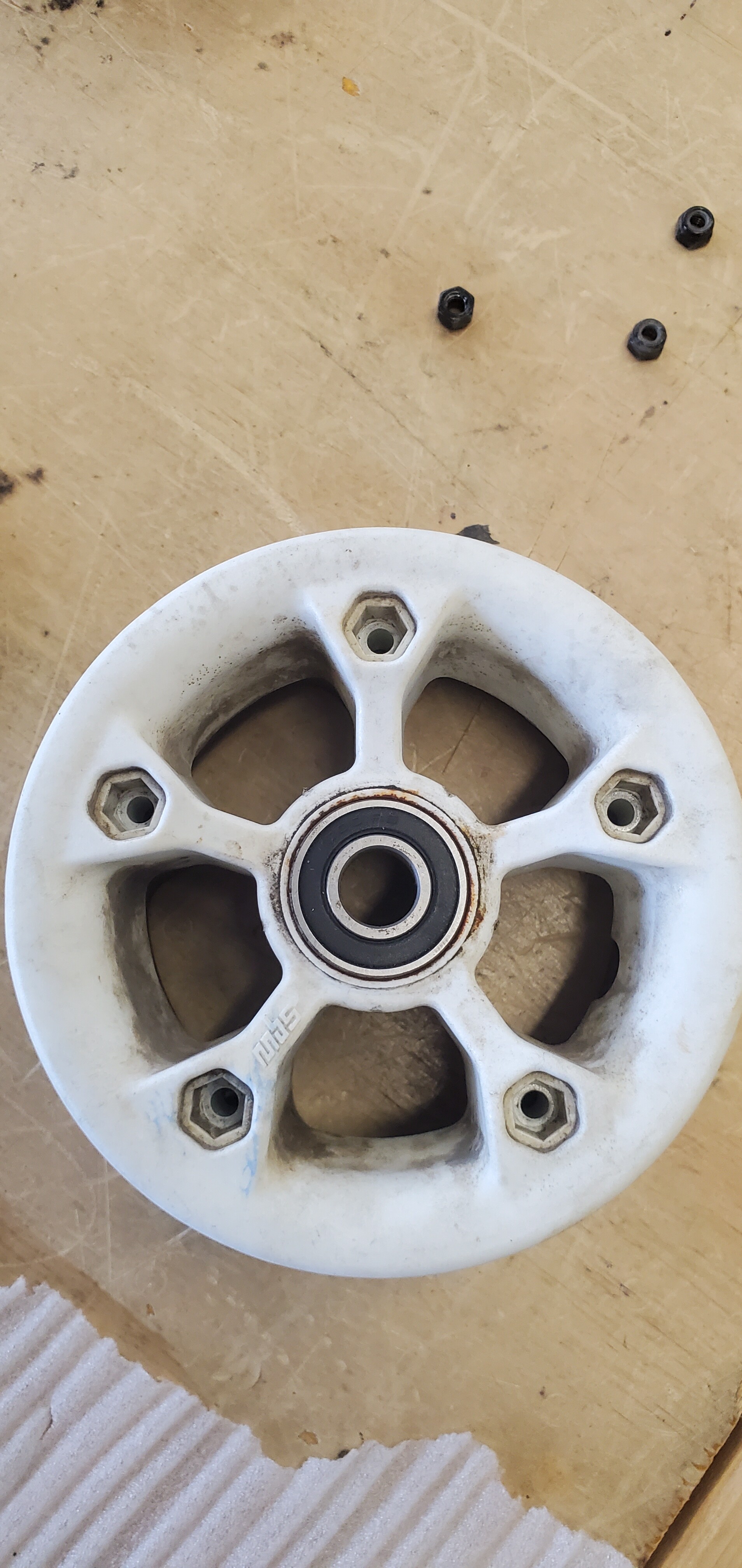

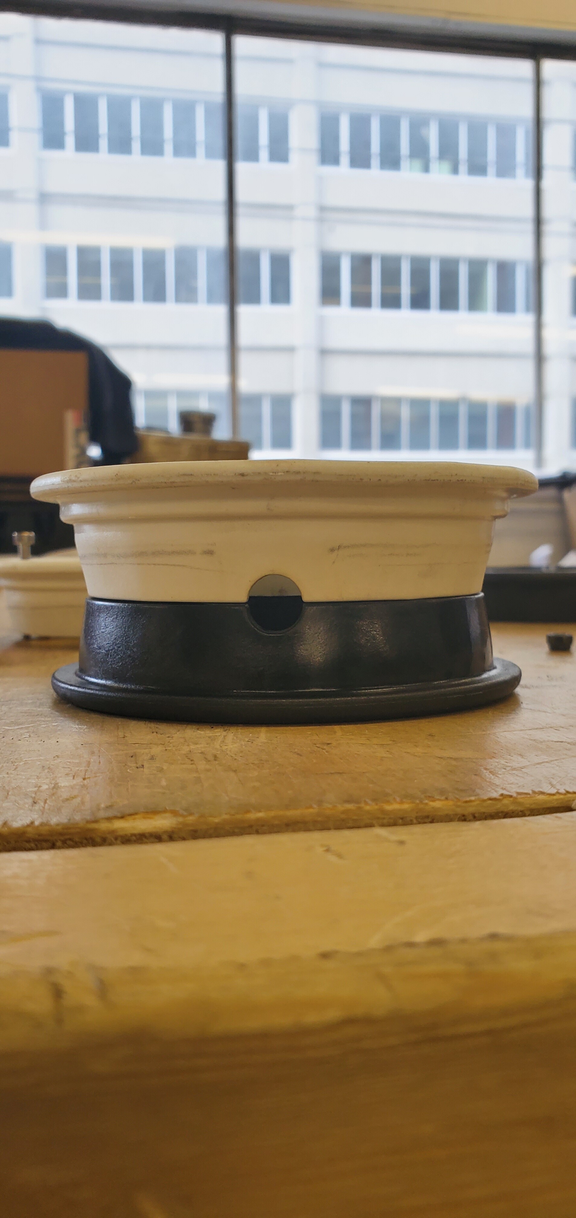

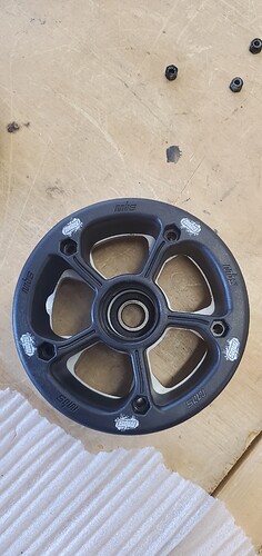

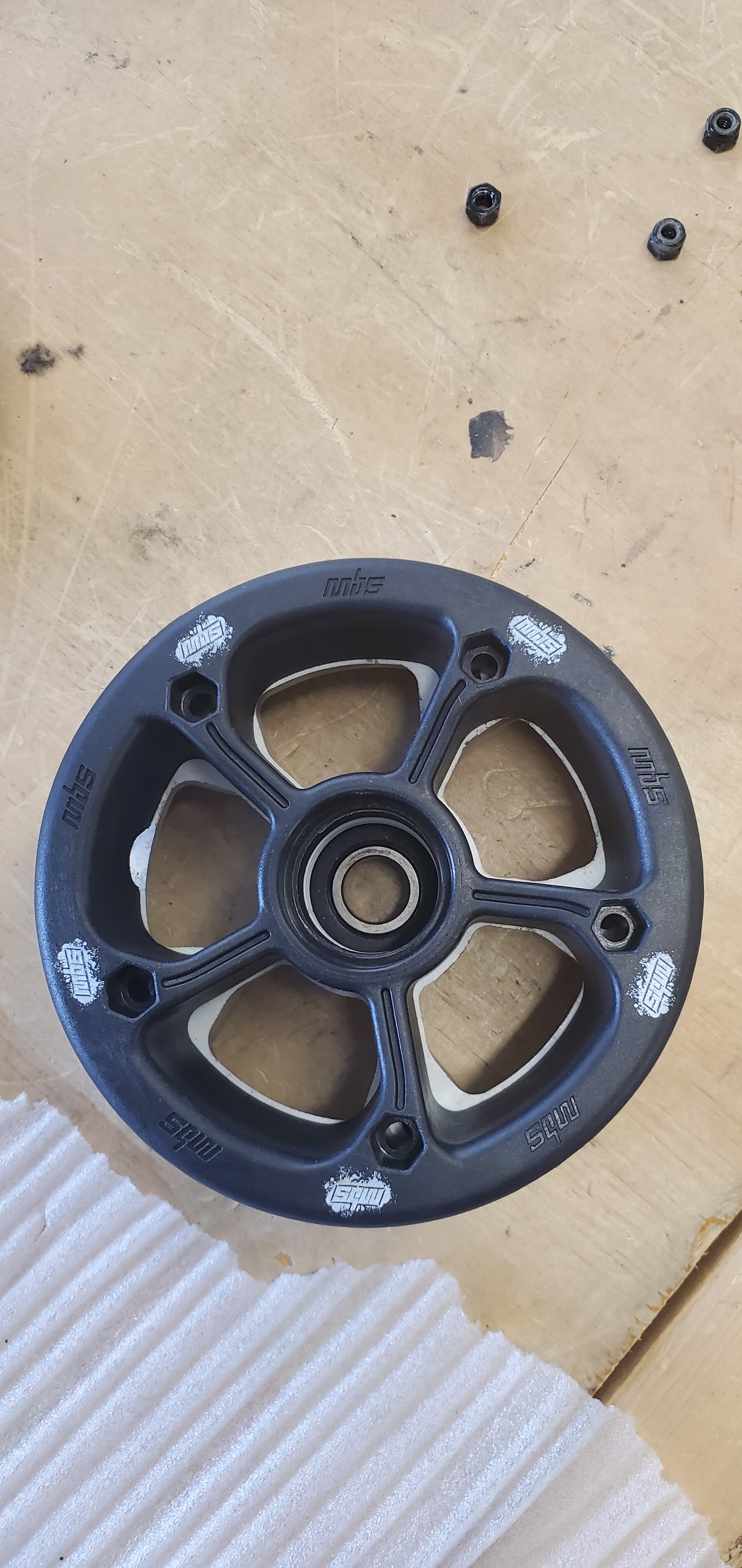

no clue how filled I have to print it to retain strength, especially since I only got PLA, but I’l do some… testing
I think the first things that would give is the male pins on the spacer since that’slayer separation is bound to happen,
gotta print a bunch to see!
It shouldn’t matter too much imo with the fact it sandwiched in between the 2 halfs with screws
Oh btw, for anyone needing to know this.
MBS rockstar 2 and MBS five-star
Both have the same internals
Therefore these spacers (in post 388) have a good chance of working for either
(Black rockstar / White five-star)

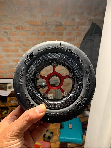

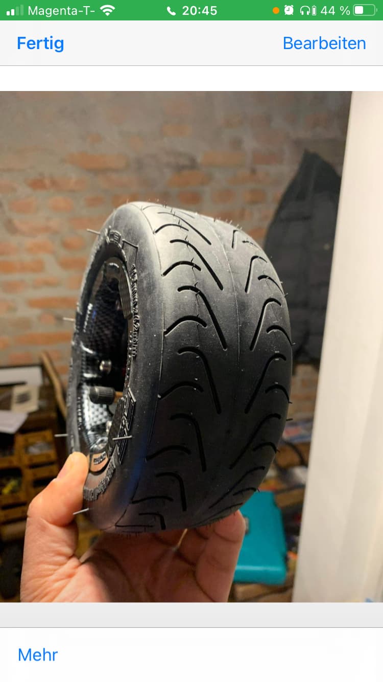

Hey guys!!
Wht kind of widening do i need to get these tires fit to the trampa rims??
Kr and thx very much!!!
u need either moe stooge wheel widening kit or some long bolts and a 3dprinted superstar spacer
I’m having a bunch of spacers made. I can hold a set for you $60+ shipping. No extra axle space needed.
