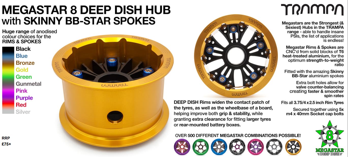

I am having spacers made for Trampa super stars that make them wider than what’s above.
$60, DM me

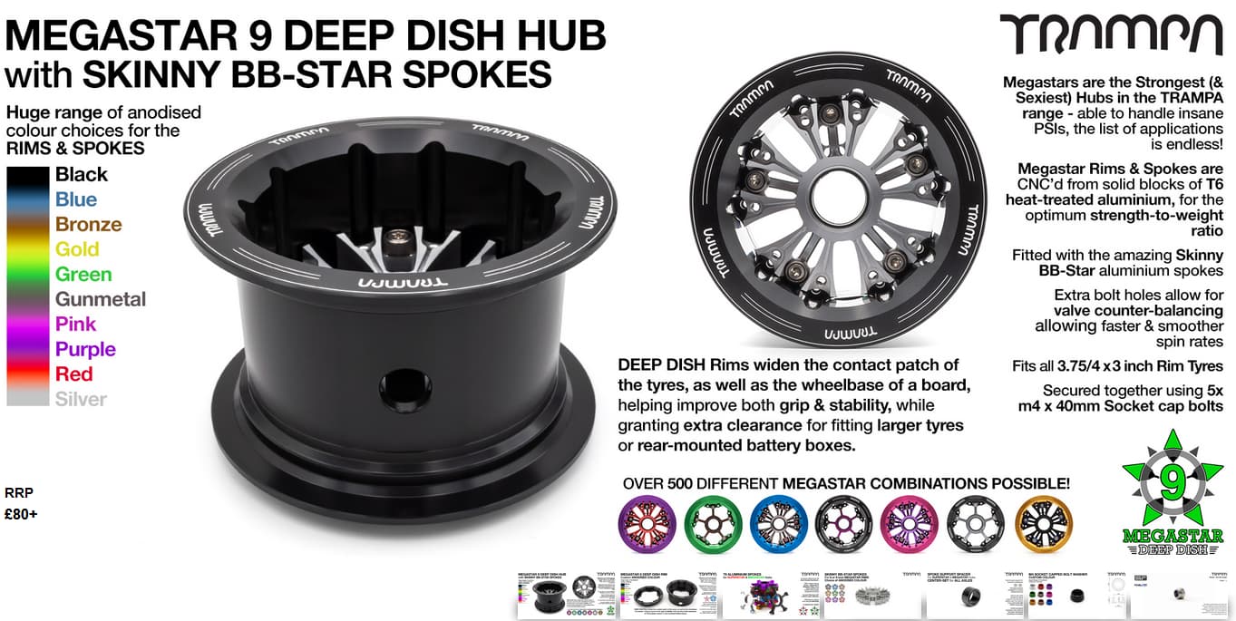

@Trampa got any pics of deep dish fitting 8.5" x 3" tires? Or is even compatible for that matter
interesting, would they fit 608 bearings for 8mm shafts or only 10mm?
They will fit the big bearings trampa uses, so I think 28OD, someone correct me if I’m wrong
hmm, I wonder if they’d work with these:
These work if you choose the simple 5 finger spoke. The fancy BB Star spokes are for OD 28mm bearings like 6001RS.
They will.
