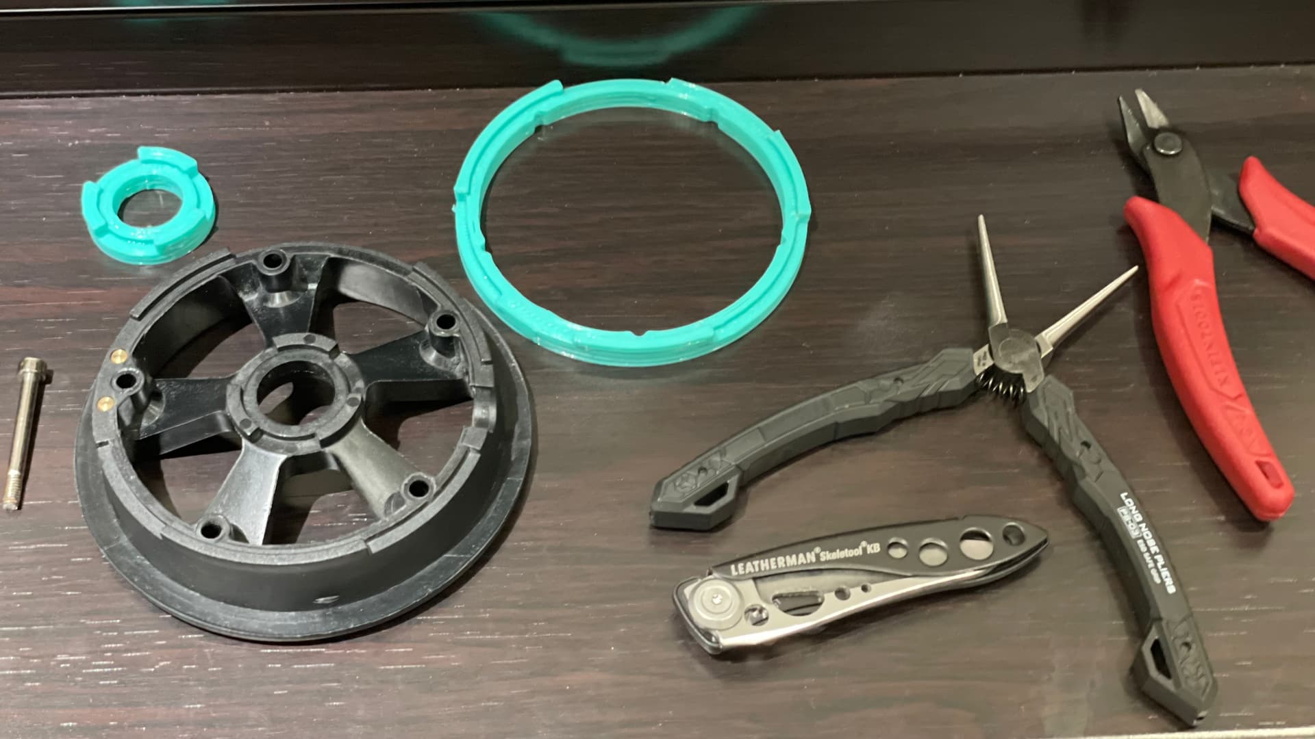

I’m stubborn, so I’m in the process of modeling a 3D printed widener for the evolve hubs too:
