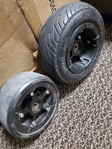

I widened and printed the outer half of the rim, haven’t tested it yet. I still need to print 3 more.
Oooh I see it now. Looks like it worked well. You going to roll the die on 3D print or get it machined after some testing?
Still not sure, considering testing the 3d prints then might machine some.
i personally wouldn’t trust 3dp hubs on an eskate, however if you don’t ride fast, keep off of rough terrain, and don’t jump you might be ok.

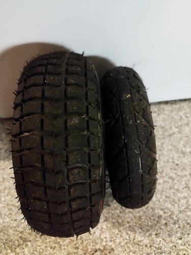

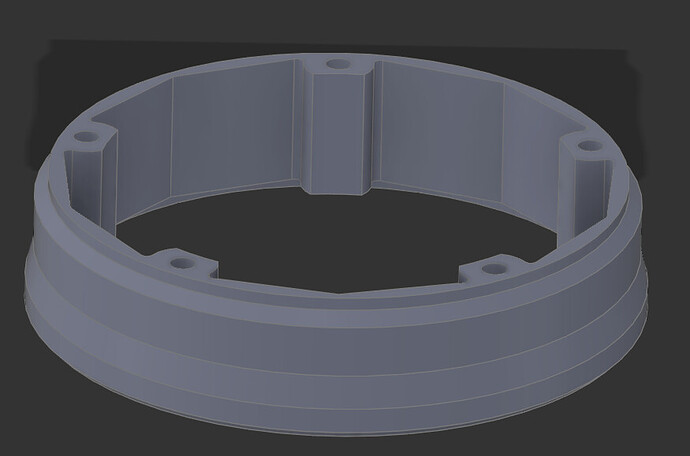

I’ve made a set of wideners for the rockstar ii pro xl hubs. +20mm width for larger tyres like the 9x3.5-4 that I have here. At the moment I have it printed out of PLA+, hopefully it will hold up as I’m quite hard on gear, especially on tyres. Tried printing nylon but I struggled with it so much that I just printed these out from PLA+. When I have some spare time I might give nylon a go again but its a pain in the butt on my printer at least. Or once I get my CNC up and running (probably 2 months later) then I’m gonna cut them out of aluminium just to be sure
This tyre definitely looks stretched a little bit, but I have a set of slicks coming that are slightly wider so I imagine the fit is going to be perfect for those.
Simpler method for metal ones is sendcutsend, ive used it for these exact hubs and i think i even still have the file.
Yeah I am aware of your design, but it I would like to use the interlocking feature between the two sides of the hub. This design has that feature implemented. Sadly its not possible to do that feature with a laser / waterjet.

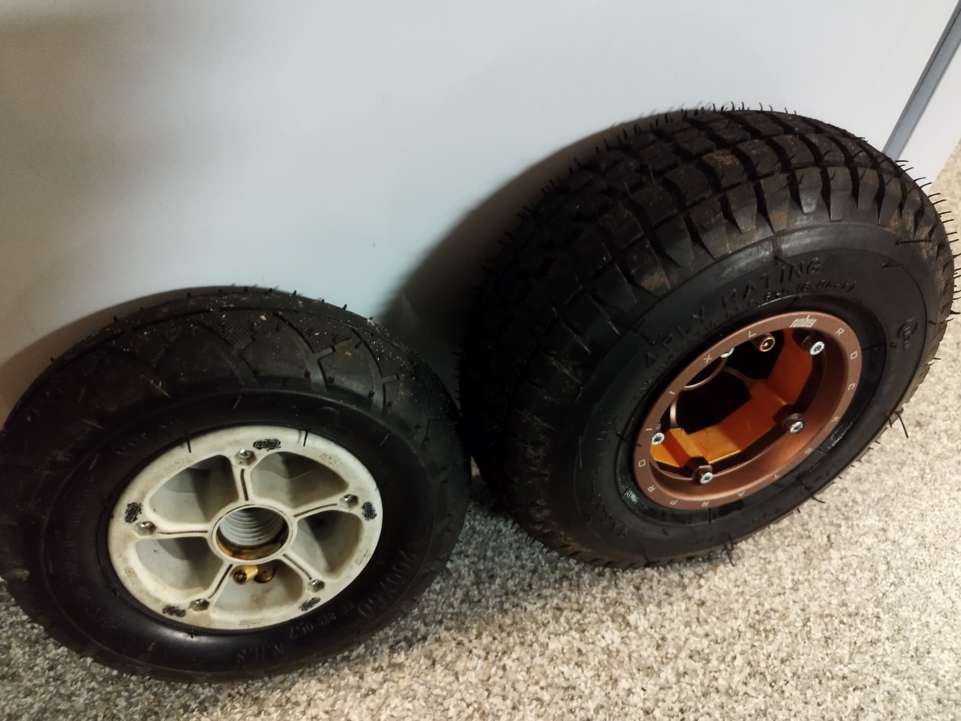

Dam @rich your tire/hub set up is perfect (8" 200x50 clever tires stretched patch w/ Etoxx hubs 60mm) but are there any other hub options able to achieve the wider patch w/out having to pick up an additional part time gigalo job!?
Maybe the mbs rockstar pro 2 XL alums? I don’t like the way the trampa hubs look.
Also how can I google search for those particular 8" clever (off road?) tires? I only see the AT’s.
Can you post a pic of the side view of that/your combo?
Bad ass.
You could buy one of the new MBS hubs if youn want to save money. On the pro 2 XL’s is a gap on the outside when you use 8" tires.
