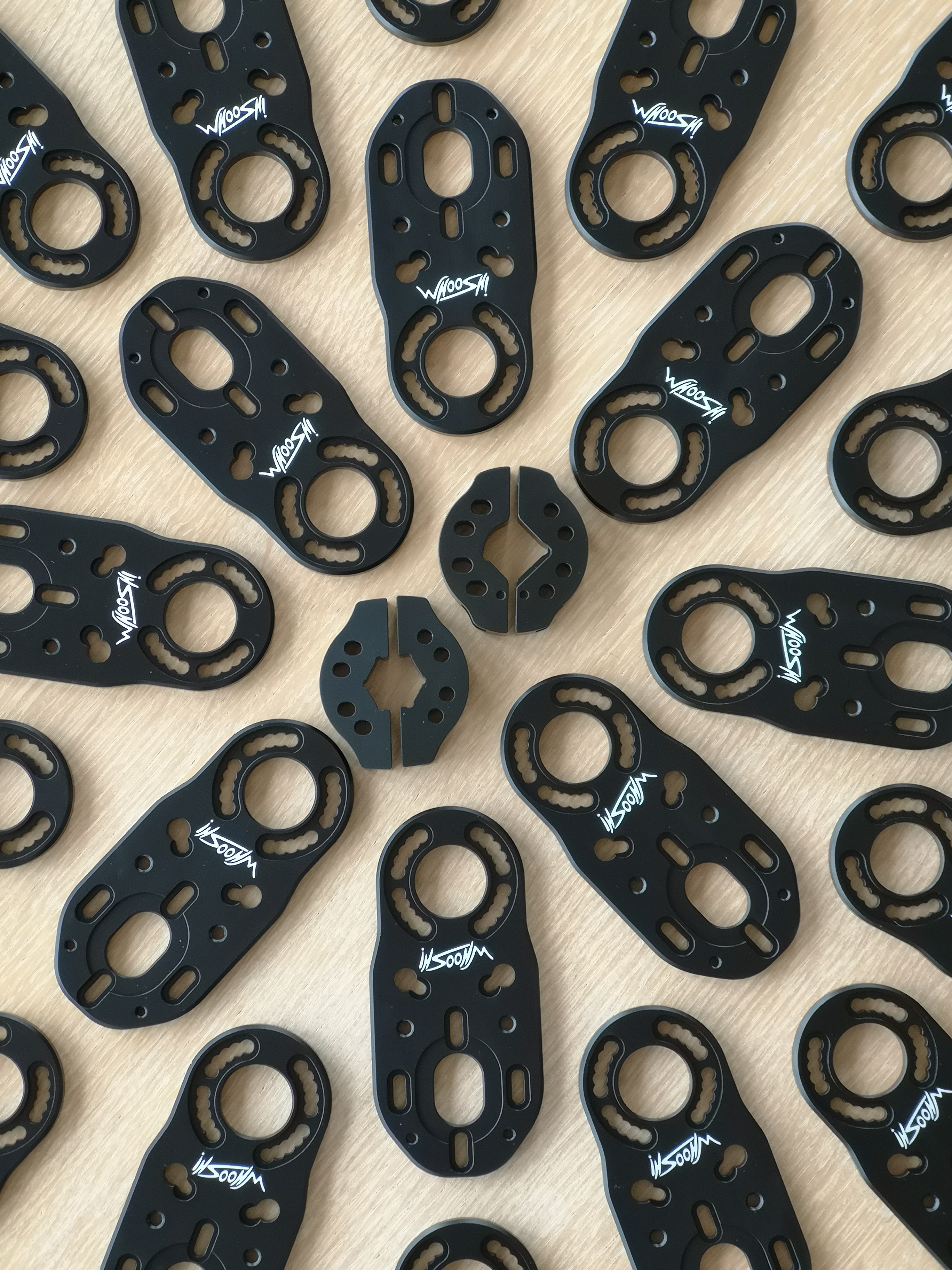

Whooshboards motor mounts, truck, pulleys +++

Are your flywheel pulleys compatible with clone cores? I don’t see them mentioned anywhere in the thread or on the webshop.

Yes, they fit the clone cores the best. Very tight fit on original cores.

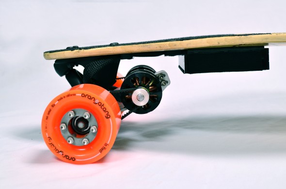

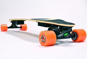

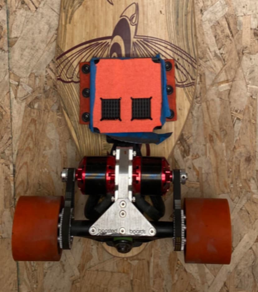

This mounts are probably not long enough for something like 18:66?
Just put the motors in front of the front wheels.

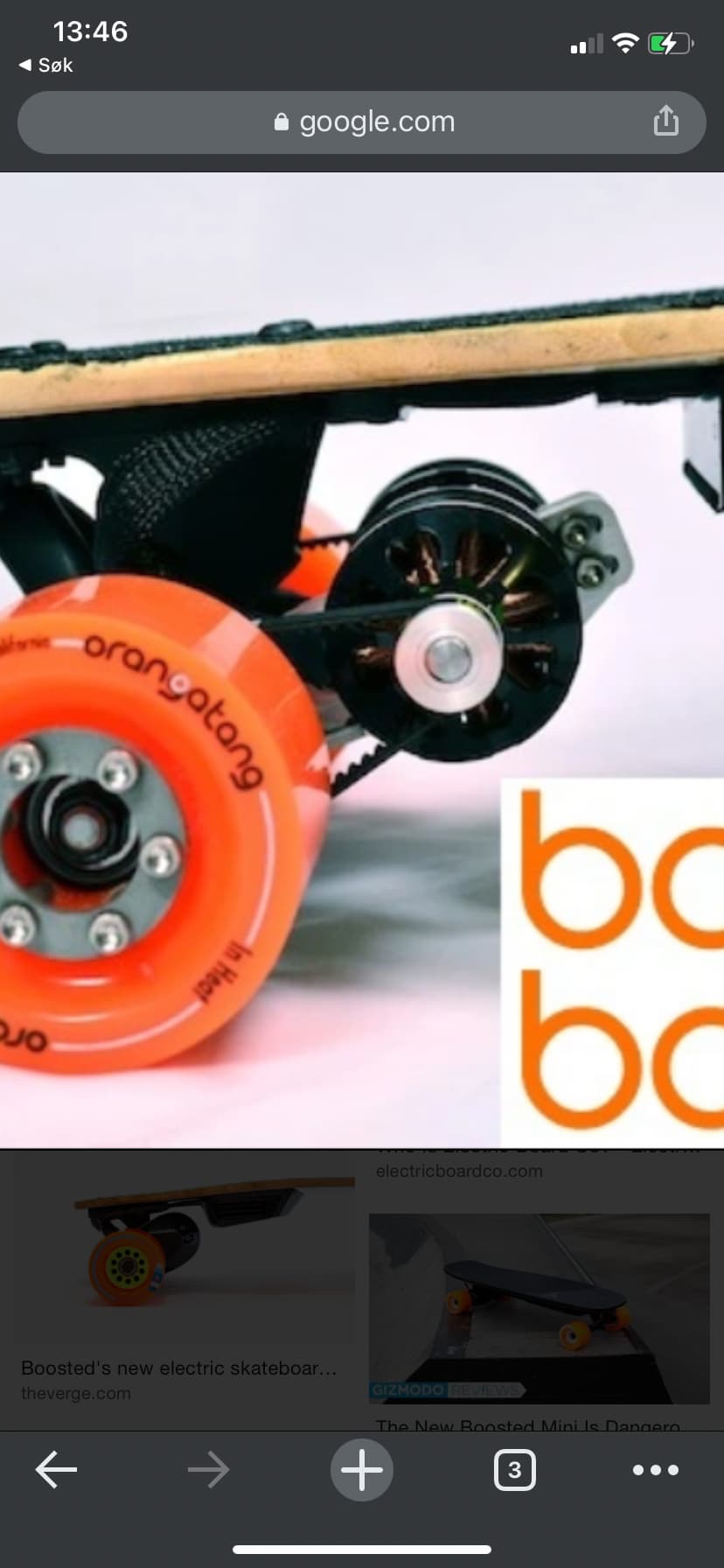

What if they are in front of the rear wheels, will they still get hit? Is that what they did on the first boosted prototype sort of? Edit: no, they let the motor take the strain and had pulley on other side:
Yes, but not as much as if they’re behind them.
I never saw any Boosted prototype with the motors in front of the front wheels.
This is the only one I know about
boosted-prototype-drivetrain-profile
Here is a better view of the boosted proto, maybe there is another solution combining all of these ideas, for a narrow truck drivetrain:
