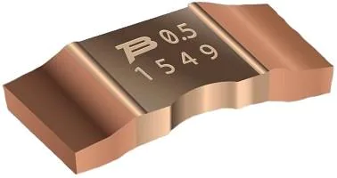

It does have phase shunts, but the difference between low side and phase shunts are about the placement of shunts rather than the look. Usually phase shunts are going to be visually very close to the phase wires.
They are simply resistors and on VESCs usually look like this
or like this
The values can be different as well.
I know that and they are 100% between the phase wires and everything else. They even often come with some of the solder from the phase wires touching one leg of the resistors.
I had to look way too long at different photos of their FESC to ensure that it won’t be an issue or cause a short. Some of their own product photos will show them touching and others don’t have the solder touching them at all
The hardware layout resources directly from VESC project also show the resistors as connected directly to the phase wires, which further makes me think it should be fine. I’ll probably try and get them to not touch if I can find a way to remove the conformal coating on the entire area at once. It does melt of with a soldering iron but only where it directly touched, and I think it isn’t helping when I try and remove all the unwanted solder on the resistors.
There is the possible issue of not knowing which leg of the resistor connects where on the PCB but I think it is safe to guess that the side closest to the phase wires is connected internally (via the pcb traces) to the phase wires.
