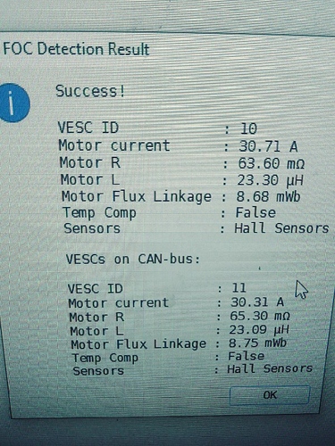

I got HFI up and (somewhat) running… Unity FW 5.1 only one motor spins up on the bench unloaded, the second motor spins up with a little help, a nudge… then it works… on the road I notice it slightly, however on a slight incline the motors cog severely… on flat ground no issues… both detect using the wizard…
can anyone offer me some insight?

Did you follow this video exactly?
What numbers did you come up with?
Also try lowering the Sensorless ERPM HFI setting; the default is way too high imho, try 1000erpm. I’m about to try even lower than that…
as close as I humanly could!
my issue is only 1 motor spins up automatically on HFI the other motor gets lugged along for the ride… as soon as it’s nudged, moved, rotated it spins just fine…

My numbers are
HFI start voltage. 30v
HFI run voltage 18v
HFI max voltage 22v
Are you setting up each motor @kook? Or just the first one? Sorry if this is an obvious question but you need to select and configure motor 2.
I was naughty and pushed the same from motor 1 over to motor 2 also. Did I do bad things?
Its generally ok to run the same settings for both motors of same type (except the hall sensors might need custom settings) you just need to make sure to set both motors to HFI with same voltages.
Cool, they’re hummie hubs with no sensors.
Just did detection of both motors then went through HFI on one motor. Then used the 3 parameters the same one on the other one…
