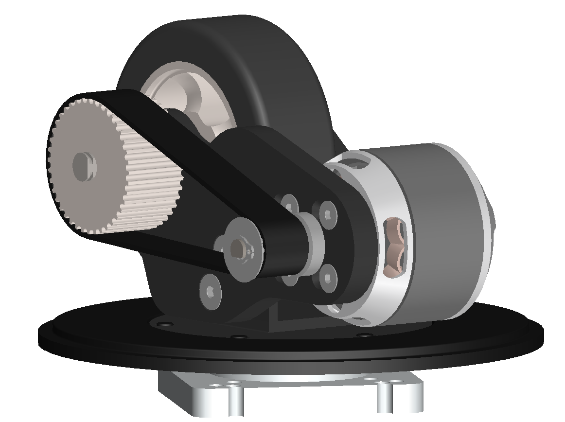

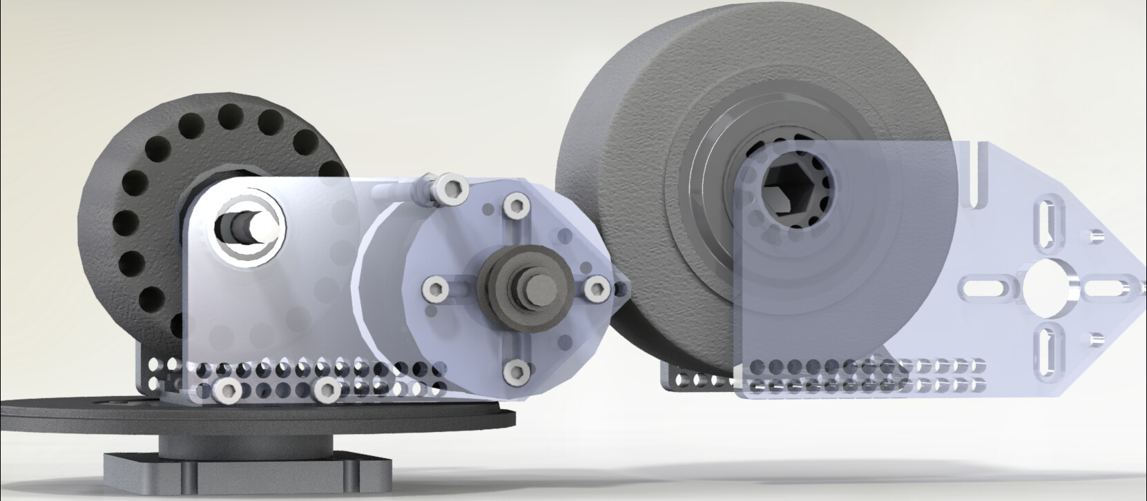

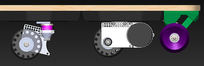

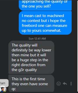

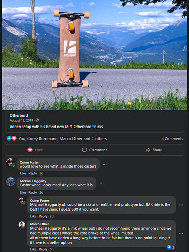

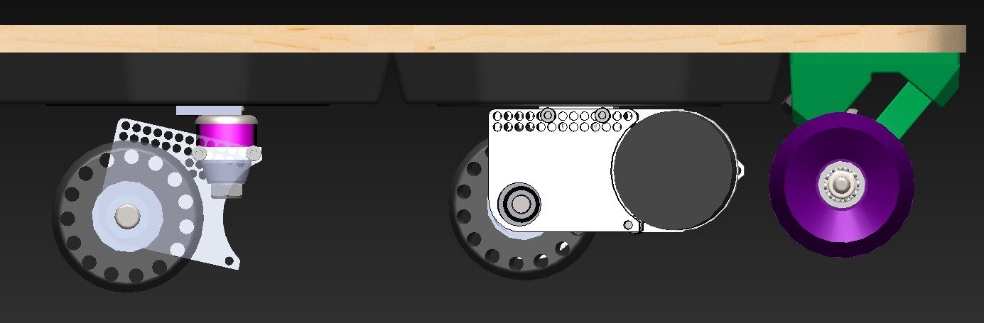

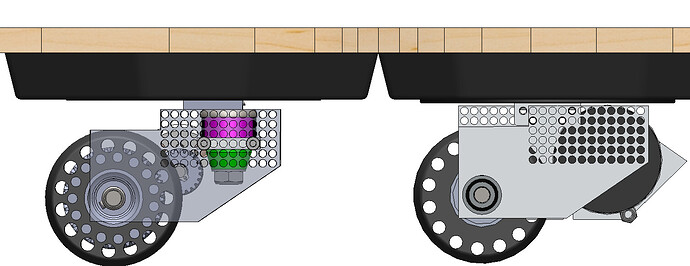

I have been studying the first pics coming out of the Freebord 5 and 5-X parts getting ready to model all those. here I asked Marco Other about how the quality of his caster compares to the new gen Freebord ones.
Not sure where to place the Summerboard Caster on the quality list, somewhere between Freebord alpha and G3-R I think. Depends on if you count the housing plastic parts or consider them a required upgrade to truly compare.

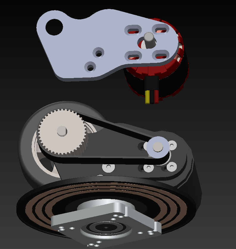

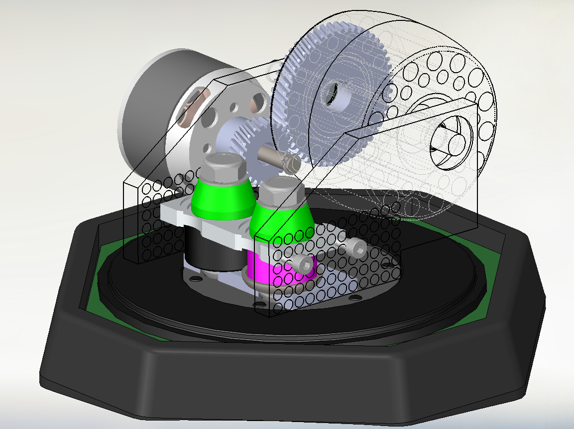

My end goal being allowing you to buy/take freebord casters and attach the SBX slip ring system and a boardnamics drivetrain of sorts.

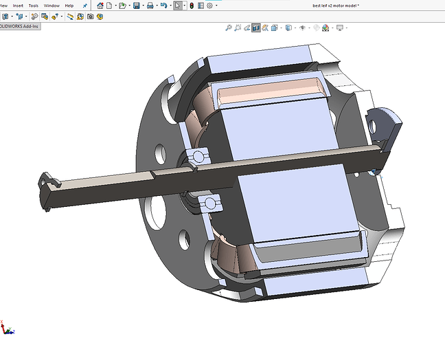

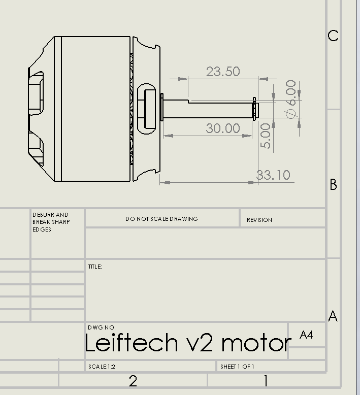

Leiftech motor mount 30mm bolt pattern.STEP (186.8 KB)
best leif v2 motor model.STEP (2.4 MB)
Leiftech V2 closed motor shaft.STEP (45.9 KB)
leif v2 motor drawing.SLDDRW (90.9 KB)

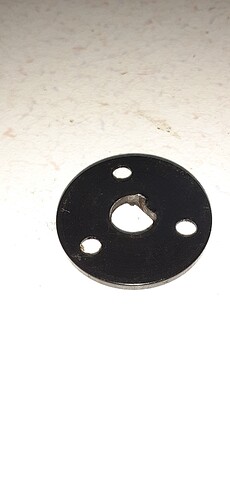

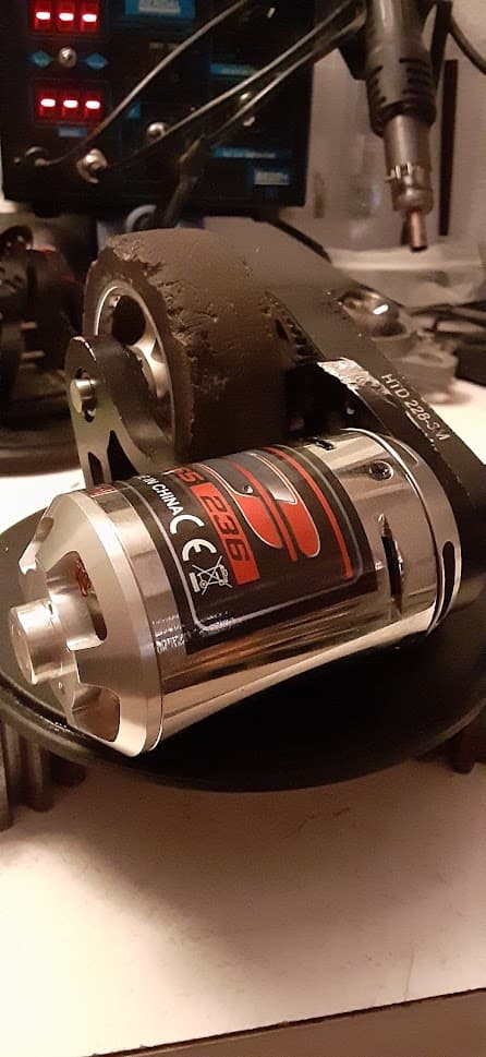

This plate that locks the axle to the rotor can gets pounded till there is quite a few degrees of rotational slop. This actually helps a lot on startup from a standstill allowing some erpm on the motor before any torque is applied to the belt.
It would be an interesting idea to play around with limited slip clutches on the drive system, allowing the belt to survive geting spun up in a jump. Ir just a much more aggressive version of the sloppy axle allowing near a full rotation idk.

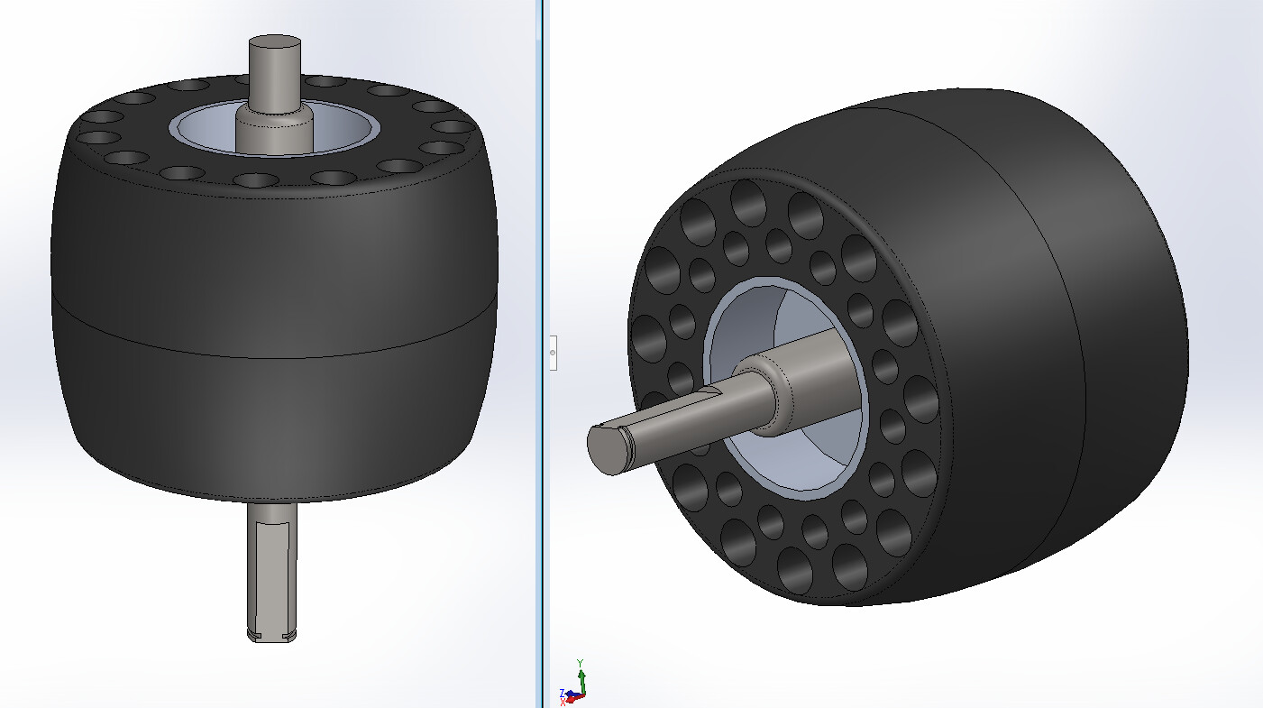

bad model posted previously
SBX FRESHIE v1.STEP (298.9 KB)
SBX FRESHIE v2.STEP (335.5 KB)
on the v1 wheel they got ripped up, this is how I finally got a wheel.
I tried to remove the rubber but ended up cutting it at the holes.
SBX wheel freshie v1 tread cut off.STEP (217.1 KB)
this I will use to cast my own tread onto, thinking a single use mold will be easiest.

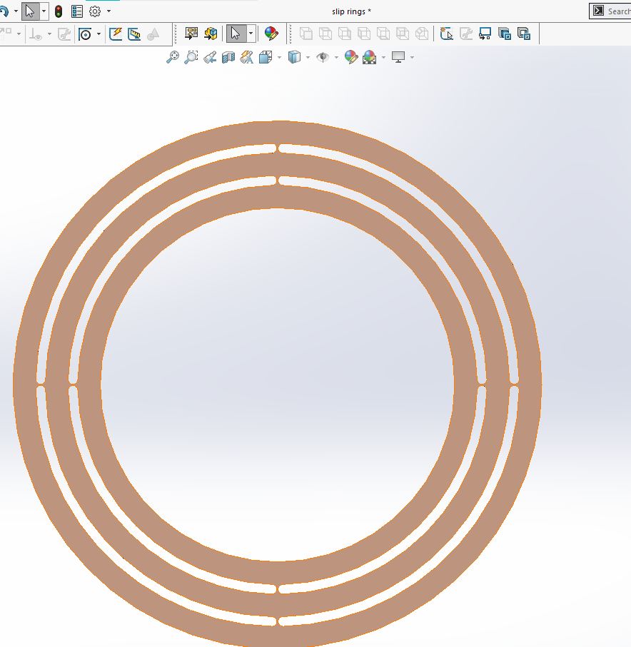

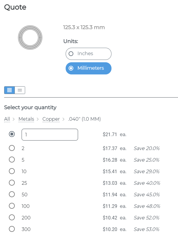

that is about as much as it cost to get a set from SB, I remember them going for $40 a set or something.
So I would only want to make my own if I could really make them signifigantly stronger like making the outside be metal with a plastic part insulating the copper.
good thing I was moving forward with SBX wheels as my first choice, then maybe colsons but idk.

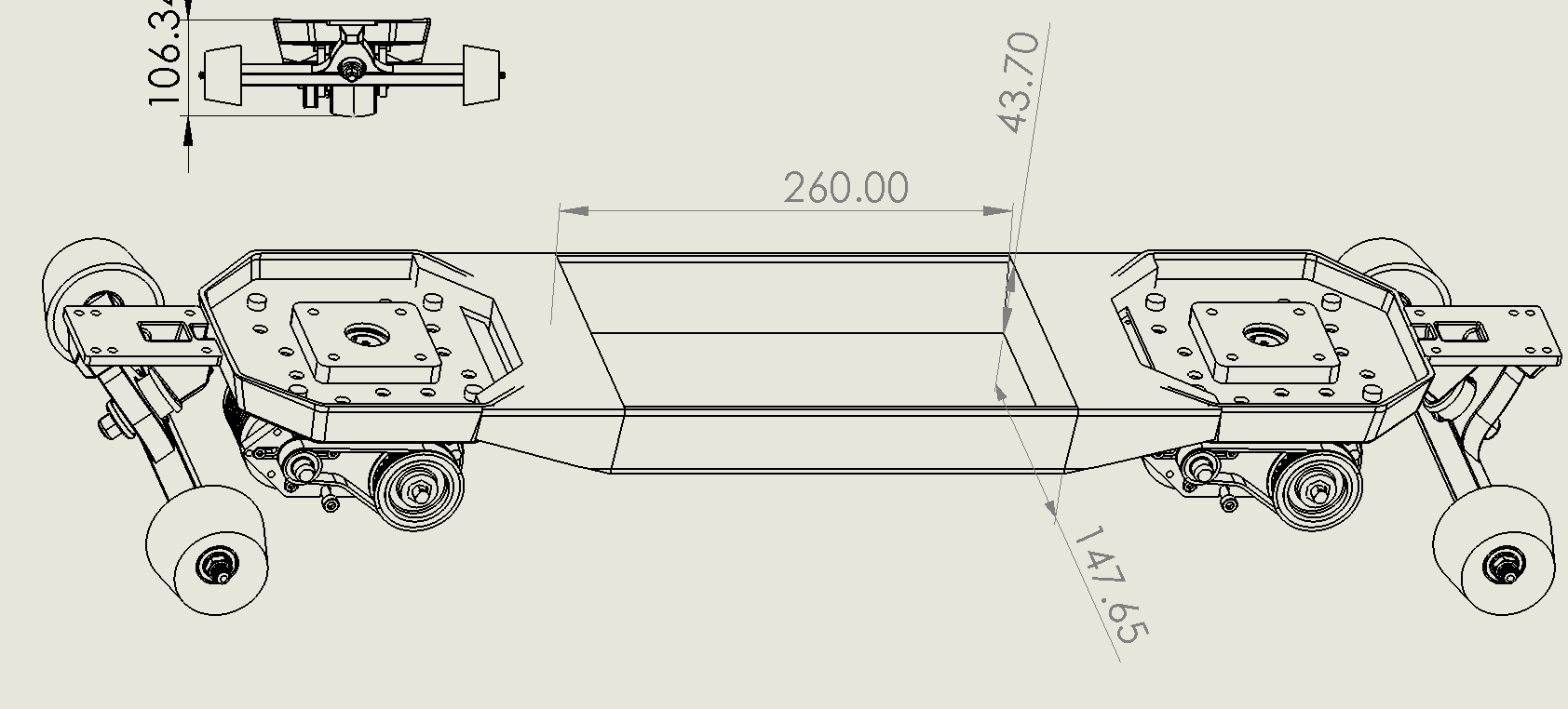

Leiftech battery dimensions

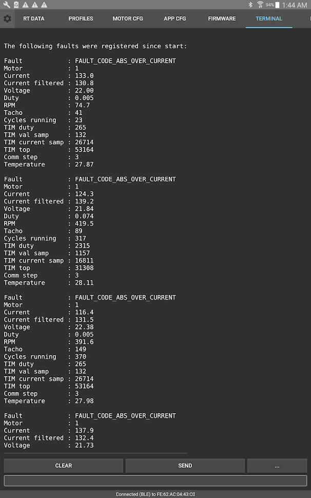

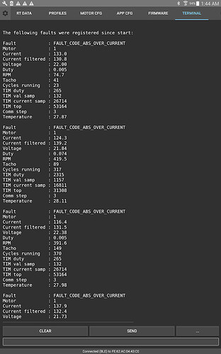

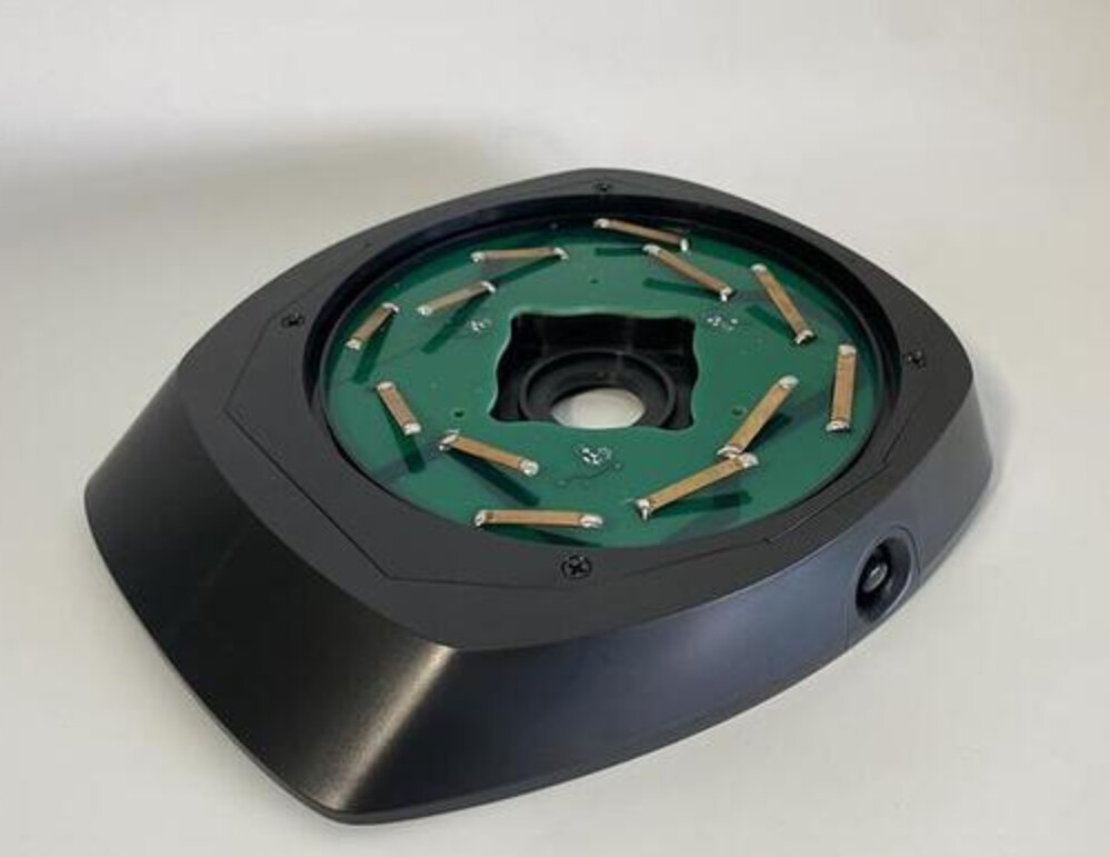

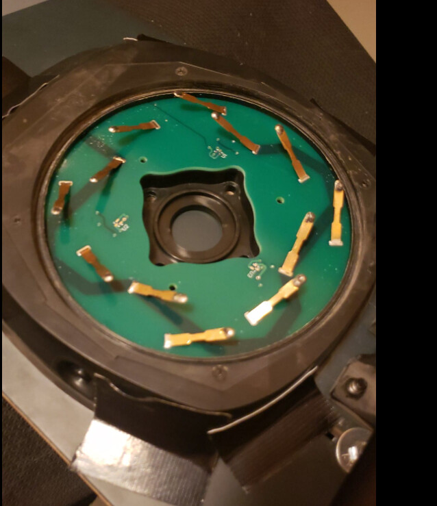

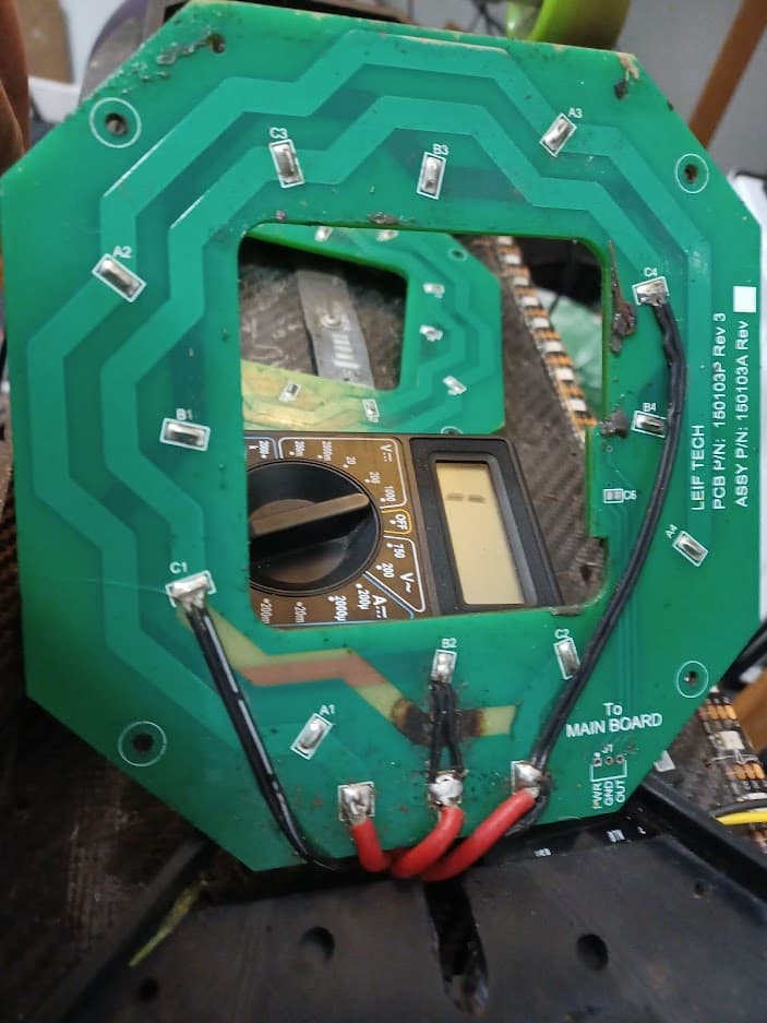

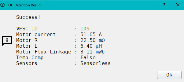

Now one does not want to detect, flux linkage detection failed it refuses to spin up. I manually copied over the detection results from the good side and it has trouble starting up usually going the wrong direction, then when riding this can be sudden brakes. To be clear this is after cleaning and checking brush heights.
Gives ABS errors as such when riding, mostly ridable despite that though.
First thing I will try is adding lots more grease and swapping the modules slip ring/motor pair on the brush bases.
issue fixed
yeah I totally forgot about that happening before…
Also after I fixed it this time I realized I can run these jumper wires on the top side of the PCB instead. Not a hard fix I should see how it does.

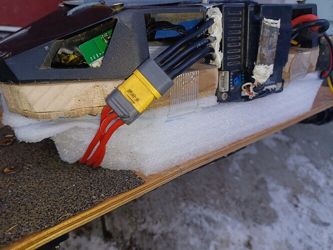

This is my attempt at a better gasket for the top case to give enough room for batt packs and the Discs. The small gasket was not enough so I went ahead and did a huge one that can also allow higher voltage.

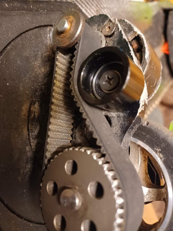

Took me a very long time to go from thinking of using the BN idler to actually trying to fit it on. First time it was too tight because the motor would not slide back but I got it to the right tension. The belt can be a bit warm compared to without the idler after a few mi so life may be reduced some but stretching and skipping issues reduced.

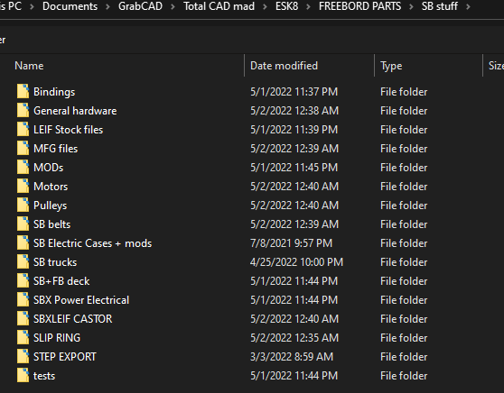

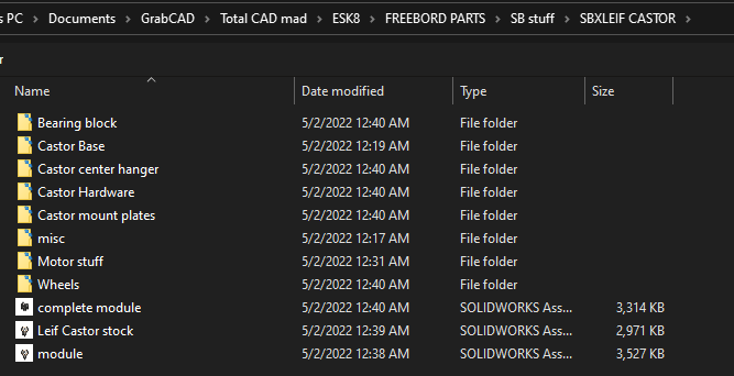

I have no idea why I got 3 different Castor module ASM in my files. Just pretend those make sense.
Should be:
SBX Stock
LEIF Stock
The MODs folder would have castors that have changes and all the custom parts that one would need to get.
