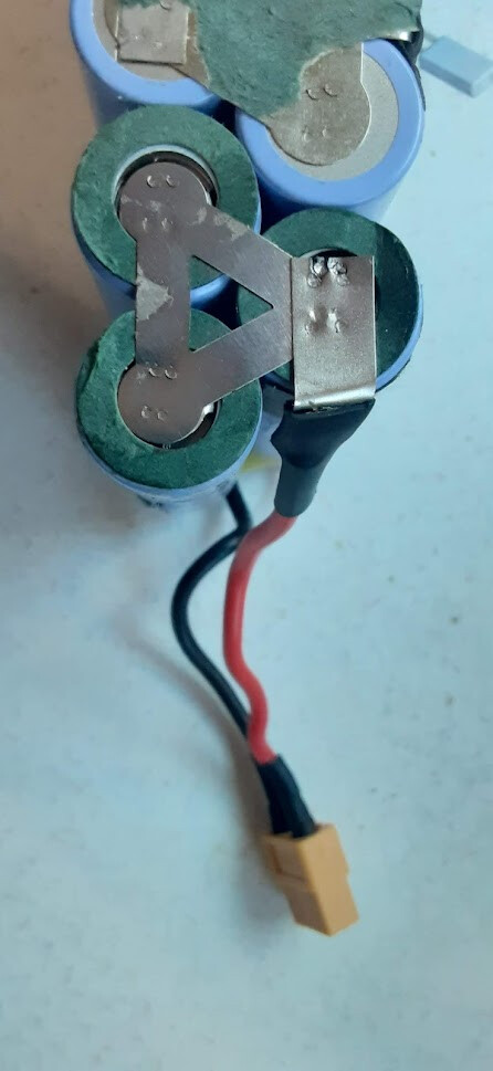

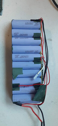

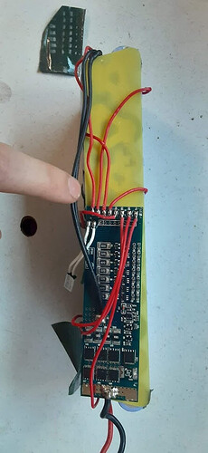

For anyone confused about the L3x leiftech battery.
each side is a 7S3P. if you combine two in parallel it is 7S6P, with degraded 2.2ah cells it might have 12Ah total. test it.
