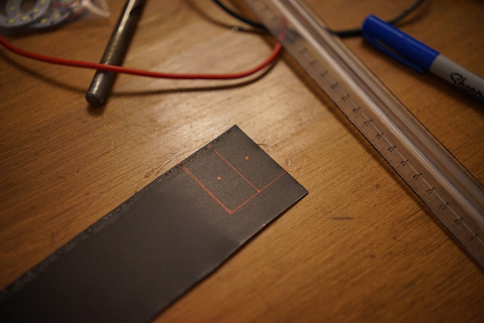

Step 1 – Measure and mark your cuts on the sheet metal
You want to mark the center point to drill, and a 40mm rectangle shape with the corners cut off that will attach to the lights.

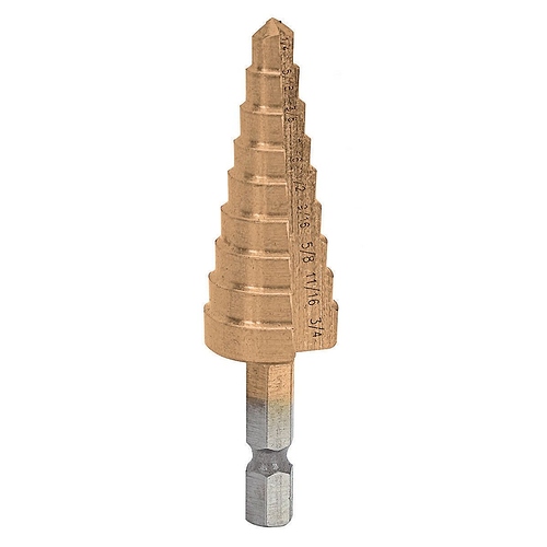

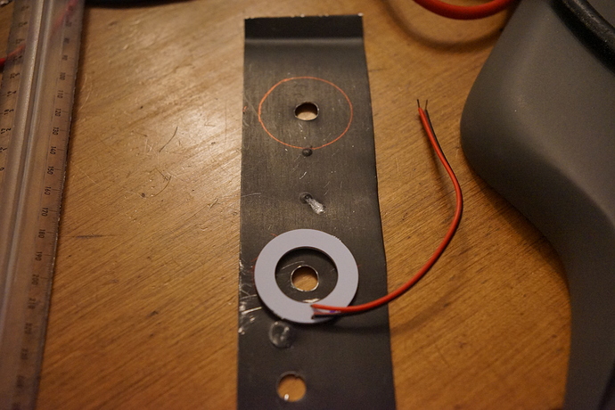

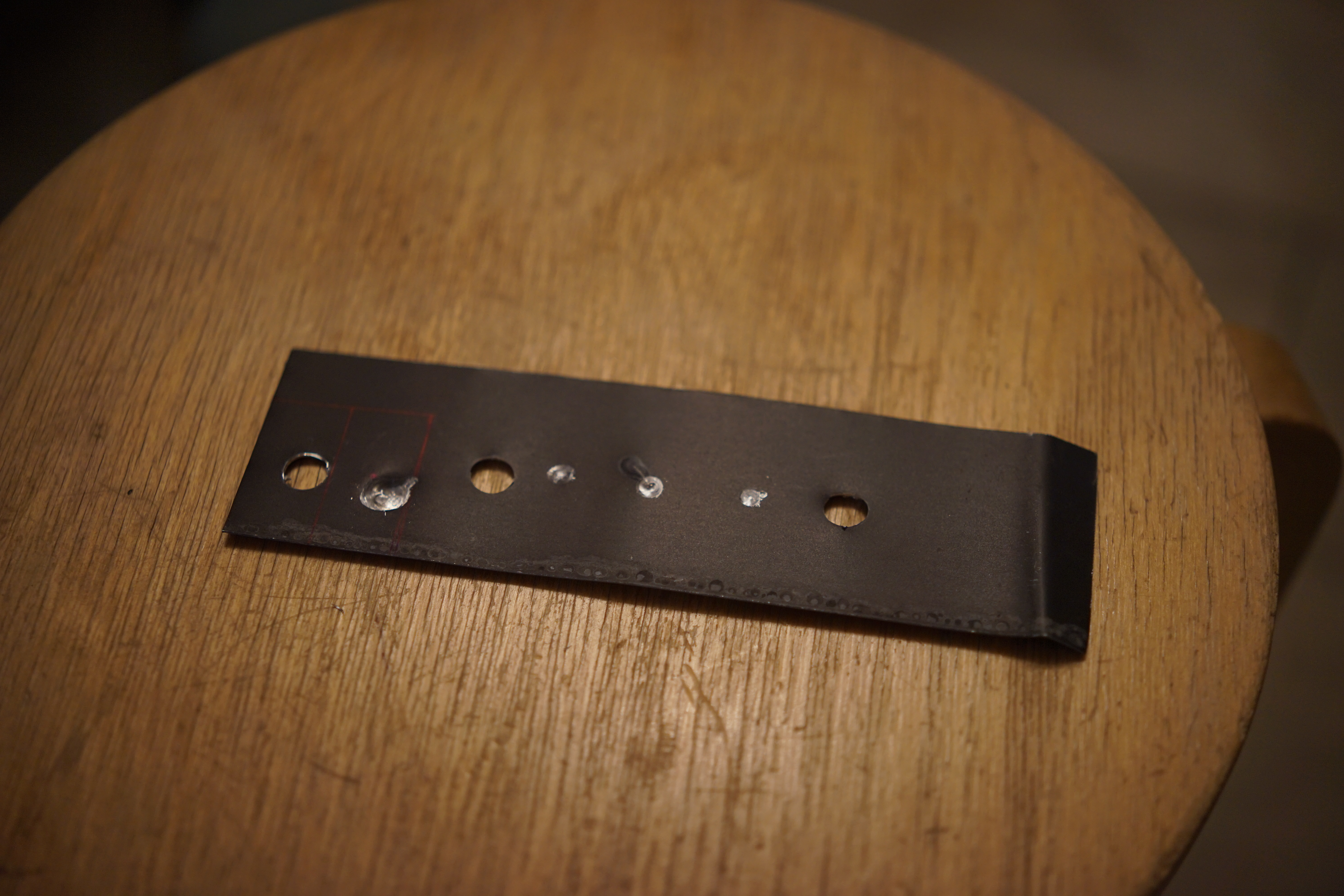

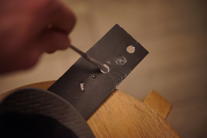

Step 2 – Attempt to drill through the sheet metal
You want a HARD surface against the metal so that it doesn’t bend, but gets drilled instead. My fuckup basically made step 1 pointless.
Step 3 – Fix your shitty holes with a file

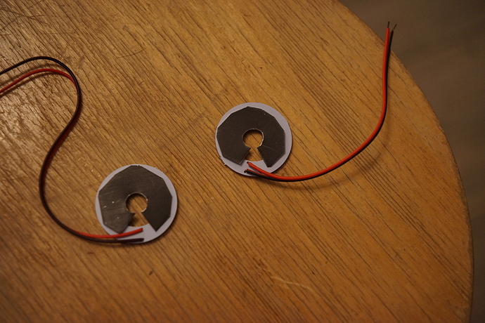

Step 4 – Retrace your cuts by just using the ring lights

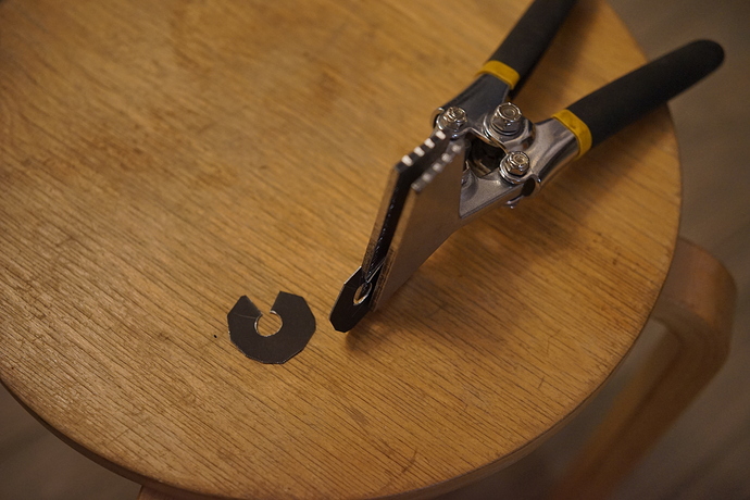

Step 5 – Cut out a perfect circle
After that cut off a bit to make space for your lights’ wires
Step 6 – Flatten out your pieces
I used a tool meant for it, but you can just use a meat hammer or ask your mom to sit on it.

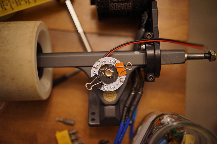

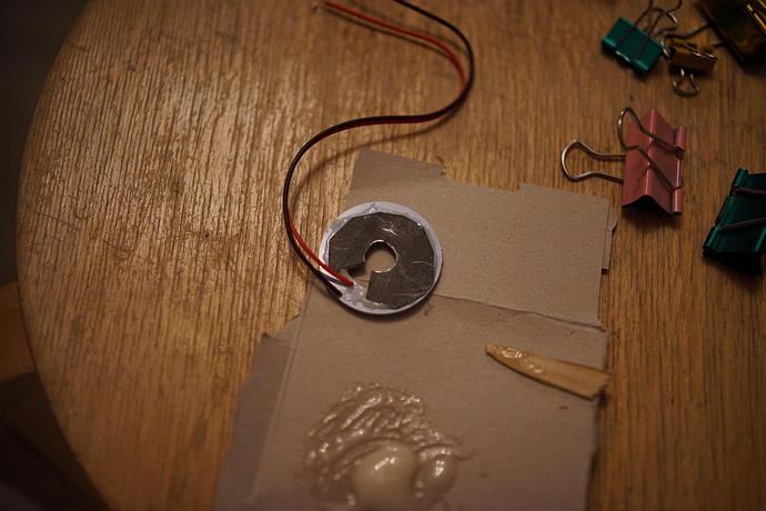

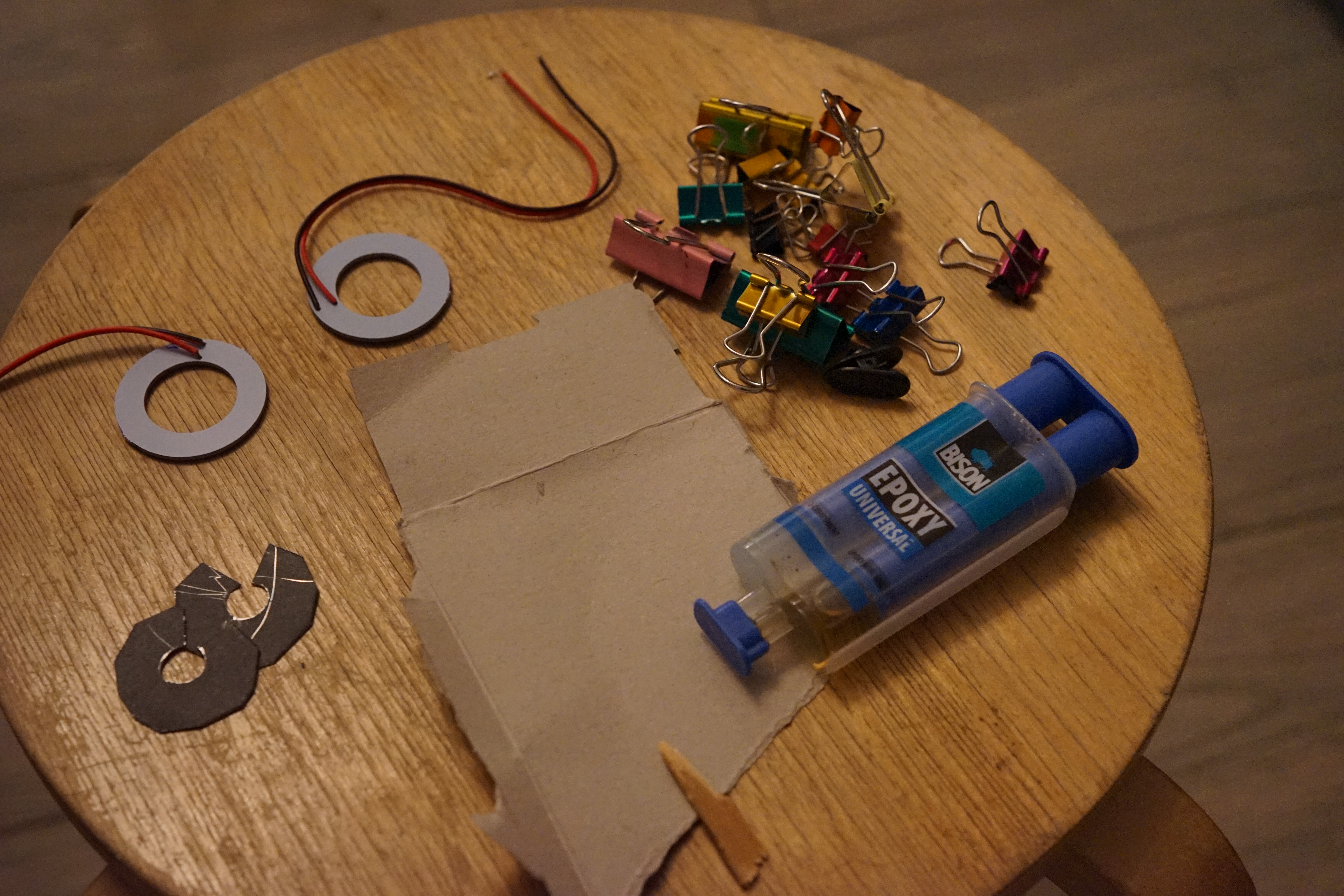

Step 7 – Glue the things
Mix up your epoxy equal parts or whatever’s written on the tube, apply it to the bottom of the ring lights, and then put your cut metal pieces on.
Then use metal clips to hold it down tight. To have the drilled hole be centered, I put the lights on my trucks, and adjusted it a bit until it looked right.
Step 8 – Let the epoxy harden

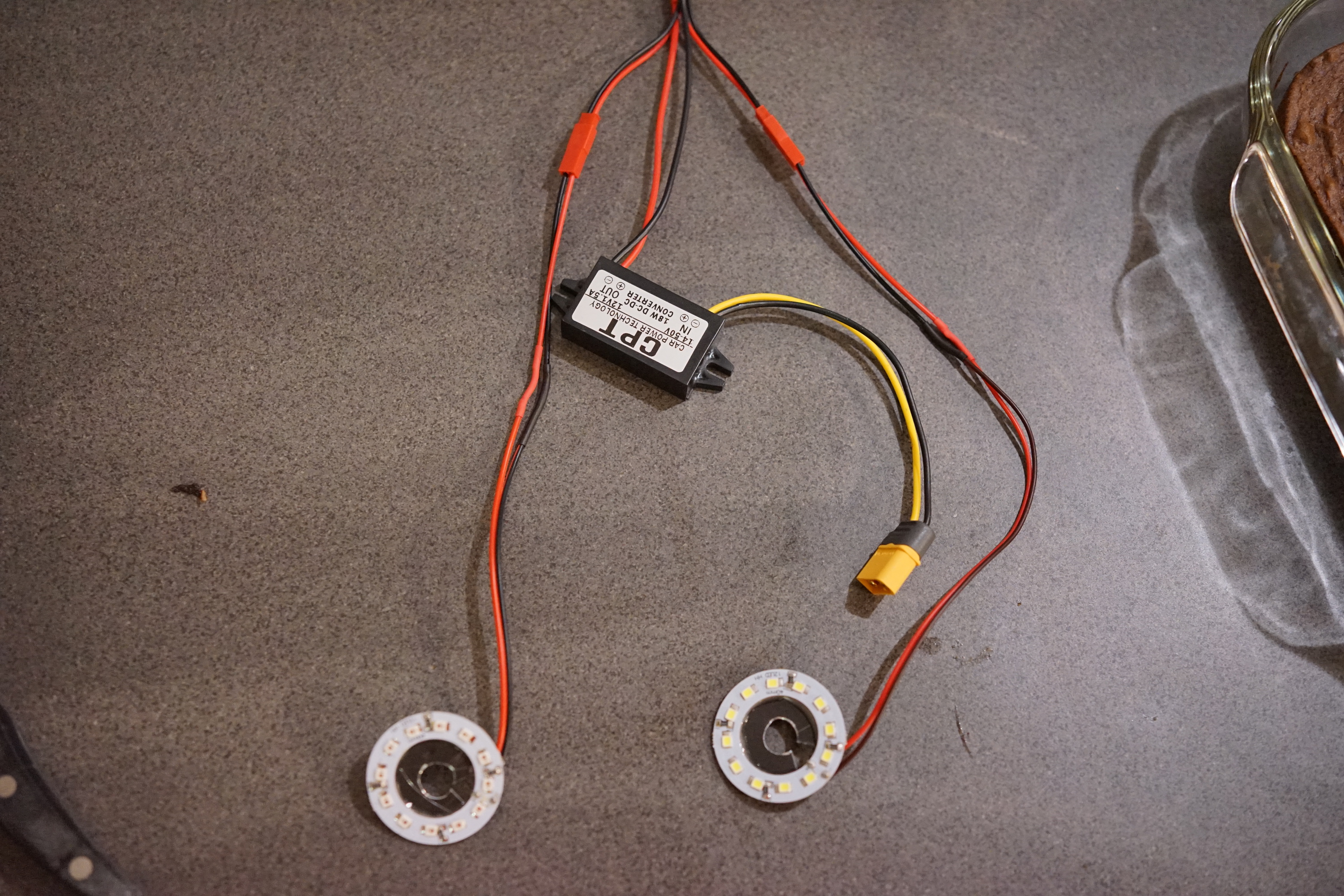

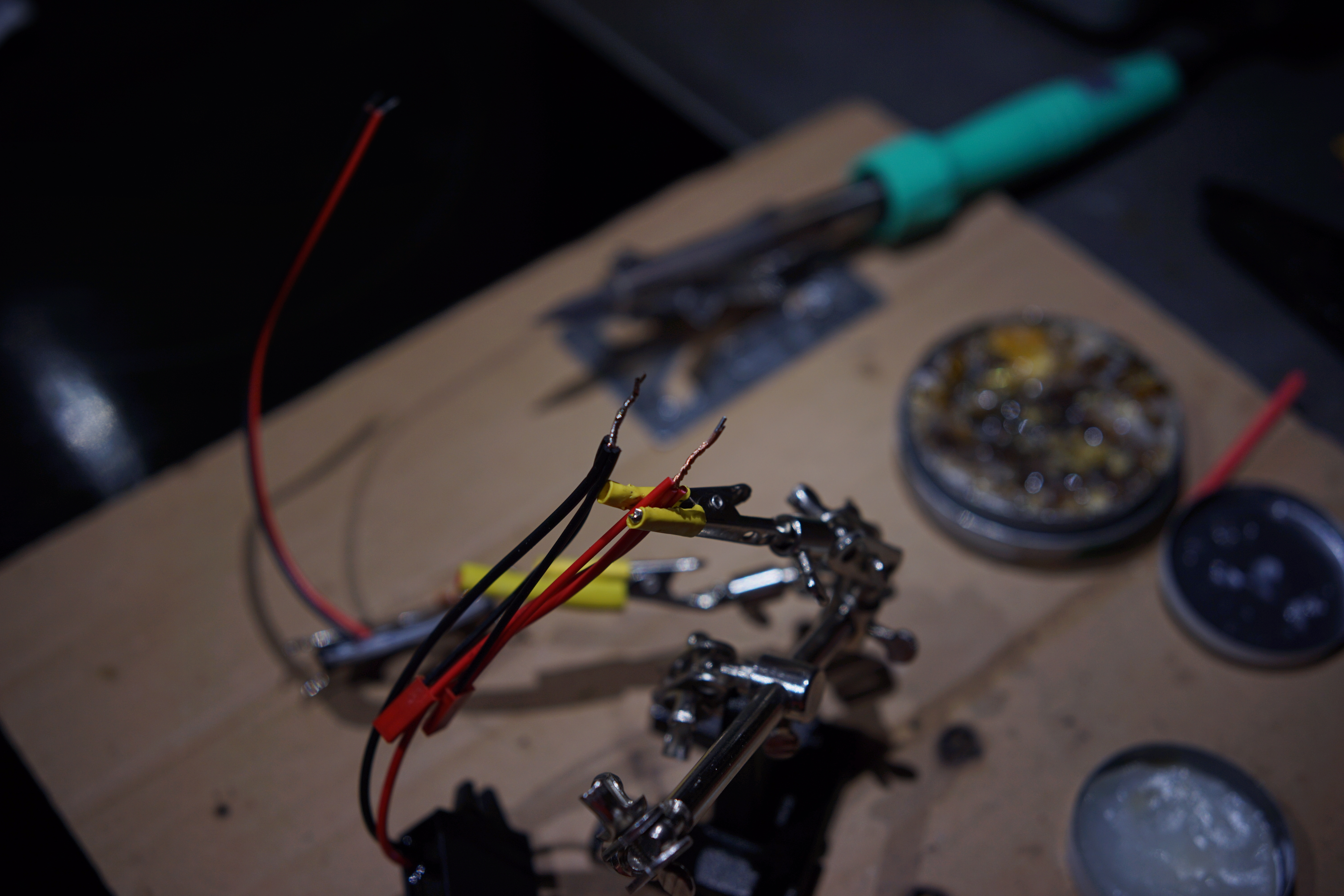

Step 9 – Solder connectors to the lights, and the converter box.
I used the pigtail approach to solder all the wires in parallel.

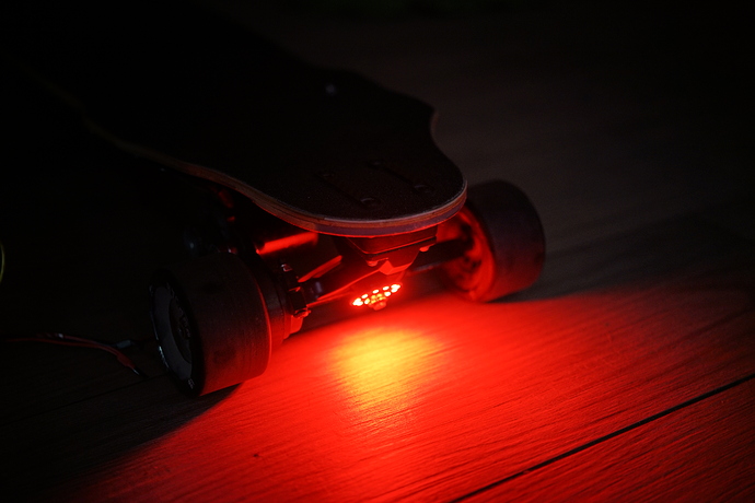

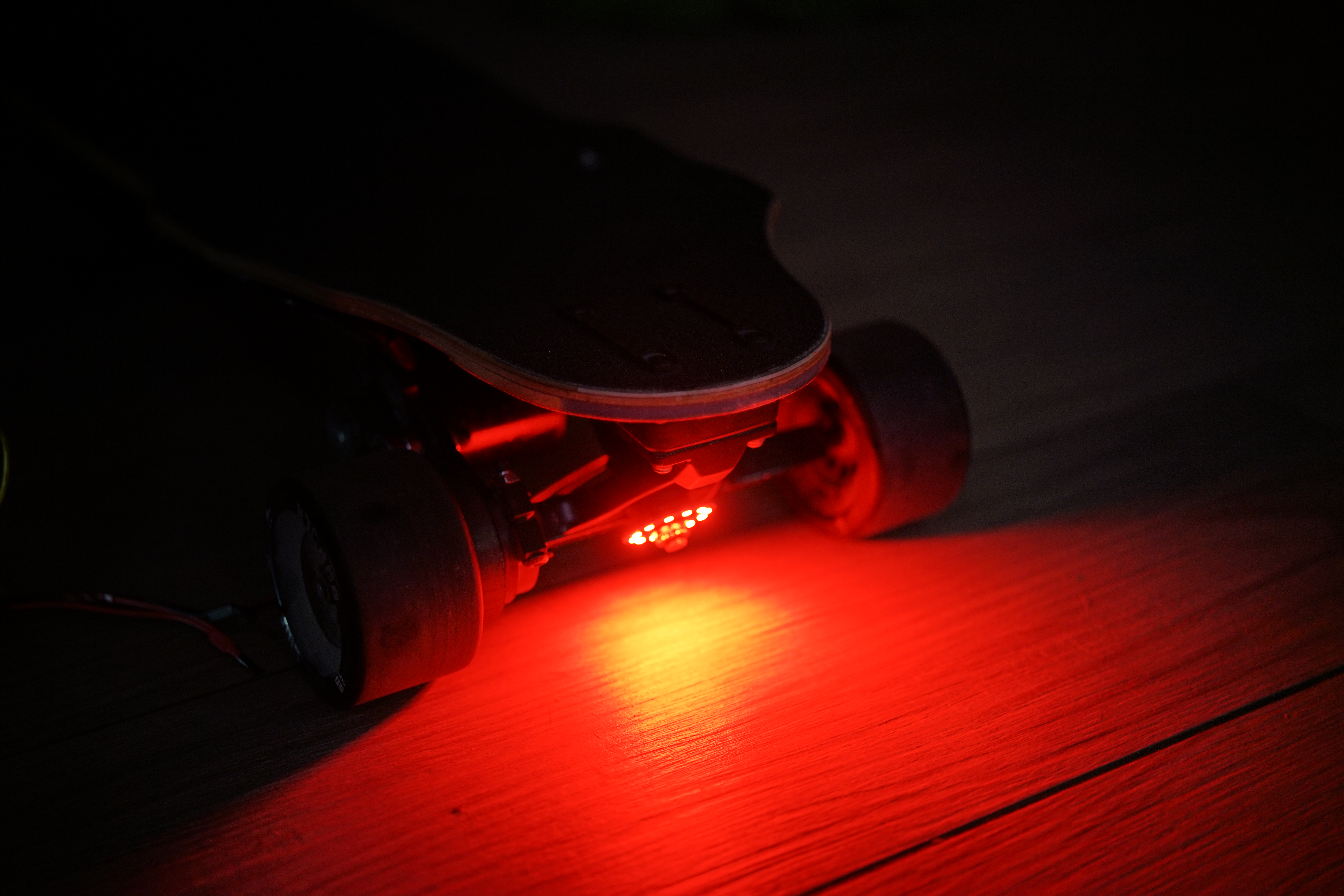

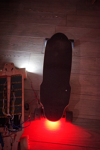

You might have to create an extension wire so that the front light reaches your box, wherever you put it in your board. The final thing should look like this:
I totally forgot to add fuses, which is very important because one of my converter boxes just exploded for no reason. You don’t want a short in your light wiring to kill your battery, so put in a fuse, god dammit!
Step 10 – assemble!
Take off the nut from your kingpin. Put on a washer. Put on the light. Put on another washer. Put on the nut. Tuck your wiring somehow so that it isn’t hanging loose.
Attach the step-down converter to your battery in parallel with your ESCs. It should be after your loop key or antispark. Enjoy!

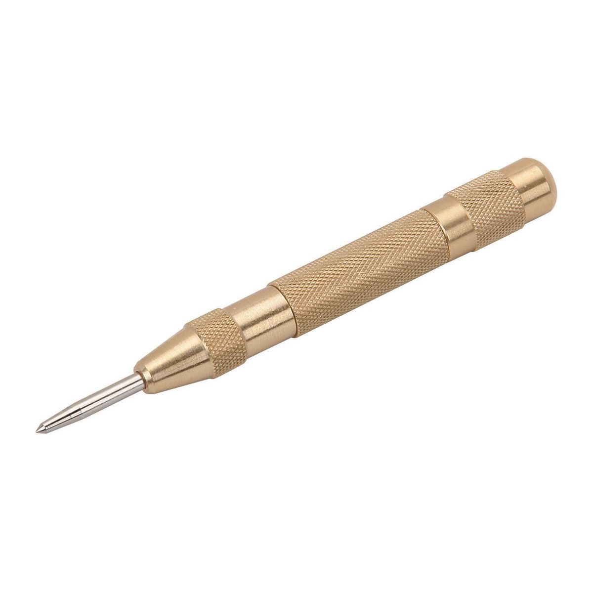

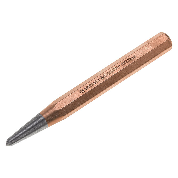

Countersink would be good for deburing the holes. Yeah, not everyone has the tools for that. And thx for the tutorial.:slight_smile:
that img is a centre punch.:slight_smile:
they’re dirt cheap.
I’ve hear it a million times, people calling a punch a counter sync. Maybe @Mainflow should cut @Mainflow a little slack :grin:
Why do they call a punch countersink? I’m confused. They are completely different.:joy:
it makes round holes, something not always common with drill bits…
spring-loaded center punch
now go do some good work
It happens. People thinking out loud, trying to figure out how to do a thing. I was just joking, it read like 1 person was correcting another person. I had to go check, then I laughed :grin:.
That’s the spirit of DIY. Use only the tools, who a person has in his drawer. And I know, when you are joking. A file is completely fine, but it takes longer to get the result. :slight_smile:
See now I call them scratch awls.
Different strokes for different folks.

This is awesome. But why cut sheet metal though? Wouldn’t using a large washer be easier?
because it is more complicated. hence why we build because we love making things more complicated than they should be.
It is the end product that matters, not how you struggled your ass off when you could have gone to the hardware store for 20 cents. :grin:
@Mikenopolis
If you can find a washer large enough, that would be amazing. It would cut down assembly time by half I think. Keep in mind you have to cut out a slit for the wires though.
