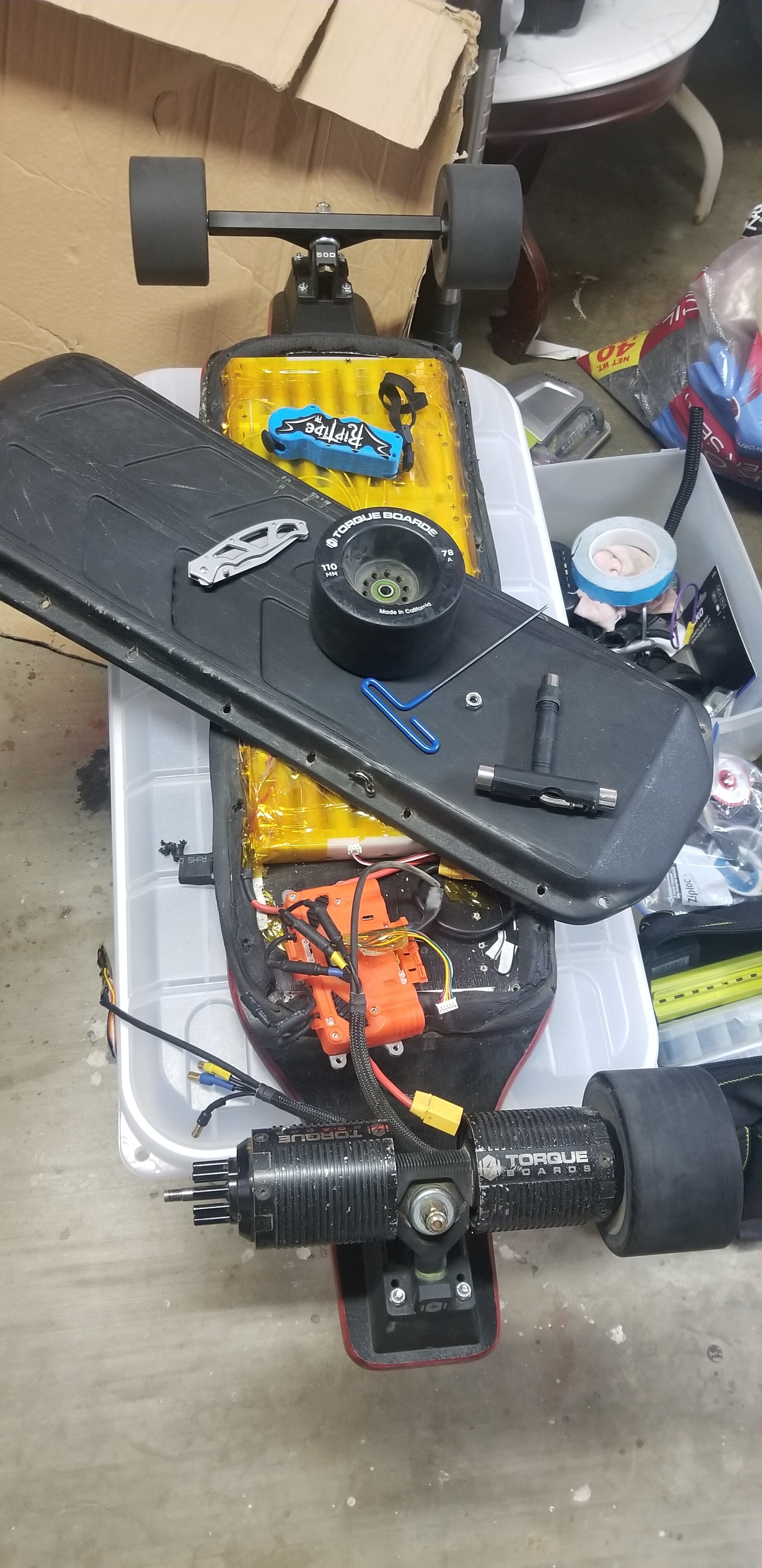

I put around 150 miles on my replacement set of 75kv drives. A couple days ago I went for a ride and became stranded when I got the wobbles, lost power and one of the motors made a nasty sound. At first I suspected my Unity had blown a DRV chip, but Metr showed no faults and everything on the PCB looks fine. Then I noticed that one of the drives was acting like it had a partially shorted phase wire. I cut the heat shrink and disconnected the phase wires on that side and hand tested the motor. I am still feeling that magnetic resistance and am pretty sure that I have a short on the windings or somewhere else inside the can. What next steps should I take? I have never opened these up and am not sure if I have the necessary tools to do so. What do you recommend @torqueboards?
You try swapping motors on escs see if the issue transfers. I’d also check the adapters and/or remove the motor and add some thermal tape if you haven’t already.

I tried swapping the motors and the problem followed the motor. The bad motor also caused issues running motor detection.
I added thin thermal tape before the first use and it worked well to remove any play. I removed and re-installed the drives on the hanger a bunch of times, the issue is in the can. It feels like a shorted phase wire but I checked all the external phase wires and they are good.
Are you talking about the sensor cable adapters or the wheel adapters?
I took a long hard look at my sensor cables and they are solid. I tried setting up sensor-less in VESC tool and still had the same problem. Now that I have access to the bit for removing the wheel adapters I will check that out.
Next up, I plan to test a known, good set of motors on the Enertion USA era Unity, I want to rule that out. I will keep you posted and will take it to PM to figure out the best course of action. I miss riding this board. When the direct drives are working they are delightful.

Definitely sounds like something is loose in there.
How hard is it to remove the axle mounting hardware from the motor?

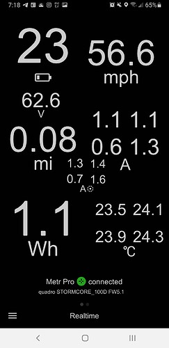

60kv on 155s unloaded at 20% charge lol
Wow. That’s within 1-2 mph of the official world record!
