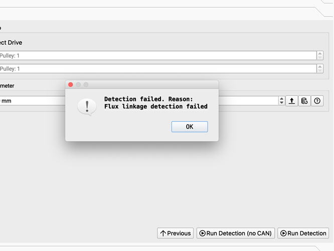

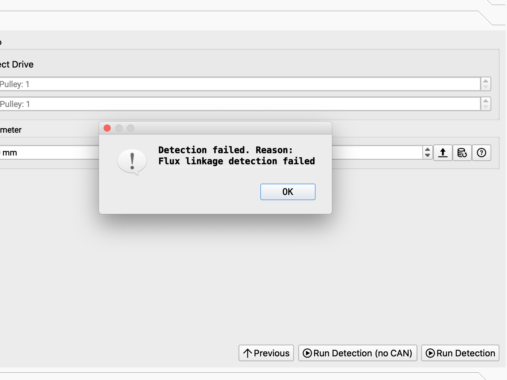

I just did a detection and got this issue, will try switching them
yep, switched the ESC connections for the motors and still the same result with the left motor and detection failure with same reason :frowning:

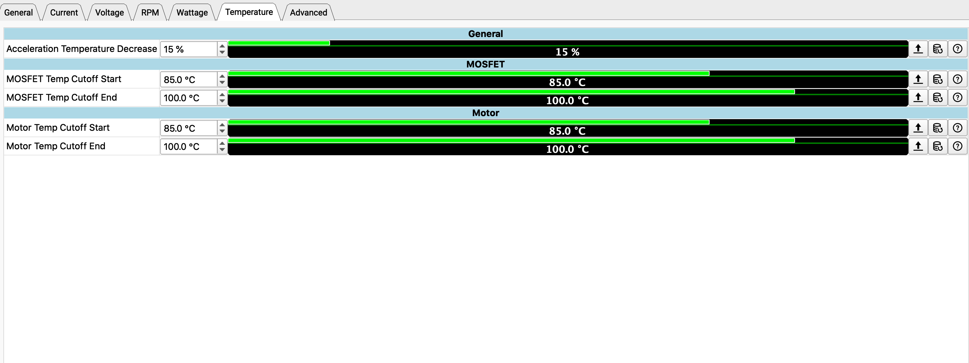

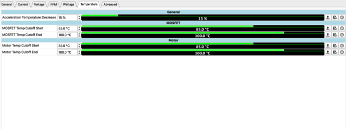

Sounds to me like it could be some windings shorted somehow. I overheated one of my motors doing a dumb experiment and it has the same symptoms, although not a gritty grind but electrical feeling grind. Were you running with sensors and thermal limits set in VESC tool and all thermals seem to read out fine?
If it’s a gritty grinding feeling, I wonder if a winding got snagged or ground down in the stator to the can somehow… :man_shrugging:
Yes, running with sensors and limits set, I set it up similar to my other direct drive board. Only on 1 motor it’s happening. Super annoying, it was my first real ride on them that I got <2 miles on. And I waited 2 months for them to arrive :upside_down_face:

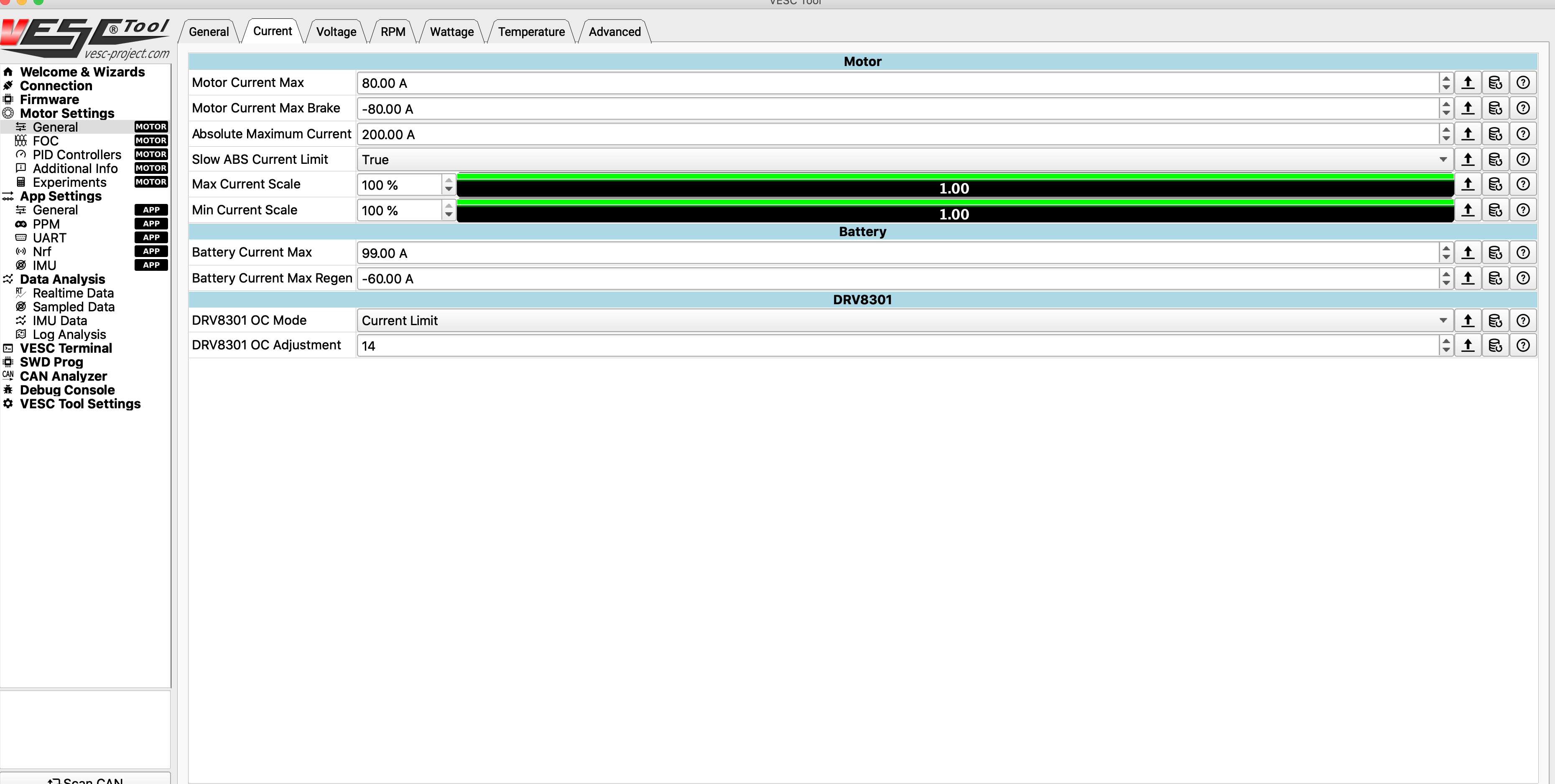

Would any of these settings blow up a motor?
Settings look fine.
