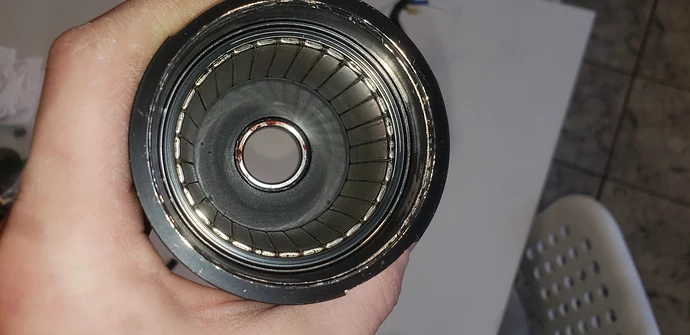

I got my loctite 660 in, did some teardown and documented. I’ll add and edit few more things but want to make sure these videos work. Not sure if anyone cares about the application video but just paint the loctite onto bearing outside and can inside then reasemble.
Obviously you need to remove the circlip BEFORE attempting this
Also
*** WARNING: YOU MIGHT SHATTER YOUR BALL BEARINGS OR DIMPLE THE RACES ***
I personally have never had that issue though but it depends how much you need to hulksmash it. You may need to replace your bearings after this. Try and think about what forces might hit these bearings sideways when you’re carving on the road though at 30kmh.
Here I couldn’t get it lined up with the small outer bearing but it popped into place with the vice without too much force. Also when doing the final press you want to hold the inner race edge of the bearing so the axle going through doesn’t hit the vice.(last few sec)
Heres some pictures

Things I used:
Vice that opens past 62mm
Socket with diameter of close to 20mm and as square a face as you can find to prevent marring the stator
Hammer
Bearing puller
Piece of ⅛” thick aluminum
The procedure I used to replace the big bearing:
  1. Open the vice jaws to exactly the inner diameter of the rotor (just over 62mm), and set the motor with wires facing downwards on top of the vice jaws.
  2. Place the socket on top of the stator so that it sits inside the inner race of the small bearing. Note the position of the stator in relation to the bearing.
  3. Hammer the socket through the middle of the small bearing until the stator comes out.
  4. Remove the stator from the rotor. This will take a fair amount of force due to the magnets.
  5. With the stator removed, use the bearing puller and piece of aluminum as a brace to pull the big bearing. This could also be done with the vice and hammer if you don’t mind destroying the outer race of the big bearing.
  6. Optionally, cook the new bearing in the oven at 250°F for a while to make it expand. If you’re lucky, it’ll fall into place. I was not lucky.
  7. Adjust the vice so that the jaws are just over 40mm apart, the inner diameter of the big bearing. Place the stator wires down on top of the bearing on the vice.
  8. Hammer the stator until the bearing is fully seated.
  9. Reinsert the stator into the rotor without pinching your fingers. Place the motor on top of the vice, wires facing up.
  10. Hammer the stator into the rotor until the stator and small bearing are at their original positions.
Side effects were slight marring of the casing and creating a lip on the stator so that the motor wouldn’t fully seat on the axle. I fixed this with a razor blade. Potential side effects include dimpling the races of the original bearings, but if you’ve gotten this far, you’ll probably be fine.
I’m likely gonna have to do this again to replace the small bearing on my motor because it’s starting to squeal. I suspect I didn’t regrease it well enough. When that happens, I’ll add pictures of most of the steps here.
Not sure of others experiences but on my motors, there’s absolutely no reason to have the circlip on there. There’s no way I could’ve hammered the stator out while the rotor was in my hand. It took some full force hits while on top of the vice before the stator even budged.
