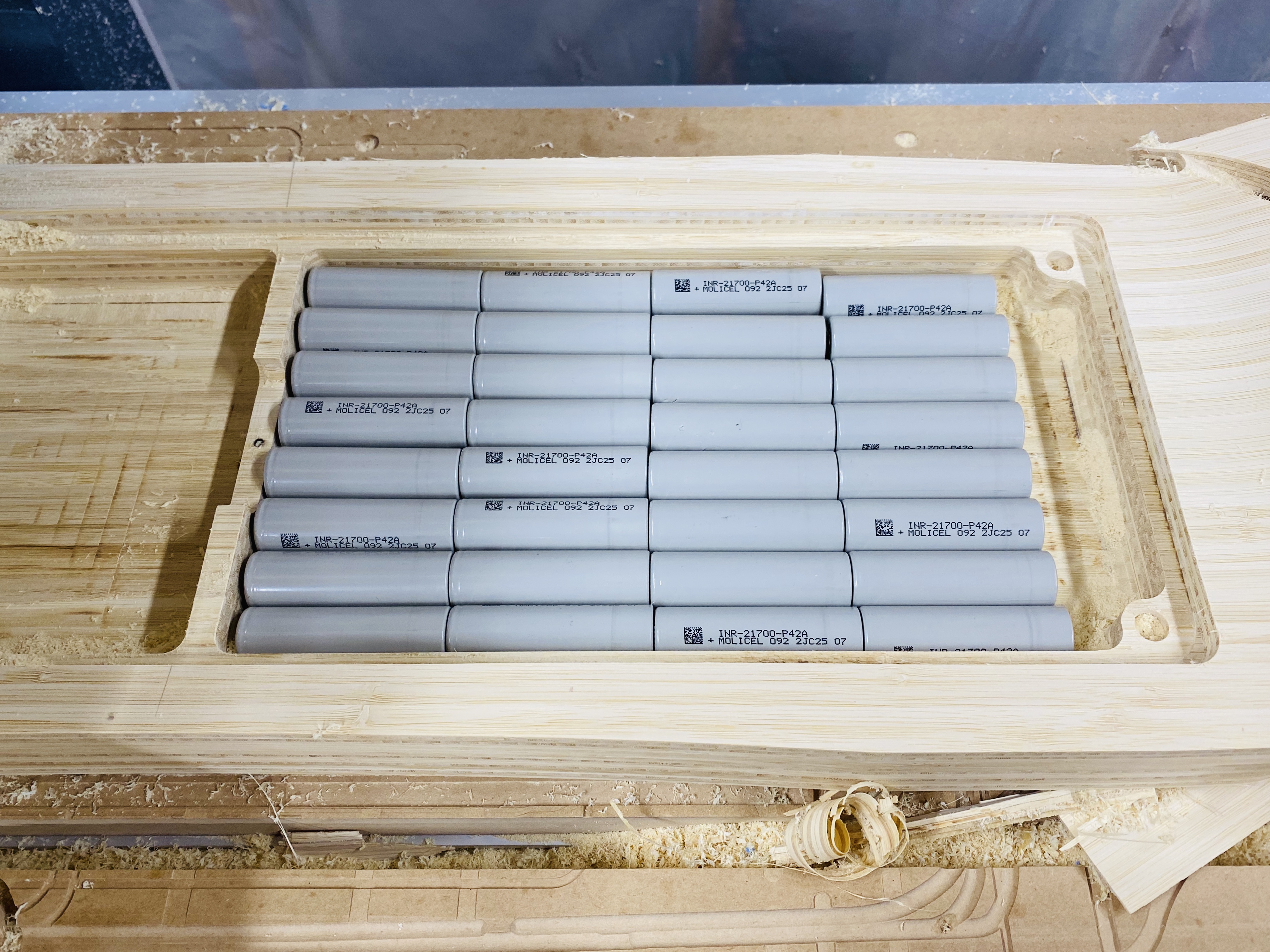

Man these are beautiful!! if anyone wants a custom pack, if i may speak for @ZachTetra its probbaly best to ship us the decks, the cutouts require very specific battery construction, and need to be fitted to the deck.
Yes and no, the new decks have a bigger cut out and should readily accept a 12s2p 21700 block but the wire management is a little weirder (needs different slots in the bulk head)
However by sending the battery in the enclosure it is much more secure as the deck holds the battery in place and protects from moisture and abuse
This is my example of what it looks like, most of these are ideal for an XXs2p 21700 or XXs3p 18650
Shameless plugs!
I’ve got them standardized now. Three sizes. If you ever need to see one of the compartments mocked up with some cells, I can put together pics for you :wink: I’ll even make origami ESCs and BMSs so you can see how it all fits together :stuck_out_tongue_winking_eye:
The new Pale-horse and long-AT compartments can hold 16s4p 21700 if you put the BMS and ESC in an external box, and a cozy 13s4p 21700 with everything inside.
