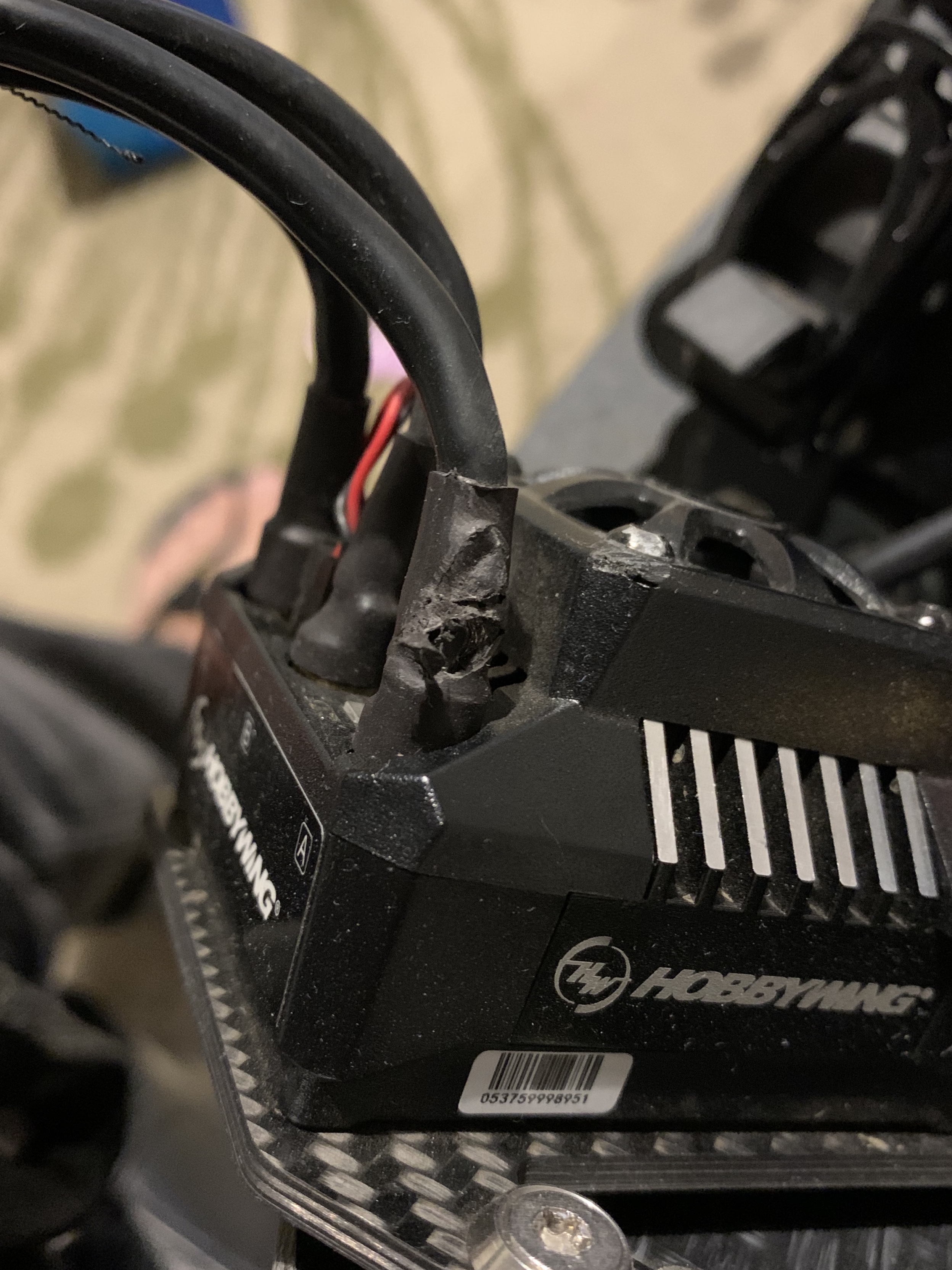

Some battle scars from my fall. Truly weird damage, would love to know how it all went down.
On the plus side the 8S ESCs still work, and that with my unfinished 10S LiFePO4 battery pack too!

Started stripping the board and repairing damage. My soldering skills seem to have been lacking before, thanks again to the forum for helpful tips read here and there about pre-tinning and pouring in the heat and solder on big connections I’ve improved.
The first two photos are before & after shots, then some more cable repairs before PVC wrapping them. I probably need to get a heat gun for shrinking PVC at some point, as I’m a little apprehensive about using a hairdryer for some reason.

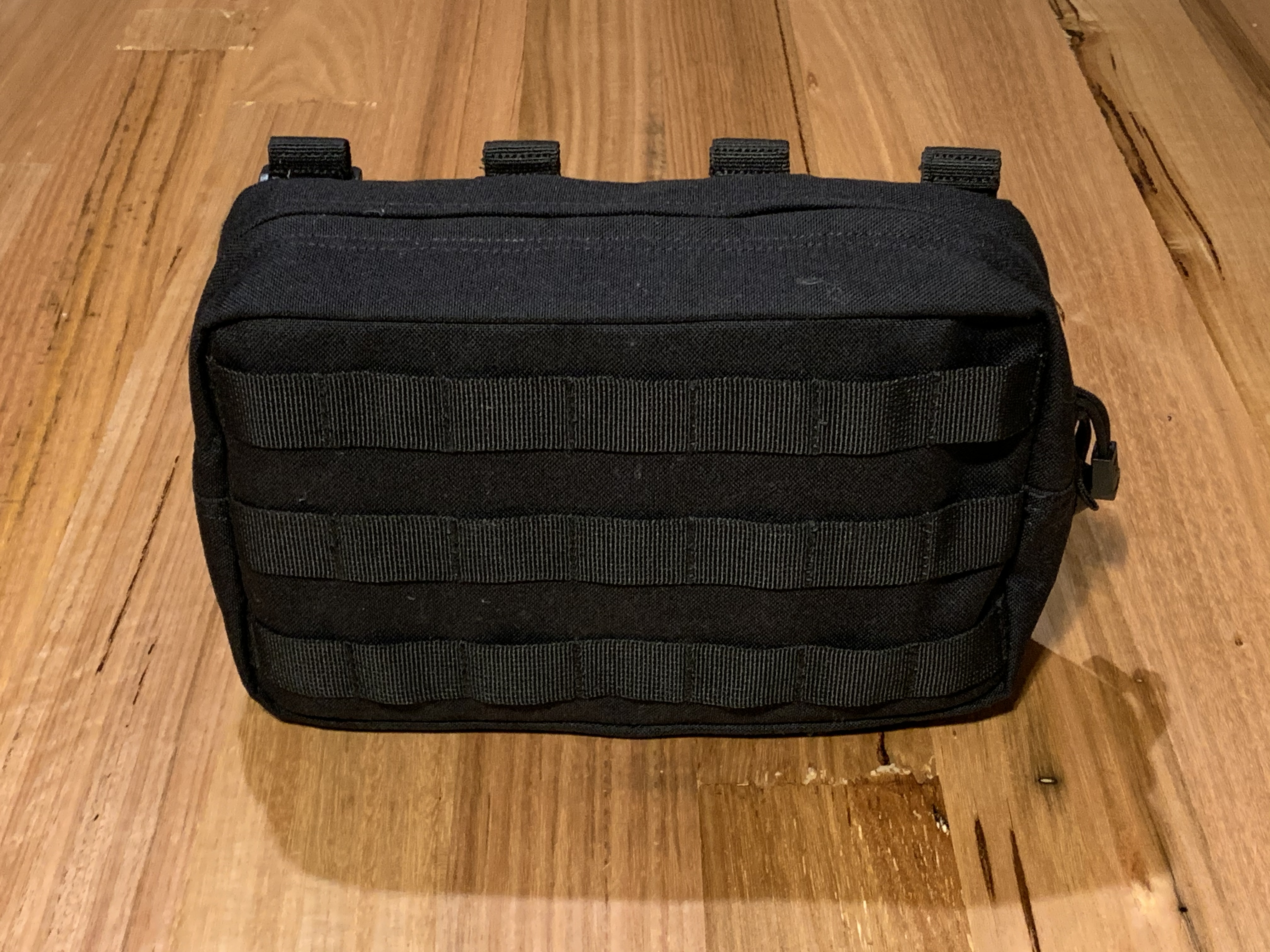

This is the final electrical setup for now. I did a test ride last night, and on the board there’s no negatives being tethered to it.
Next I need to make a protective material cover for it, and make it easy to remove for days that I’m not esk8ing, so no zip ties.
