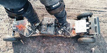

my setup is dual 6374, 192kv (waiting for new 149kv to change)
~215 pneumatic (little flat at 1.5bar, I like it smooth :sunglasses: )
16t/72t
and since i got 2x lipo from other build I finally choose to go with additional 2x8ah 5s lipo

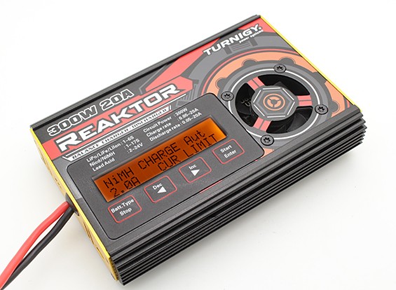

with this charger and pararell board to chagre it faster. (for 1c charging (only need to do it twice) i set 16a when both plugged) and only to 4.150v/cell
Barely feel the voltage sag (enough that it started to be a problem lol, cause I dont feel when it start cutoff at 36v)
The old ones (after 1kkm) are good enough to be almost the same as the new ones. They not even warm after ride in woods (but a little puffed cause i wet them once :man_facepalming: )
Average 16wh/km
~18km range with 8ah (36v/32v cutoff)

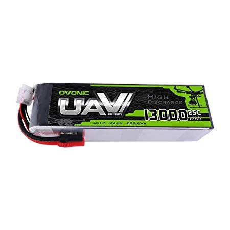

maybe this will help
This is a pretty good deal. Ovonic have a decent reputation.
2x series for 575wh and discharge for days
$200 + $40 for a BT bms and just grab a cheapo 2a charger for now. $250 dollars and this will shit on any 600 dollar li-ion pack
