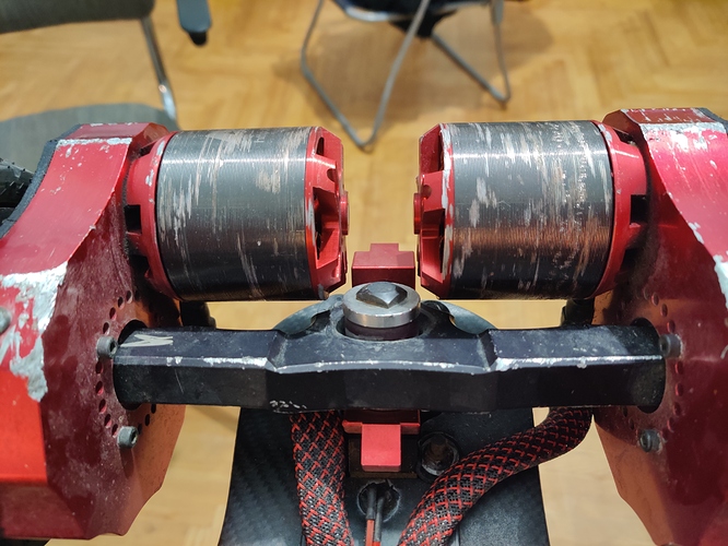

Well I would too :smiley: this clearance doesn’t make sense if you don’t see it up close.
Fun didn’t last long…
Looks like something isn’t happy.

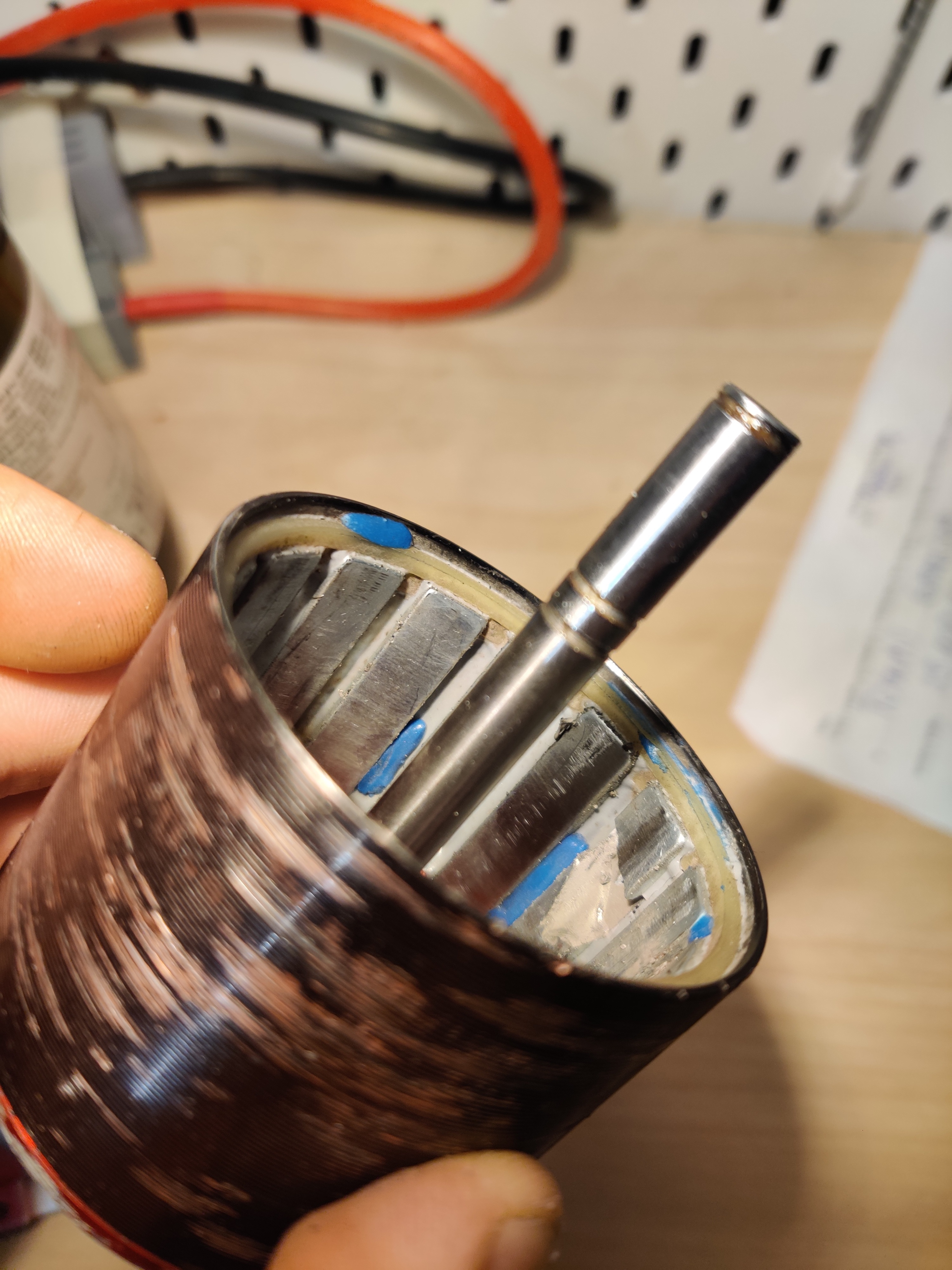

That sounds like a dislodged magnet or something got in that can.
Are you able to take the motor apart?
Maybe clearance was an issue after all!

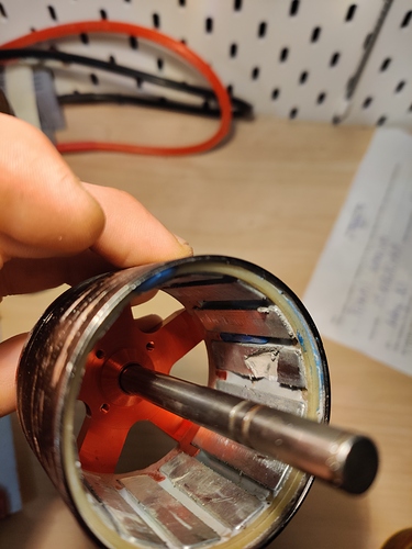

I’m 100% certain it is the magnet, motor hited the edge of a small sidewalk, so…will be taking apart back end later today and ask for some help from you guys…
I would recommend longer trucks so the motors clear the baseplate, or get 6355s. Ground clearance is everything, unless you dont mind scrapes upon every slope incline or if your motors are battle hardened
And we have a winner. I got fairly sad after opening the motors and seeing they’re actually well made from the inside.
