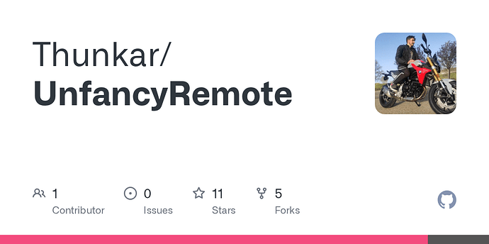

 - DIY friendly and modular. There are a ton of DIY remotes available (specially in the older forum), and most of them failed because in my opinion they weren’t easy to build. My hope is to have a comprehensive Github repo and do things at least 10% as well as @shaman does with his open projects!
