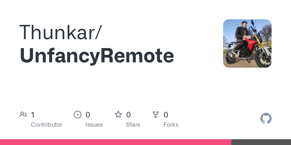

I have started the repo, but:
  • I only pushed what I have because I don’t want to fall in the “I’ll publish it when it’s awesome/perfect/I’m happy with it” trap.
  • The code is nowhere near production quality (basically examples from the library with minor modifications), and the cad files are JUST TO VALIDATE IDEAS.
In short: DO NOT ATTEMPT TO USE AS AN ACTUAL REMOTE YET
