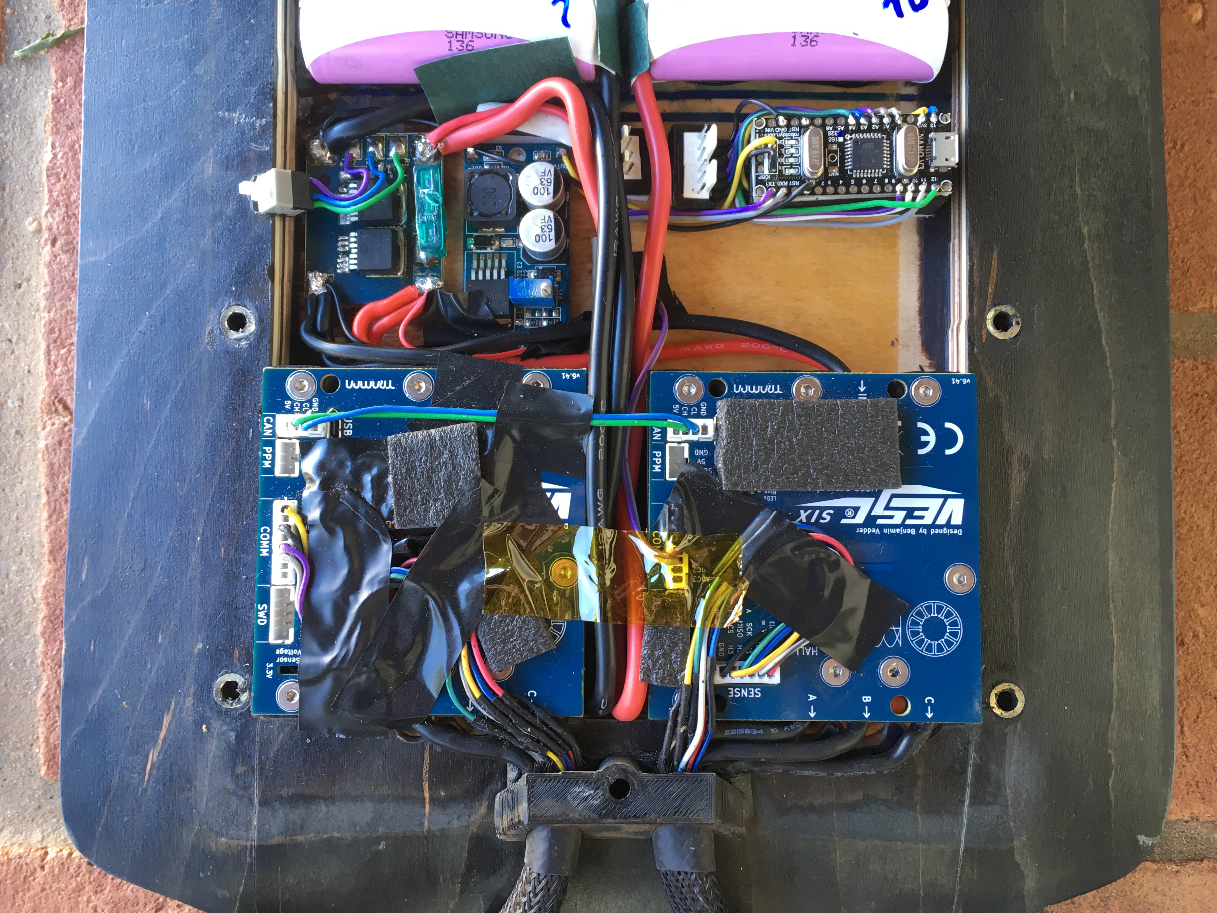

Some internal pictures before I change everything

Like a glove
Everything cleared up, so much room for activities, just need to buy a 100 A fuse and probably a JST 3 pin for the PPM input
