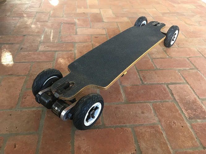

Certainly the roads I ride put a lot of strain on in, big cracks, expansion joints, ridiculously bad roads and all
I just remembered now that when I lost brakes in a hill and bailed the board flipped on the side of the road, nothing extreme, but could have been the start, I will look in some photos to see if I can spot when the cracks started
Stop using it ASAP, and skin the deck with carbon fiber, bottom and top, 2 layers on bottom and 1 layer on top. Then put all the guts back in and rebuild it.

I will keep it and probably do that in the future, other idea I had is to make some aluminum reinforcements on all 4 corners, maybe on top of the carbon fiber
My fear of laminating is that it will not adhere well, the outer bottom layer appears to be more cosmetic and less dense than the rest

Small update on the crack problem, superglued all of them, they held so well that on the rear left another crack developed instead of the glue cracking open :rofl:
Superglued again and it’s fine for now, but yeah, this deck is definitely done, it’s a matter of time until it crack again, I’m not seriously riding it, just doing the tests for the next build

First ride with the 6.5” Urban Treads. It’s hard to say what I think, I can put it this way, if I can only have one board, for sure it won’t be with tires, the feeling I got is that you are disconnected from the road, sure, it handles bad roads like the holes and crack aren’t there, roads I had to go slow even with the Gummies it doesn’t give a fuck
What hurt my brain it’s the consumption, the same I was getting with the Gummies, what the hell, dure, I was going a bit slower until I get used to it, but this ride had a significant amount ride on tall-ish grass and loose sand, and resulted in 11.4 Wh/km
The truth is at the most fun to ride with the Kegels
One personal but important point for me, it has to look good, and the narrow trucks with big wheels doesn’t cut
But a bit point, lack of wheel noise, I can only hear the motors and belts, the rest is dead quiet, this make me want to build the direct drive mountainboard even sooner for stealth forest cruising
I’m ditching the tires, got a flat in the middle of nowhere in a place I rode a lot with the Gummies without worrying

Ride a couple of times before judging. I didn’t fully enjoy my first rides, too because of the reason you mentioned. You are right that the feeling with pneumatics is imprecise compared to thane. With thane you have a very direct feeling and are connected to the road which gets lost with pneumatics.
But this feeling changed after a couple of rides and I won’t switch back to Gummies even when the look is much better imo. My commute to work is 30 minutes with Gummies and 23 minutes with pneumatics on the same track. This is because I don’t have to worry about anything and keep on riding instead of stop and go.
Ok, the decreased range (-33%) sucks, no doubt.
Welcome to the club :wink:.
It seems the Trampa tires are very thin when you get flats that early. Fill in the green slime and forget about punctures. Even when you already have a flat you can insert the slime, spin it, inflate it and you are ready to ride again, this works for punctures up to 3mm, easy. Today I had my second puncture with Evolve tires (without slime) but only because the tread is almost gone. I was riding for months without any flat.
@Saturn_Corp @spei will get some tomorrow definitely, and the protection tape when I’m in the mood to disassemble the wheels
@rich today I was way more confident with them, ridding almost normally, the main issue is that I got overlapped effects of getting used to the GT2b and the tires, this after my board loosing brakes all the time and not recovering from the previous remote, so the confidence level is low
I pumped the tires as much as I could with my small hand pump, definitely improved things, I have no idea how much that is, the gas station air couldn’t handle a tire this small, what pressure you run? And glad to hear that you can put slime in a already punctured tire
And talking about efficiency, another ride, and again the consumption is the same as the Gummies, 10.8 Wh/km
This ride I took it to some bad streets, not they have cracks or holes, just that they are really rough, but they handled really well, no need to slow down, Gummies I had to go at least 1/3 slower, and Kegels 2/3
