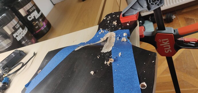

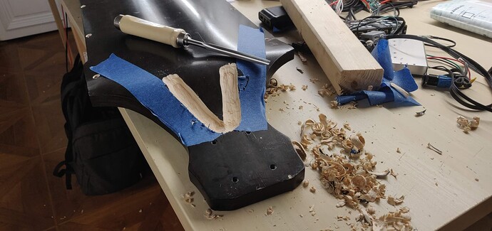

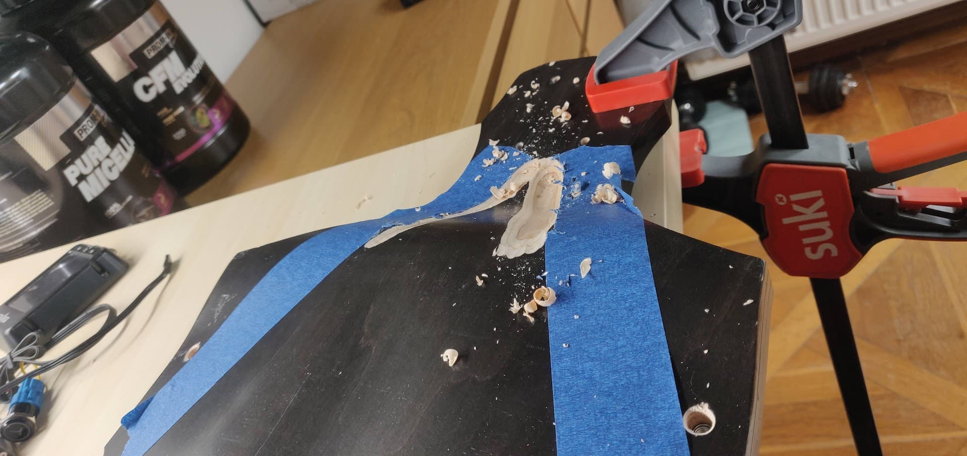

added stops for the battery, and switched from metroboard to trampa 8", now I really need to get the chisels for routing of cables under the deck
thanks dani for the simulation. seems though you’re not considering the walls between the deck and the tray? (video under last post).
btw, what are the units on the scale? the maximum in the first picture looks like it flexes by 10cm :smiley:
Sure, with walls it’s a different story. I see you’re running bolts through, the way to go!
My simulation was assuming you’re going to make something similar to the initial posts in this thread. The videos look nice tbh.
In modal analysis the units of the deflection are meaningless, it’s the relative motion that counts.

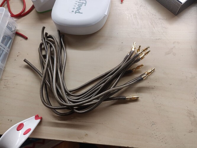

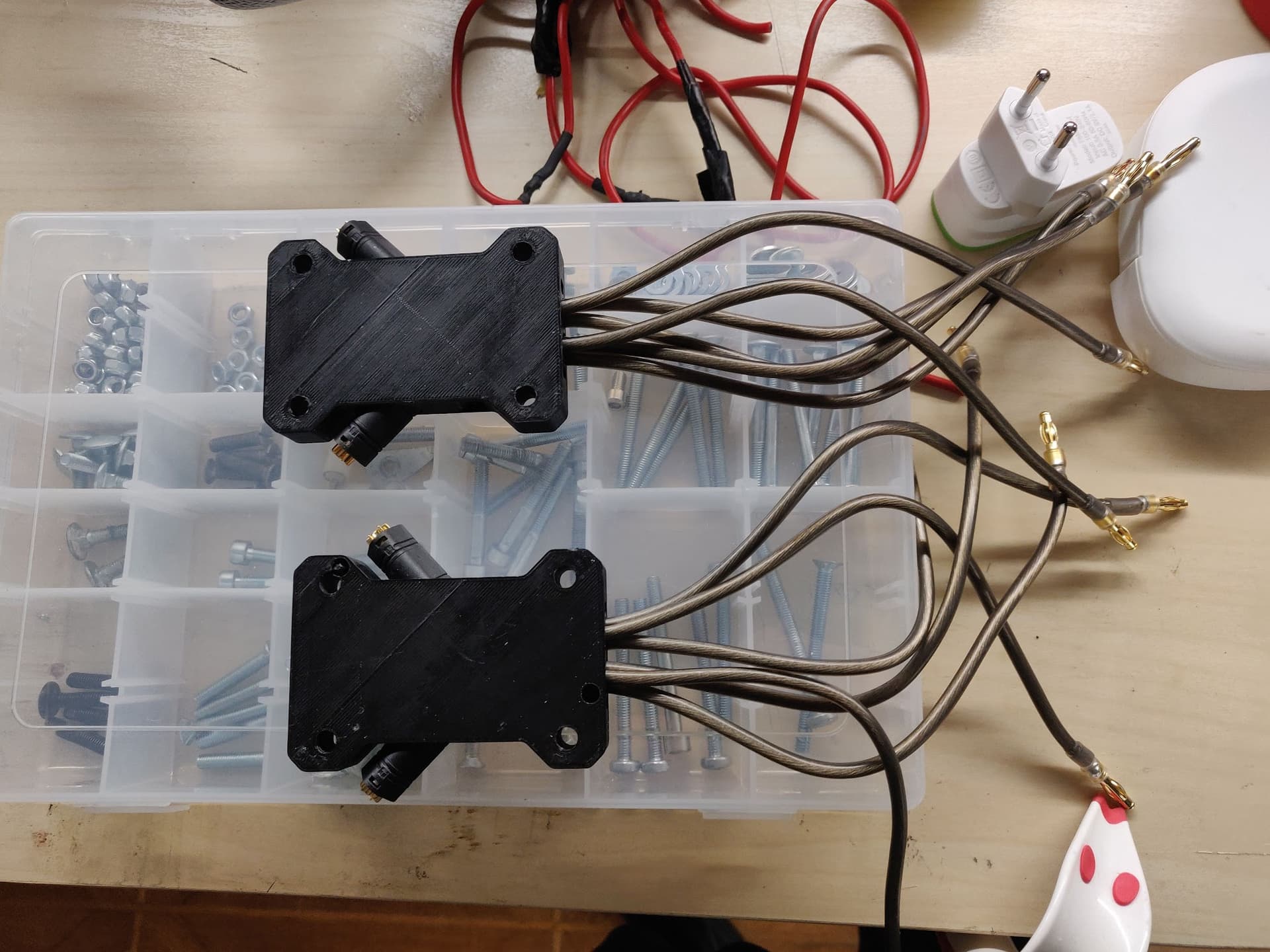

had a nice valentine, 2 hours of soldering. but in the morning I had finally spun all 4 motors. now I need to test it with davega and the flexiBMS, and finish the insides.

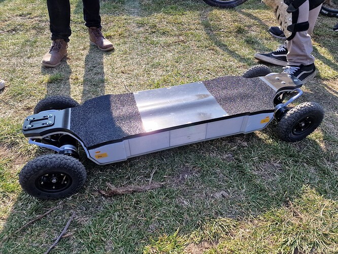

well, did you think this build is dead? I thought the same couple of times. but not anymore!
in the past week I wanted to finish everything for our Prague ride (~50 riders), so I can finally flex with this stiff mothafucka after 2 years the works :smiley:

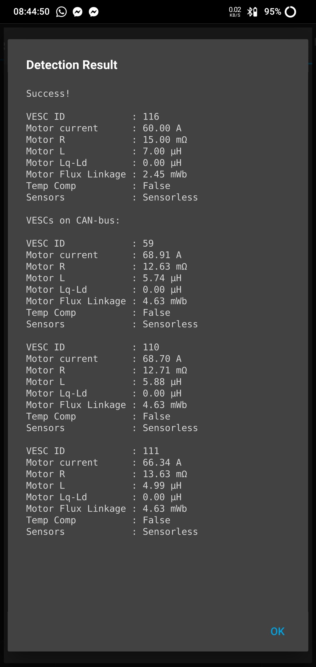

so, about the calibration I posted before - that was the last time I made a successful calibration (until yesterday). I dont recall the exact version that was preloaded on the HD60s, something like 5.1.
updated straight to 6, could not run detection
updated to 5.3, ran detection but motors screamed on direction setup
updated to 5.2, ran detection but motors screamed on direction setup
spent like 4 hours running detection on separated vescs, reflashing FW, with the same results. yesterday tried meter detection, ran almost flawlessly, so I stuck with that. had to run one vesc a second time, because the first try failed. nonetheless, I had runing all 4 motors.
calibrated for PPM, and tried full throttle. 3 motors started cutting power, stopping and starting again. with traction controll off, this seemed eliminated. also had to step down to 60A from trampas default 80A.
with TC off, full throttle and full breaks with no load still produce overcurrent errors, I’m kinda scared of that :confused:
so, dont know what to do next. I’d like to go to 100A per motor, but the DRV errors without load scare the shit out of me. and the TC is the same. had anybody had similar issues?
(btw, absolute max current is set to 120A, trampa states that the max is 160A, so can I set it higher?)

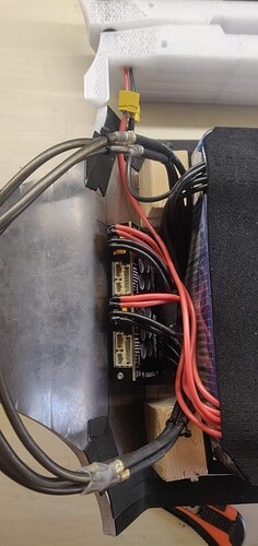

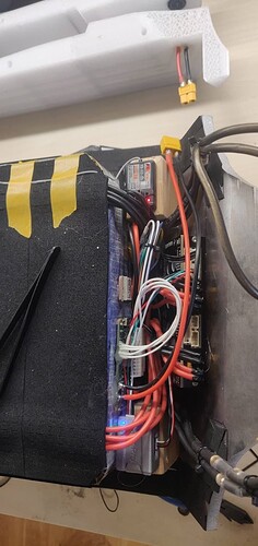

some remaining build pictures
front is a bit more cluterred:
back has sope space left:

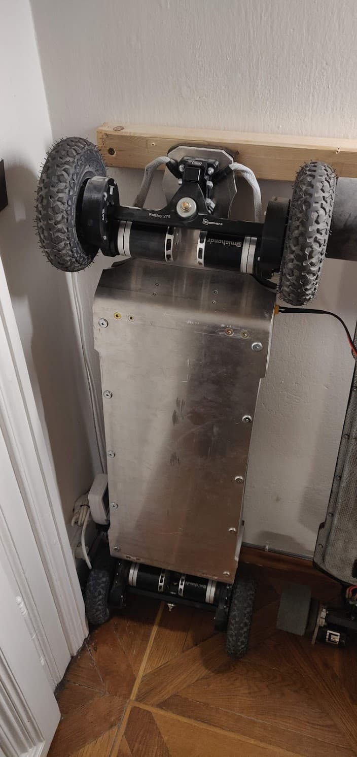

    • it weighs 46kg (:exploding_head:), and I need to drag it 2.5 floors. will need some painkillers for this painkiller, if I dont come up with some comfortable system to move it
  • get harder bushings
    • I currently have the stock 3ds bushings, tightened to death. it cant turn, and it is still flimsy to ride fast
  • adjust truck angles
    • dont know yet how exactly, but I’ll have to do something with the adjustable 3ds baseplates when I already have them

riding characteristics
its a tank, great in some aspects, bad in others. having half the bodyweight under your legs has some benefits - you can change stance easily, dancewalk while waiting, because the board will go nowhere. it’s almost like standing on solid ground
with tires on 25PSI, small coblestone is like a feather. I’m used to the same pressure in the same tires on my trampa, but this is smoother.
on the other hand, any biger bumps are very bad, the deck has no flex, compensates nothing, the trucks are heavy as hell and flap around. due to this I rarely went over 50kph. I hope this will get better with stronger bushings, but I somehow feel that the construction of caliber businging seat/assembly is designed for different loads, and this setup would be much better on eg. finallity trucks.

Well the DRV errors might just be the ESC’s fault, if Linsus says so.
Yes, set it to 160A. That setting determines when you get overcurrent faults, so you usually want it to be the max the ESC can handle.
Also, stay with FW 5.2 please, unless Trampa tells you otherwise. 5.3 is giving a lot of people issues…

  1. Set ur truck angles to 45 - 40° in the front and 35 - 30° (the lowest angle 3ds plates can go in the rear) on rear to help fix sketchiness while riding at speed.
  2. Get Riptide Krank 93-95a chubby street size bushings for boardside then aps 95a chubby roadside for rear truck and same boardside chubby in the front but then do aps 90a chubby or fatcone roadside for front truck.
With that combination u should be able to steer alot more comfortably and have good stability.
  1. With trampa hd vescs ur not gonna get quad 100a motor current out of them they dont support that much current, im currently running quad 100a motor on my 4wd setup but i use xeniths (v1) with no hw limit. I could probably get away with maybe 110a if i wanted to. But yea ur escs are definitely a bottleneck since no fw change will allow u to get said current so ur best bet atm is to stick with quad 80a til u can do either 4wd stormcores so u can run quad 100a motor without issue. U could also try uboxes but i dont really trust them enough to recommend them to others, ik for sure ud have much better luck with stormcores.
  2. Since ur on rkp with a 100lb+ board, any bump or impact is gonna feel like shit no way around it, since ur on a fixed pivot point with rkp it doesnt dampen any sort of vibrations while riding. So the best thing to do here if u want a more comfortable riding experience is changing trucks now since ur riding a longboard deck ur fucked on swapping to trampa vertigos or apex airs unless u make a custom baseplate wedge similar to ur custom enclosure that will allow u to mount mtb trucks onto a longboard deck. No i dont suggest doin 3ds longboard to mtb truck baseplate adapter since that would add alot of ride height to the board unless u need the extra ride height for undertray clearance. And even on lower weight boards rkp is just not the best kingpin type when it comes to street riding on any and all street conditions, very much like riding thane wheels rkp is best on smooth roads or tracks.
Oh and two more things, add another anti sink plate for ur rear truck hanger and buy a stair ramp so u can use to just roll the board up and down stairs, that would make ur live alot easier. I got a friend who has a endurance board similar weight to urs, his is 80lbs and its a bit of a sucker to carry as well its not unbearable but it is something at times XD.
