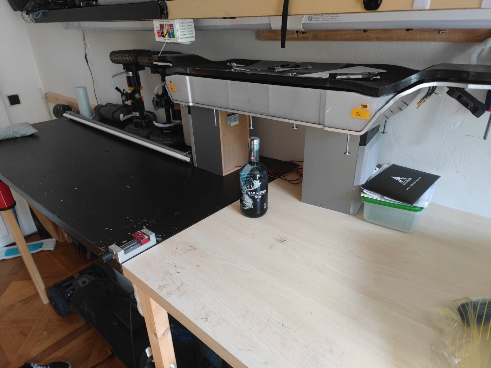

I need to move out into a new space, and would rather appreciate this being in one piece :smiley: (also, three more subjects in the picture)
I’m getting tired of opening and closing this board :smiley: the construction is rock solid, but pain to put together :smiley:

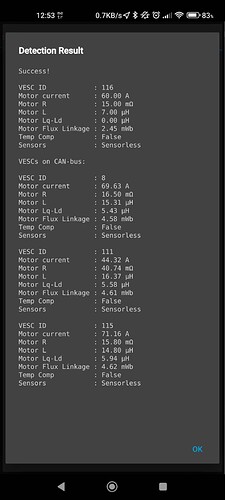

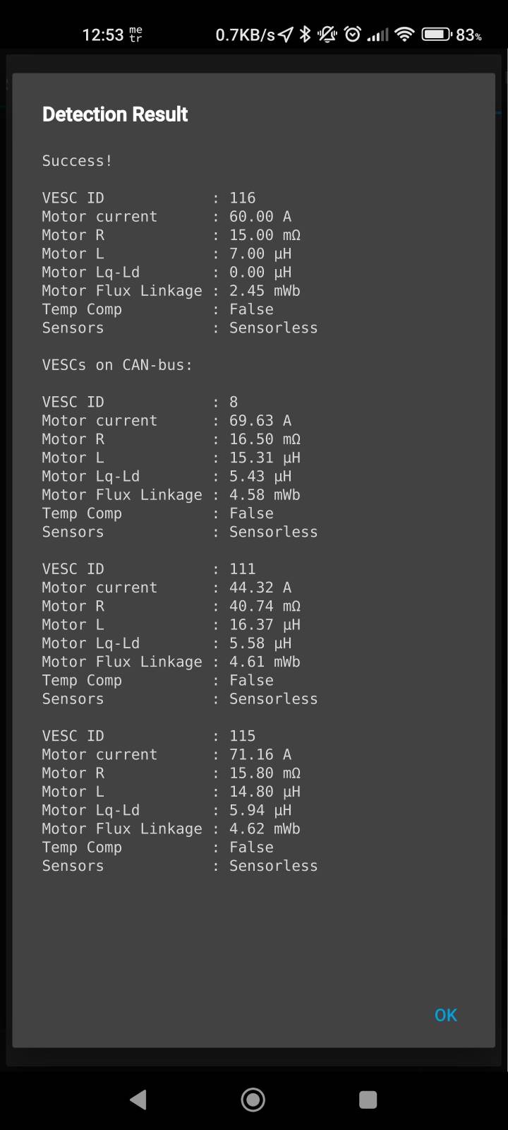

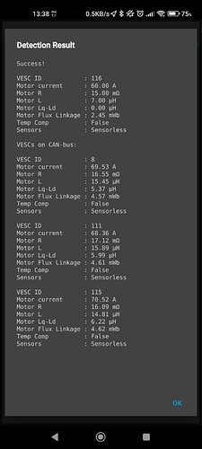

I did new calibration. the new hd60 feels solid, however the old one has some issues. I tried swapping motors on this one (vesc ID 111 and 116), and it started returning correct data. what the heck… apart from the same results on 116. how is that possible?
I tried rolling in my room from one side to the other, and noticed that sometimes one motor has problems listening to go to reverse (running hyst) and takes fraction of a second to respond like the other three.
