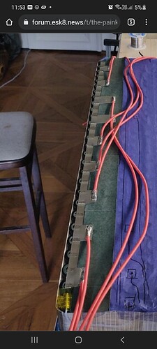

Even the slightest bit of flex could be catastrophic for this pack given the way it is built with the nickel running the whole length…

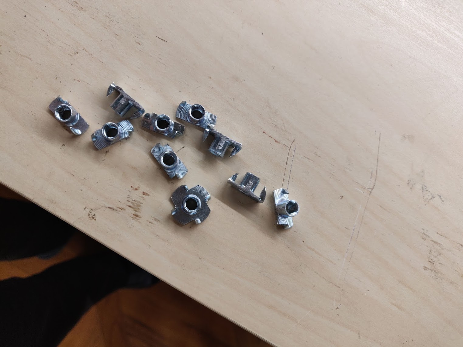

I also had to file down the 3dprint, that took some time. I need to source longer bolts, I’m short on M6x100, so I’ll try to get some nice torx M6x110.

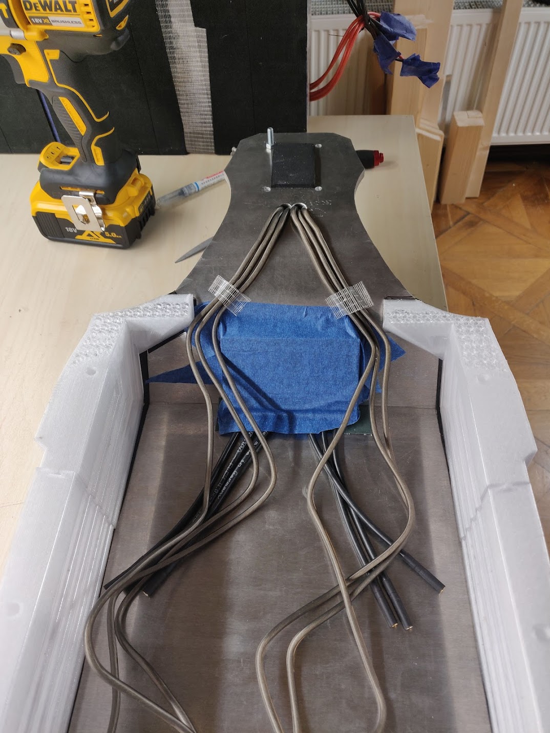

I need to install battery stops, propper mount motor cables (filed and sanded holes) with MT60, heatshrink through the hole, chisel routes for the cable to underside of the deck, attach cables, solder jacks.

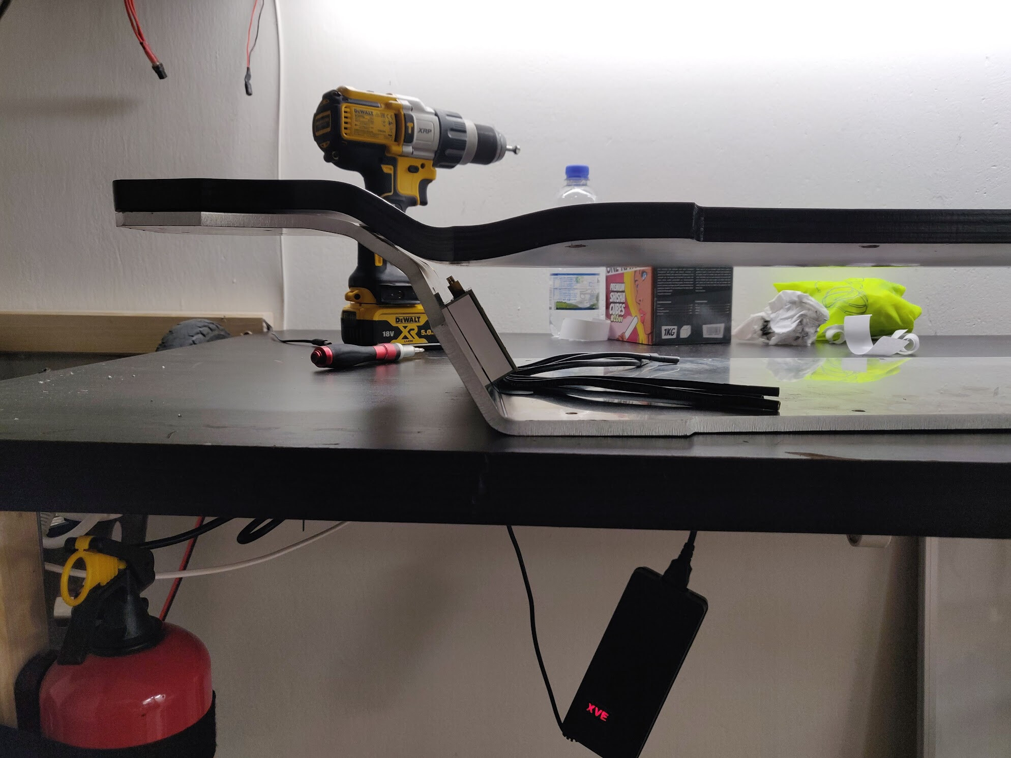

good question - thought of that, the enclosure rides directly on the trucks and the deck is only for the lateral force
what my brain thinks is that because the enclosure is strongly bolted to the deck, it might be more in tension and the deck in compression. naturally there will be some bending becuse as a rider I stand between two fixed axiles, and some movement might occur. but nonetheless the whole build will be a different universe of flexi comapred to my boosted or trampa.

I’m quite optimistic when the two parts will be one rigid body. the alu alone would be bad, it seems to give after some time under load. I had it laying on the bench for a few weeks with the battery in, and it seems to have permanenetly flexed a bit.
you’re right, that very optimistic. we’ll see how rigit it will actually be. I’ll be doing some jump tests without and with the battery, with all bolted together, to see if it flexes, and if so, by how much. better to test it in a controlled environment than experience it on road

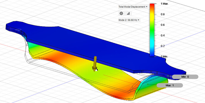

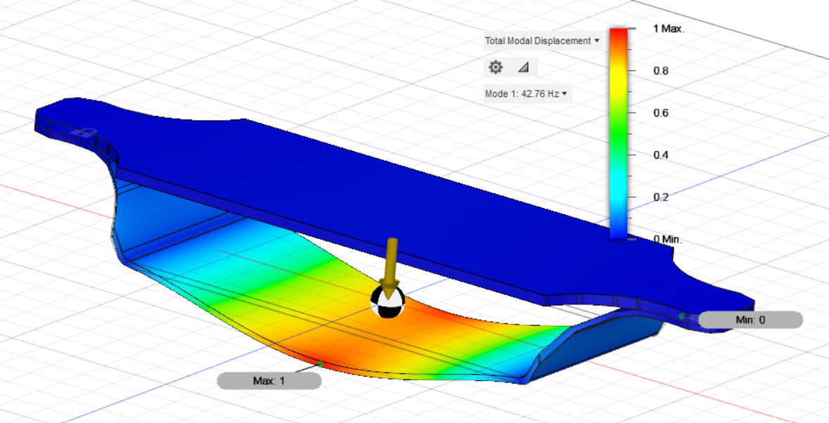

With @michondr we agreed to put forward some colorful pictures of the dynamics of this one, especially after my remark several posts up.
The first thing to consider with dynamics is (well) the dynamic properties, i.e. natural modes and frequencies. So after approximate modeling of this scary tray and putting in 23kg of batteries these are the results:
We’re getting two distinct modes of the tray below the actual deck (the deck is around 90Hz), what it means that with bumps in the road the tray will get excited by itself. Not healthy.
Normally you’ll want the whole structure moving together so no relative motion will happen. I would consider tying the two parts together, standoffs might help, solid walls are better.
