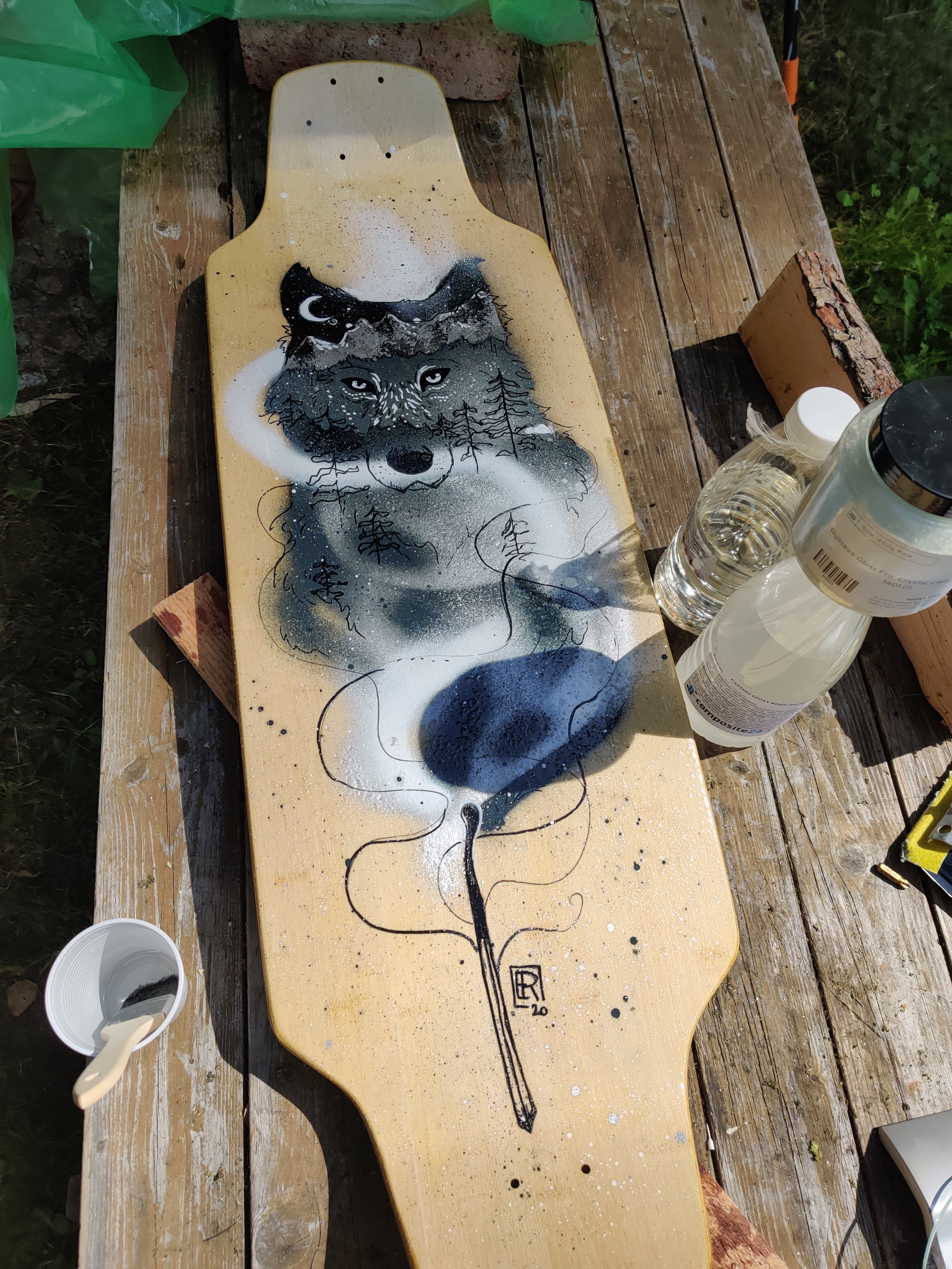

New deck
This time I wanted to keep the natural bamboo look. I applied my experience from the first one and this deck turned out much better. I managed to build it in one weekend. More detailed info about the layup and molding process is in the second post. I didn’t took pictures while I made the second one. But basically it is an vacuum formed bamboo, glass fiber epoxy composite deck.
Here is a look a the finished piece
The bare bamboo looked a bit boring tho so I decided to let a friend of mine paint art on the deck. The design is a collaboration of my ideas and her epic artistic skills bringing them all together.
I covered the deck with clear fine frit. Unfortunately epoxy slightly changed and smeared the colours, but I still love how it came out.
