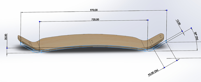

I can share a video of the deck flex. I actually have never been near any other mtb deck so I don’t know how stiff it should be or how you guys would like it.

What’s the length and width on your deck? Also what angle did you shoot for on the tips?
Length: 950-970mm, width: 300mm and angle 30deg
Added exact dimensions ↑↑

May I ask, out of interest, why you chose a “flat” design, as opposed to raising the side to give it some concave?
That would certainly help with traction now that you’ve ditched the bindings.
Does that require specialist tools and machinery?
I’m guessing you’d need to cut the deck shape before pressing?
Because it was easier. I made the flat mold out of stacked MDF panels that are cut using a laser. For a flat deck the panels are all the same. Now think about how you would go about making a concave one? :smiley: each panel in the stack would need to be different…
I cut the contour after the deck shape has been formed. It comes out of the mold as a wavy square.

In theory you could add long “wedges” into the mold to create the lifted edges.
But who am I to question something that’s wayyyy above my knowledge level. Like I said, just curious and learning :blush:
Actually yea good point! That should be doable.
The wedges could be 3d printed.
But then I would have to start playing with the bend angles and stuff. Unless somebody has good examples to show me?

I checked the Kaly decks too and I think I could try to make mk3 deck with a concave. But I think the concave might be similar to flux deck. It would run the whole length and would not be as agressive as on kalys.
I think the whole length is better anyway. And Kaly’s is too aggressive an uplift for my liking. They’re more gas-pedals than concave.
