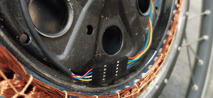

I started by first opening up the hub motor, as it had an integrated chinese ESC in it, that I didn’t want to use. I was going to use one the VESCs from my esk8 to power the e-bike.
Rotor has 46 magnet poles.
I’ll be using the already available hall-sensors in the hub.
I was originally planning on wiring the phases out with 14AWG silicone wire, but they + the hall-sensor wire wouldn’t fit through the hole in the axel to get them out.
It’s a very simple motor mechanically.

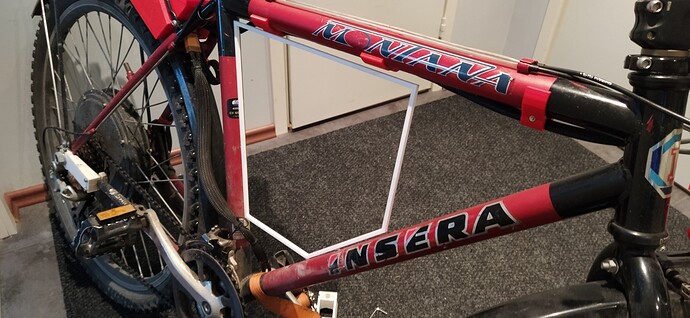

Figuring out if I could make the electronics enclosure in the back between the wheel and cargo rack.
Later iteration of the electronics ecnlosure.

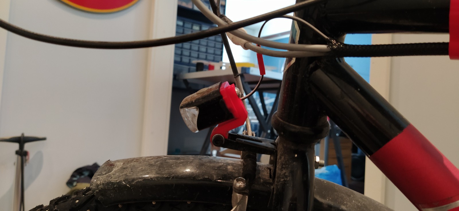

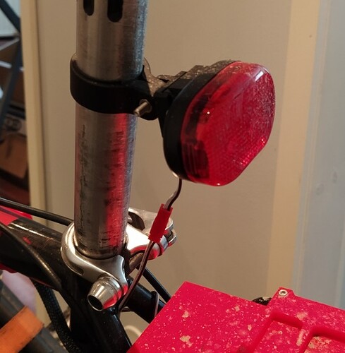

I bought a super cheap 5€ head and tail light set, meant to run on couple AAAs from Biltema and modified and hard-wired them to be powered from the VESC’s 5V rail. Did some extensive modding on the front light especially to make it much smaller, as it wasn’t going to contain any batteries. The red connectors are JST’s RCY-connectors, also found in some smaller RC LiPo packs.
Works well and don’t need to worry about replacing batteries!
The bike has been working without problems even during the rougher weather.
