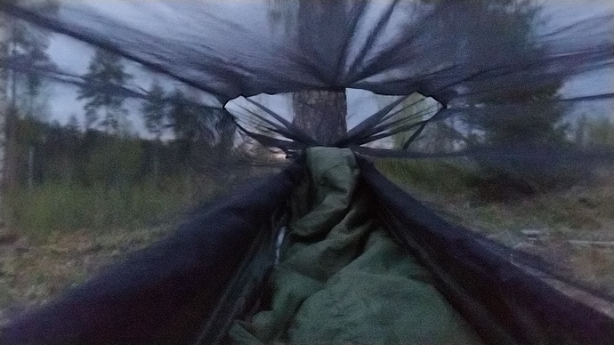

Went in for another go in the forest last night. Managed to be out there for 5 hours this time and actually
managed to fall asleep, for a short while at least. Woke up at 4AM to the cold and this was with all the stuff on I had brought with me. I have a Vlog style video exporting at the moment, so I might post that at some point.
One colleague mentioned in the morning in our work group’s Telegram chat that he had been using an Exped air pad/mattress in tenting for 10 years and the positive experience he has had with it. My team leader then mentioned that a particular store chain (Lidl) might have actually had a batch of air pads available, so I walked my ass over to the closest one (close enough to not need to esk8) and indeed they did have them and for a very reasonable price. So I got one.
I’m gonna try again this night with this, because if this works at least for the bottom/back coldness then I can very likely just get a bit colder rated sleeping bag for the top side insulation in case I still feel chilly.
Learning.
Here’s the video from the second night out. I have the last night’s experience exporting at the moment.
3rd nights happenings. I have ordered some more gear, so probably no more camping tests before those arrive.
At least I made it to sunrise this time… Even though the sun rises at 4:15AM currently :smiley:

@SimosMCmuffin in regards to loosing heat under your hammock, I have had this issue as well. There is a product called an “underquilt” that hooks up to your hammock that helps immensely with this problem. In your second night pictures it seems like you figured out this idea with something, though it kind of looks like a blanket. This is good, but it is not very light and does not pack small. I would suggest investing in a proper underquilt, as most of them can be packed down to the size of a grapefruit.
Will concur with @BenjaminF
I’ve spent 100+ nights in a hammock and my wife and two girls use one too. Under quilt is key but pads sometimes work. The problem with pads is they slide all around during the night. The brand Klymit has ones with wings that are cut for hammocks. They have two versions, one has more insulation.
Trip sounds like a blast.
This project is a demonstration of what the Finns call “Sisu”. I love it!
As for where to spend the night or just charge, I would highly recommend using Couchsurfing. If you have a decent profile there and post your plans, you might find more than enough people who will be happy to offer you a roof or power.
This very lightweight alu foil had amazing effect in tent under our sleeping bags. We also had one as cover over the bags in colder nights and you instantly feel the difference with it, as it reflects your heat back. With its width of 120cm, it would almost roll around you in hammock.
