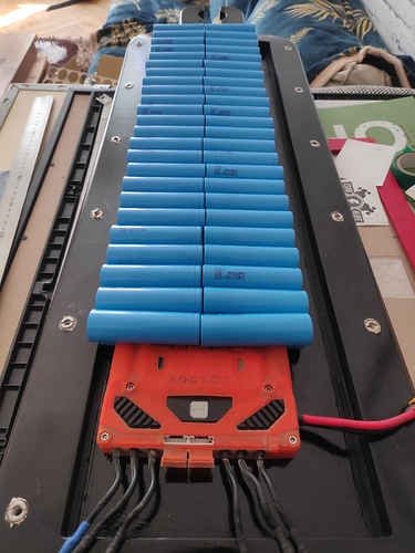

With all that battery talk, do you have pictures of how the battery is made, @ThomasL?
$40 is really fucking cheap/good deal.
I don’t have the pictures internally, but I have this:
Is it possible that you could get some pictures of it internally? :grimacing: maybe from the builder?
Those pictures you’ve sent are honestly pretty useless.
I’m not saying it’s a bad built battery (yet :stuck_out_tongue_winking_eye: ), but just want to make sure you’ve got a proper battery that won’t light this lovely board on fire…
$40 seems scarily cheap to me.
The builder is working in a company building batteries for electric bicycle, so cables/connectors, paper, etc… is pretty much covered. The 40$ is actually only for his time.
It’s not his first batteries for the Prague electric skateboard group, but it was his 4th of 5th. So far, any of us had issue.
