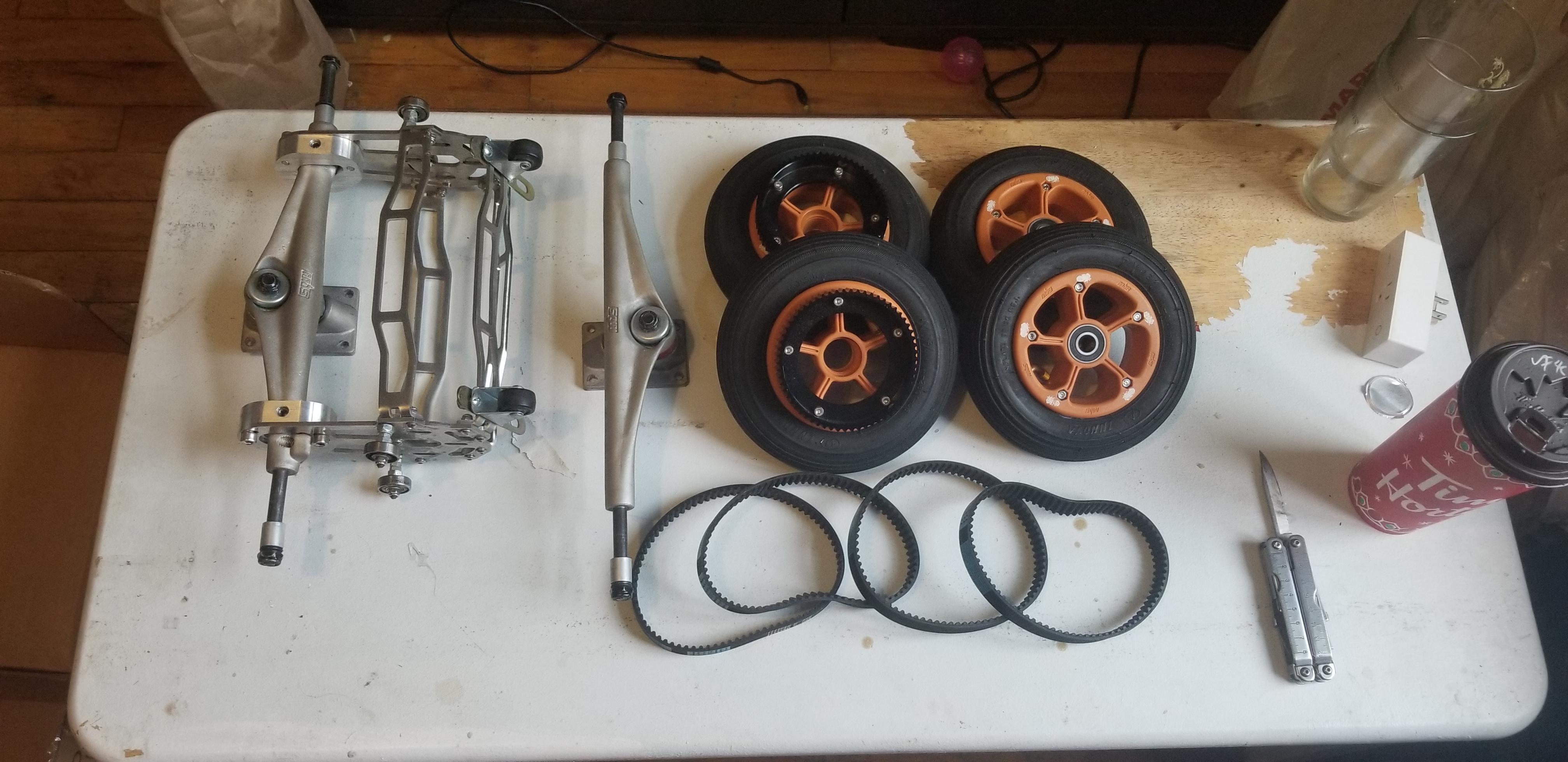

Don’t do that, even if you already have them.
Second time I need to tag @Venom121212 today :sweat_smile: he can tell you a painful story about those trucks.
Seconded this, I have a set of this style trucks that I have to “sit on” because of what I learned about them.
Might use them for some sub 20mph 3SK8’s but even that sounds sketchyyy
Can not recommend sadly. They ride nicely like a hybrid skate mtb truck. Stable at speed until they snapped :sweat_smile:
@Andy87 @Fosterqc @Venom121212
The ats12 are not the best. But I will make the best of em. They were part of my secret santa gift and I want to make honor to that gift :slightly_smiling_face:
Your glass is leaking

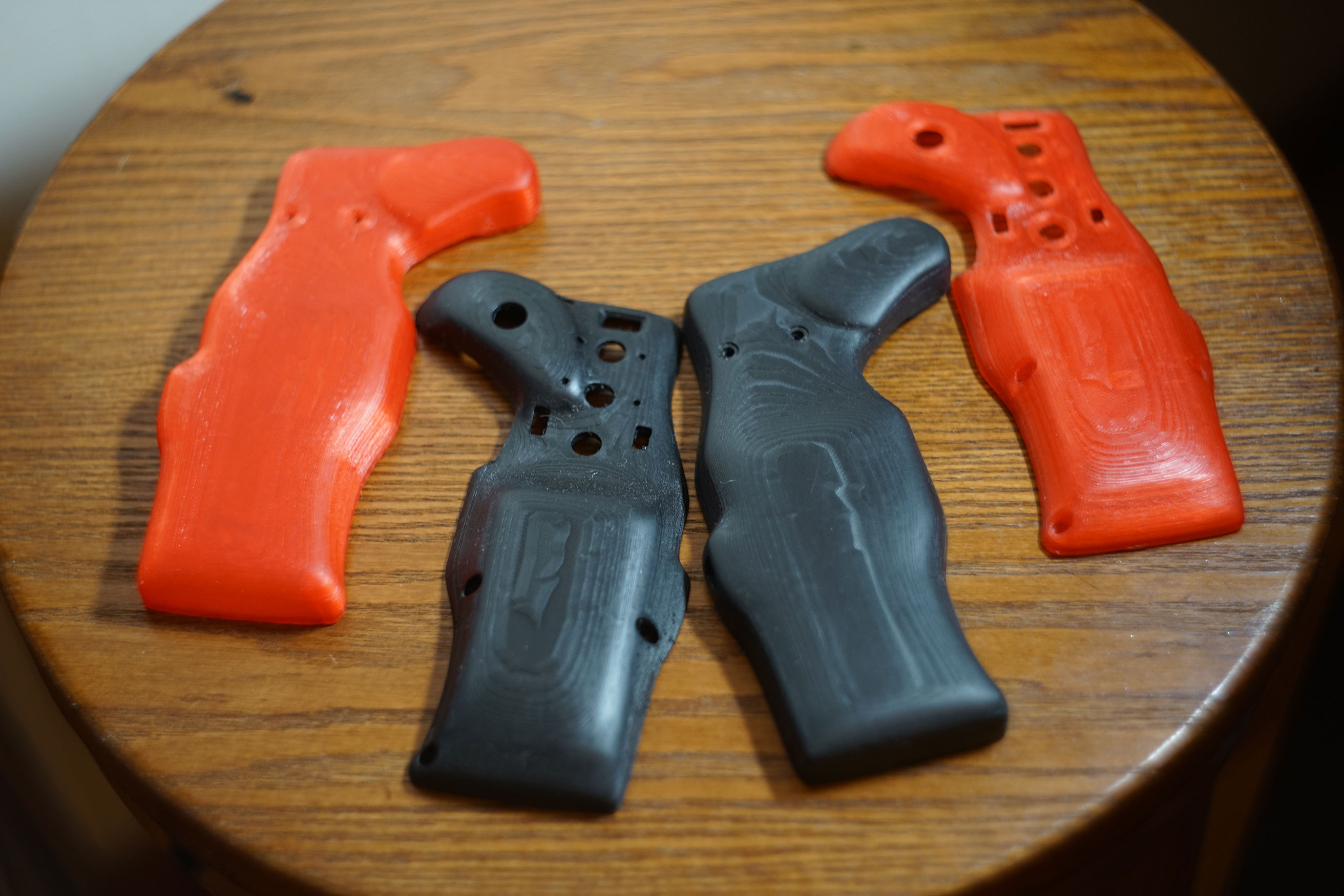

Actually, scratch that. If I go gt2b on both I’ll just buy a second gt2b. Got 2 marvelous cases coming from winnipeg
Had them slightly modified to try and add a component that wasn’t included in the original design

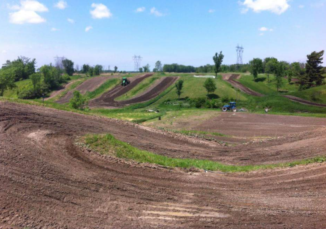

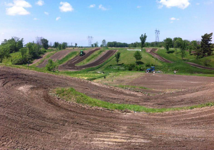

Here’s where I intend to use it
hawt…
I have considered trying to find an acre of un-farmable (cheaper) land in my area to turn into a dirt track. Gotta convince the Wife first.
@Davewesh good luck :joy: the place I showed is a motocross track that allows boarders to use it when there isn’t an event happening. They only require you to be padded and sign a waiver stating “I break my neck, you’re not responsible beyond calling an ambulance”
They take a surpring amount of work to upkeep. The bike park near me has county employees out there constantly watering it down and sweeping.
Honestly cruising through the woods on mild to medium terrain is my favorite riding by far.

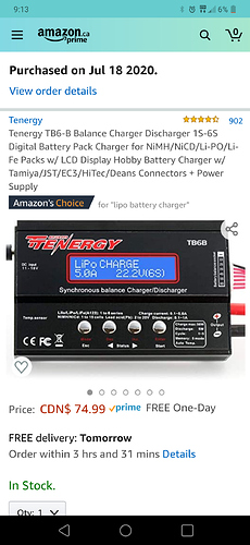

Placing this here so I don’t lose it
Batteries and charger figured out
jeez that’s a loooong lipo
It was :joy: the funny thing is they could’ve easily stacked them. Just finished doing so.

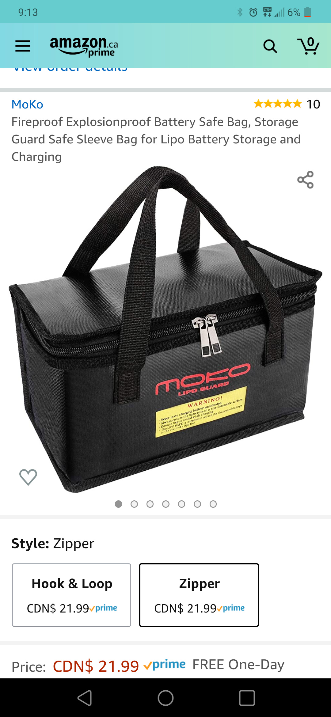

Just gonna put yet another thing I don’t wanna fuck up :yum:
