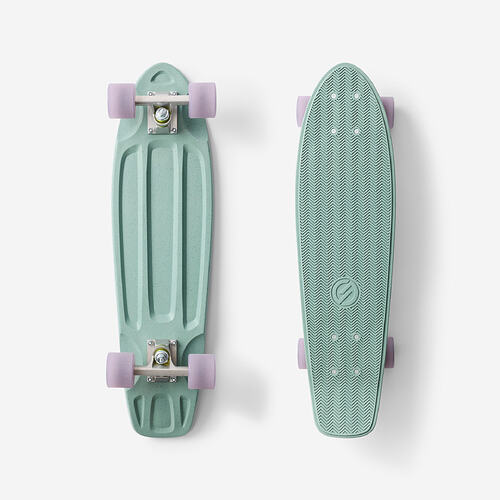

I’ve seen this deck the other day :
Looked like a 60cm long weirdly high quality penny deck,
I thought that was something you could want to use
