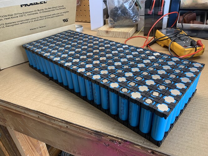

20s8p M50A? You powering a tank?
@Battery_Mooch review of molicell m35a soon!?
20s8p M35a. Upgrading my ebike from 52v to 72v.

I completely forgot that I already read this :man_facepalming::man_facepalming::man_facepalming::man_facepalming:
And I just realized I forgot to put isolation rings on all those cells :man_facepalming:t2:
AND GUESS WHAt?!
None of us even noticed that :joy::rofl::rofl:
Just got 160 of them to do :man_shrugging::joy: good luck brother
Right ?! C’mon guys :rofl::rofl::rofl::rofl:
