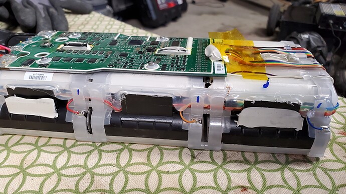

Can you please take some pics of how the cells are connected with flexible connections or any other weird stuff. That’s an interesting battery

I made a schematic of what / how it could be connected, it’s a 13s2p on the BMS side it’s a 4 cells wide by 3 cells length ant the top is a 5 cells wide by 3. the 2 ones in the middle tho i don’t know where they are connected
Is that the battery that’s just compression connections?
you could remove the kapton tape and the white silicone over the rainbow ribbon, multimeter on the negative or positive doesn’t really matter) from the bms and try every little pins, either goes up or down X voltage, btw are they Li-Ion or LiFePo4?
@hummieee it does seem like compression fit but it’s weirds that small tabs are ‘sticking’ out if it is

Here are some more photos
And a video
I think they’re a123 lifepo4 cells

that bms is coated with epoxy or what??!?
I think you’ll need to unscrew the bms to be able to have access to the whole wireing, this battery is so fucking confusing not gonna lie
