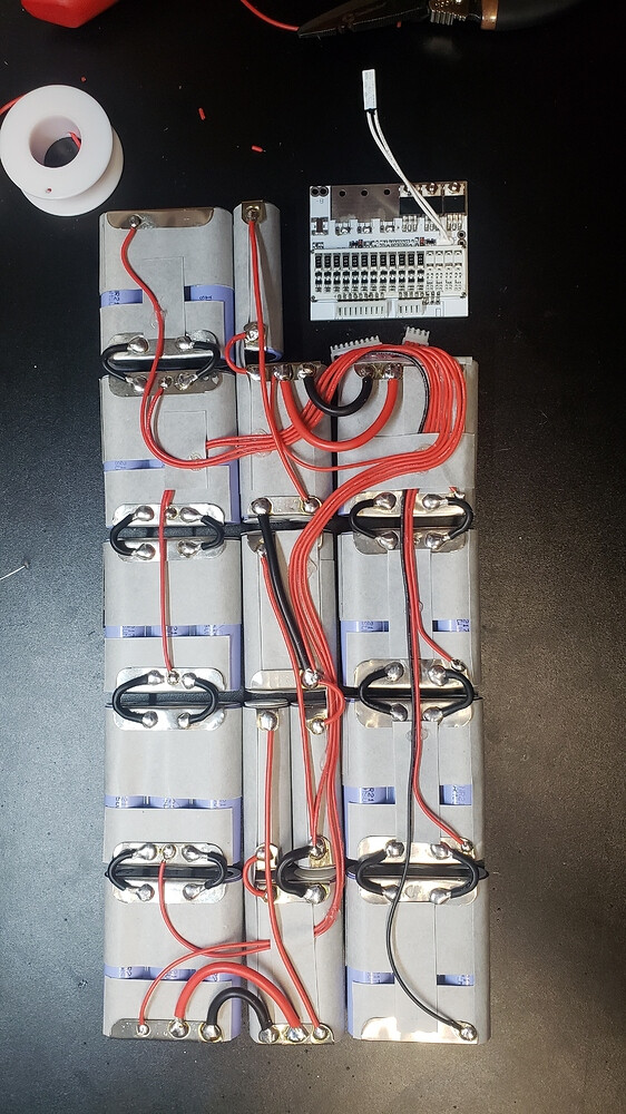

I am trying to figure out if there is a clean way to design a 12S3P, P42A pack for an Eboosted Bustin Sportster MKII enclosure. Pics for reference:
It looks like the enclosure is designed to hold 8 across (perfect for 4P) and I am not sure if there is a good way to maximize the leftover free space with a 3P battery design. Please forgive my ignorance, perhaps this is not as complicated as I am making it out to be.

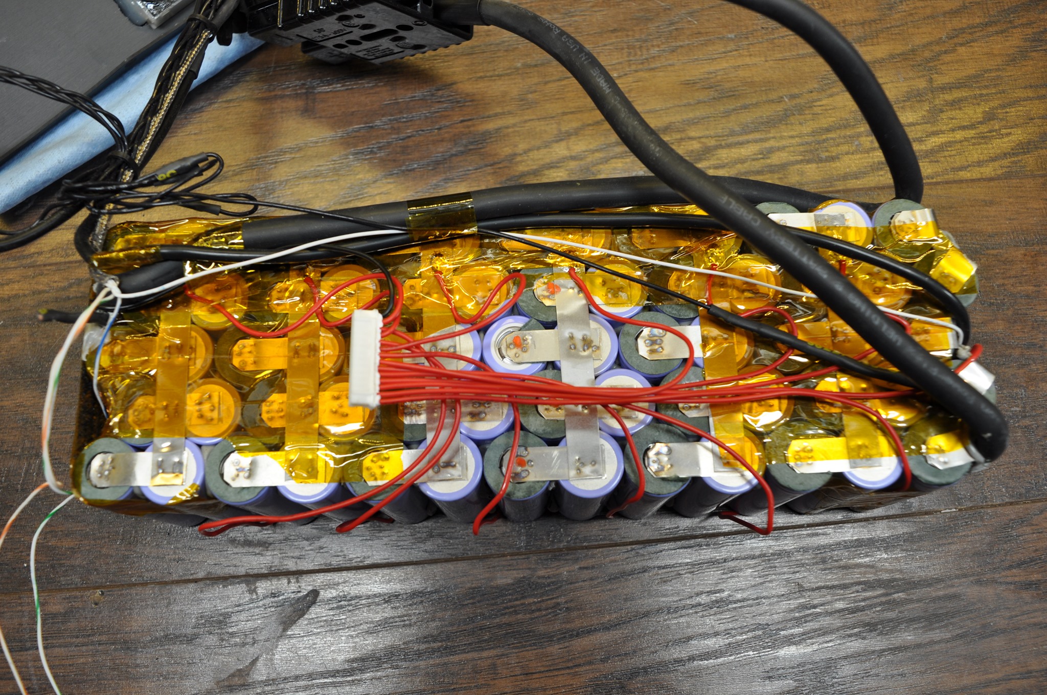

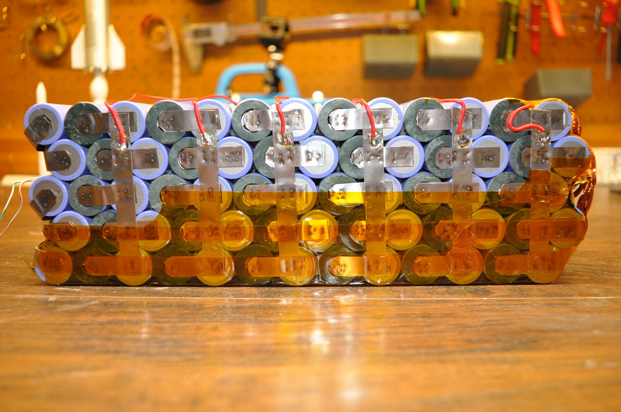

@Skyart - Was this configuration too much of a PITA to consider?
Don’t do it, not worth at all
TBH it hurts my head a bit just looking at it, but I applaud your creativity!
By far the hardest pack I’ve ever built…by faaaaar, needed to be in that shape and flexible…I don’t think it ever got put to use tho. Looking back at it, I would have done some things very differently
