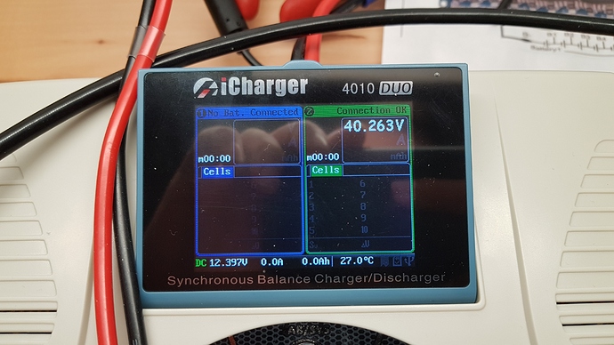

Please help me confirm that I’m not making a mistake. Tried balance charging only on my balance wires, but got the error below.
FWIW got the same error when trying to charge my Turnigy LiPo on only the balance wires, as a way of trying to verify.
you need to connect the main plus and minus wires as well :wink:

We have a little problem. The balancer shows no voltages of p-groups.(The rest of balancer cables were connected via crocodile clips, not in the picture) But it shows the main voltage of pack, when it’s connected with the charge port.
The cabling might be wrong, looks quite strange? Why are there y-connections? Did it ever work before?
Did you check voltage of each pin on the JST connector? Always do this before hooking anything up.
You should also double check the order of the pins, maybe you’ve got it flipped?
Also, 10s should have 11 pins (to connect to a hobby charger).
