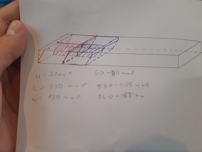

Hi @NeonHuzo
Is there a reason for it to go with such a big pack but choose that low capacity cells?
Which cells you have in mind to use?
12s15p is about 9kg just for the battery which is a lot and you need to have the space on your deck for it as well.

First reason for such a big battery pack. Well batterys them selfs I dont wont to worry about current draw to kill them and also the range of my e-longboard.
Cells I soruce from local shops that sell the batterys, people come to them and drop off old batterys and battery pack. In the build I am going to use mostly batterys from pack of the old e-bikes, hand held drills and so on. And of course me and my friend take care of them, mesure the voltage before chargeing them to know witch ones are realy for recycleing and witch ones are for upcycleing. While chargeing we watch for heating of the batterys and if they heat up fast and relatevly hot (around 50 C) we recycle them. And finaly capacity testing. And this cycles are made about 3 times for each cell. And ofcourse self discharge.
For the drive train I am still thinking (price is the problem).
Deck I still dont have but I am planing to make one from plywood ( laminated wood :sweat_smile::sweat_smile:) . That will come after thinking drawing and designing the battery pack, building the ESC (Cheap FOCer) and makeing the decision about motor.
And lastly. Sorry for so many ands. Board is planned to be used as everyday cruse board that is capable of going a long distance and (if needed for adrenaline boost) top speed of 55 60-ish km/h.
Thanks in advance and sorry for my enaglish.

I am not plannig to use mixed cells. I will try to put in parralel same cells. Maybe I will change my mind after I find time for this project and reading throught batterys datasheets and thread. First I will try to make physical desin for battery pack that would be easy to modify. Then will source as much as I can store at home test them around 3 times and mesure inner resistance for each cell.
Still a 12s15p is huge and heavy and need the right deck to make sense at all.
I don’t know your plans but you will not get this pack in an enclosure under your deck. Not without 7-8“ wheels as minimum.
Means you will need to go with a split pack (up and down the deck) or fully top mount.
@Lee_Wright you just made a 12s10p pack, right? Maybe you can post a picture here to show the size of the pack.
@NeonHuzo you will need to add 1/3 of that pack and than it’s what you want to put on your board.
12s13p… any bigger and i would have to go double stack :rofl:

This would be battery arrangment in 1 series.
This would be 2s
And this is how I would connect them in the case half of the parralel conections would be fliped so first iteration would have + in the front (please go to the first pic) and then polarity would -.
Would this be any good???
