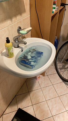

but then I had to get rid of the lipos. I just had a bad feeling about having them swollen like that while staying in dorms, where a fire would not be pleasant at all. so the batteries slowly deceased in the sink for a few days. great present in the bathroom for other roommates. the afternoon after I put them in the water I just received a message on messenger “Andrew?” and the picture attached
incredible how long it takes for them to self-discharge in saltwater. seems that they either have quite more energy stored than my brain would naturally perceive, or the process of breaking molecules of water into oxygen and hydrogen is not particularly energy demanding and takes a long time. and also, the green blue copper salts

NEVER do this EVER.
Do not discharge lipos even when disposing of them
As @Battery_Mooch stated a few times. This is terrible idea for self discharge. Please don’t do that again, it’s dangerous, it’s bad for environment.

nice input, thank you for that. I think I’ll never repeat this, I hope not to be in this situation ever again :smiley: being scared of cells does not feel good

Although I usually fully discharge my lipos to 0 volts on a concrete pad outside, or something along those lines. Everything I’ve ready is that inert lipos are the safest way to dispose of them.
