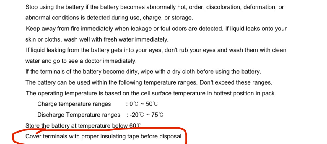

What manufacture tells you to submerge battery’s in water.
What manufacture tells you to deplete lipo battery’s below there fully depleted state?
What should you do when disposal
All from the Samsung Q30 specification of product sheet. If some ones research dose’t include the official paper work of the product then :man_shrugging:
Yes discharge it if safe to do so and within the safe limits. Going outside destabilises the battery

The original photo that started this exchange was this:
These are lithium-polymer (LiPo) batteries, not lithium-ion.

From Gens Ace / Tattu / Grepow:
From Oscar Liang:
Both seem to be bloggers or you tubers and a quick search first artical I came acros provides conflicting information.
Still advocate sticking to manufactures and sellers advise.
Bloggers and YouTubers are not regulated in any were near the same way.
