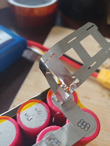

Did i just kill this cell? This is my first time seeing this out of about 6 built packs… I was welding away and this was probably group 3 and 7th time doing this today so settings have been established… The first weld on this cell was fine…(negative side as well) second weld (bottom left) sparked some followed by a mild sizzle and bubbling for a second… There is a oily kinda residue now and has a very unique small…
All the positives are connected already. Do I need to disconnect that end as well to get a real reading? Or can I get a reading with all pos. Connected and just that neg ens of cell disconnected?
Thx
gurgle
RIP
I punctured a cell once. did exactly that.
those welds look a little hot, esp. if you’re blowin through
you probably blew a hole in the cell, that smell is typical for lithium batteries
