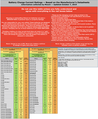

Look at Sony VTC6 standard charge rate too

Apologies, check the chart tho.
