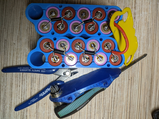

Just finished up my printed battery so I thought I’d post the last few pics here
Stuck it in my street board and took it for a ride yesterday. All seems good.

Soldering balance wires will be hard.
One second to tin the cell.
how do you like those 3d printed spacers? I guess you don’t have many miles with them, but do they hold well?
I am thinking about going with something similar for every future battery I will ever build. No fishpaper between groups and each cell can breathe.
I dint test this partucalar design yet, but I am worry only about this ears
Not my first 3d-printed battery case. The all hold well.
I was thinking more like just spacers, not whole case. To long printing time and unnecessary weight. But your case looks nice! :grin:
I wanted modular battery for flex deck. Will set 3 of this 10s2p in parallel. Previous design was heavier, It has double wall thickness - one for spacer and one for case.
