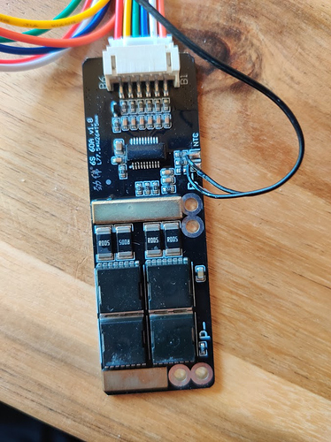

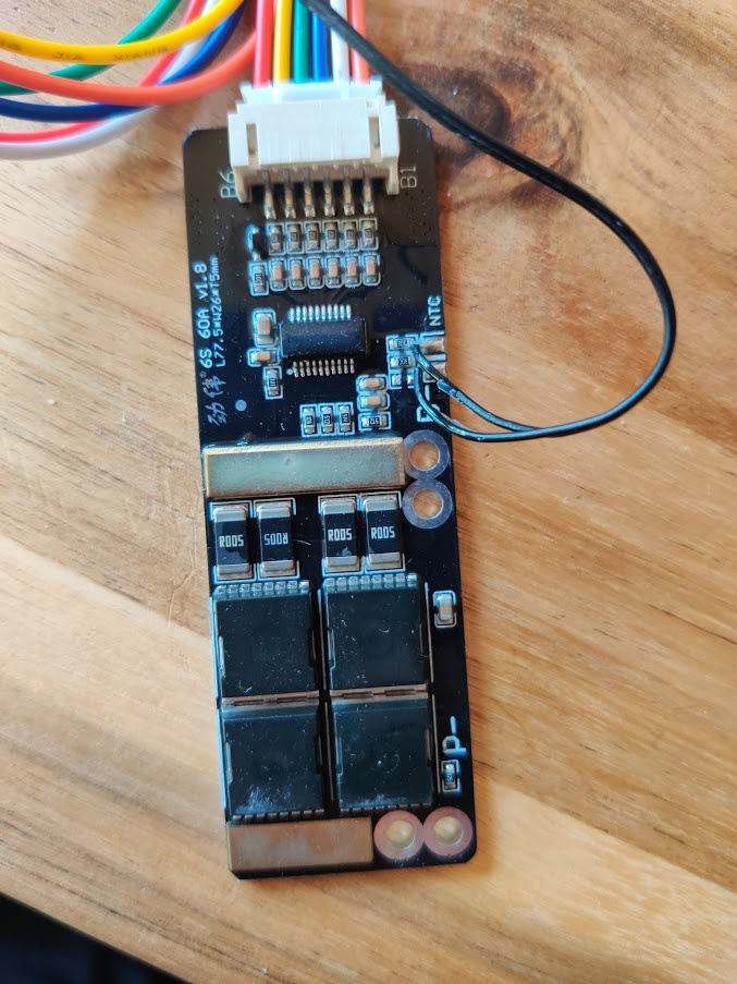

I got this BMS:
With the wiring diagram: bilde
And I’m a little confused, so am i thinking correctly, the p+ and p- go to the ESC, p+ and b- go to the charger and the balance connectors go to the positive terminal of each p group?

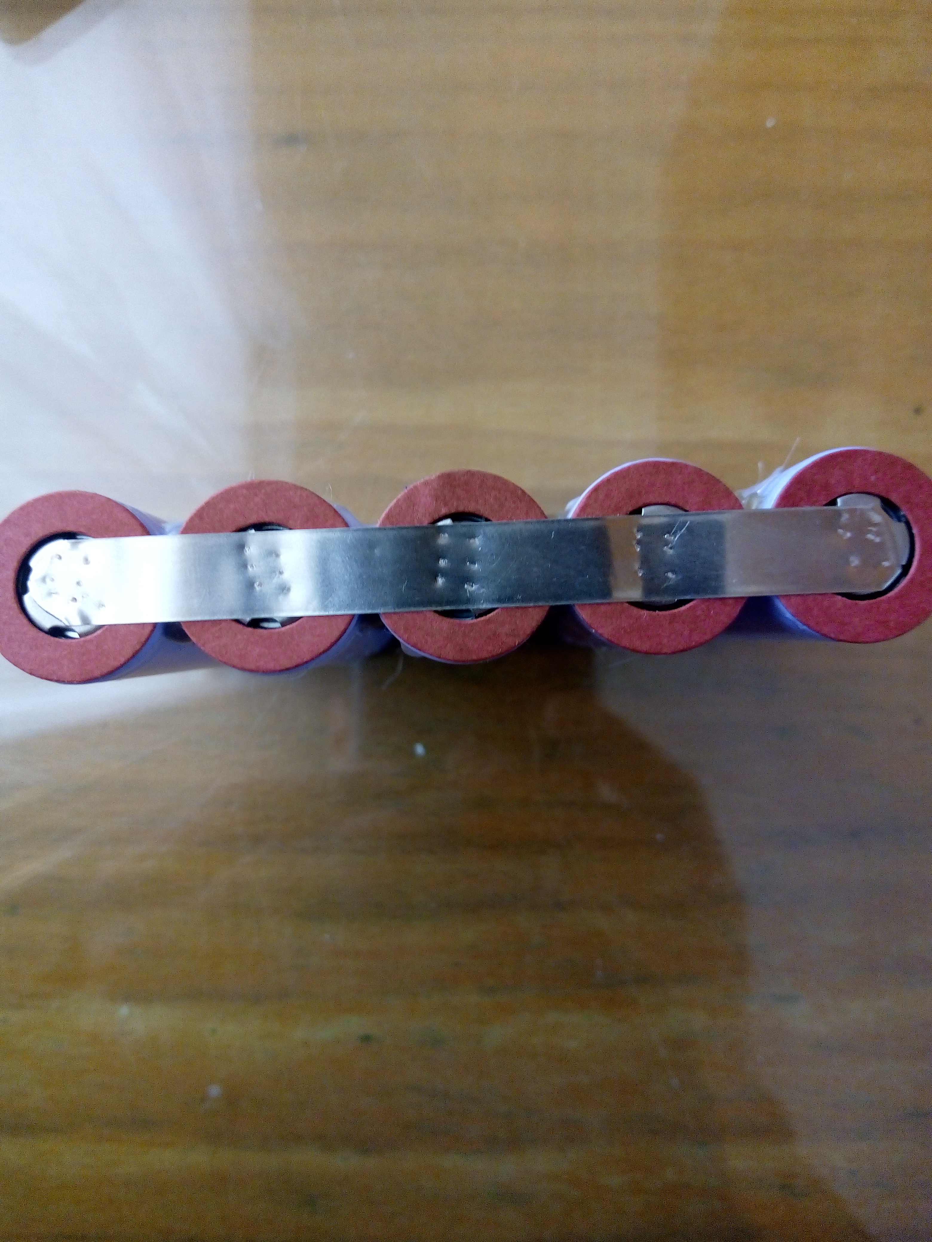

How bad are these welds and how can I test them ( I went over the last ones)
Thanks in advance
Do you have spare cells to test test the same settings on with a tab and pull it off. They should tear the nickel vs breaking off if they are proper.
i have 2 spare cells i can test on
they should rip off and leave holes correct
is there something i should be looking for within the welds?

so i tried it on a spare cell and it would come off with my hands but i had to pull hard
when it came off it left 6 small dents
should i up my amps slightly
forgot to add using 4 pulses (dont really know what it means)

You essentially want as much punch with as little heat input as possible.
