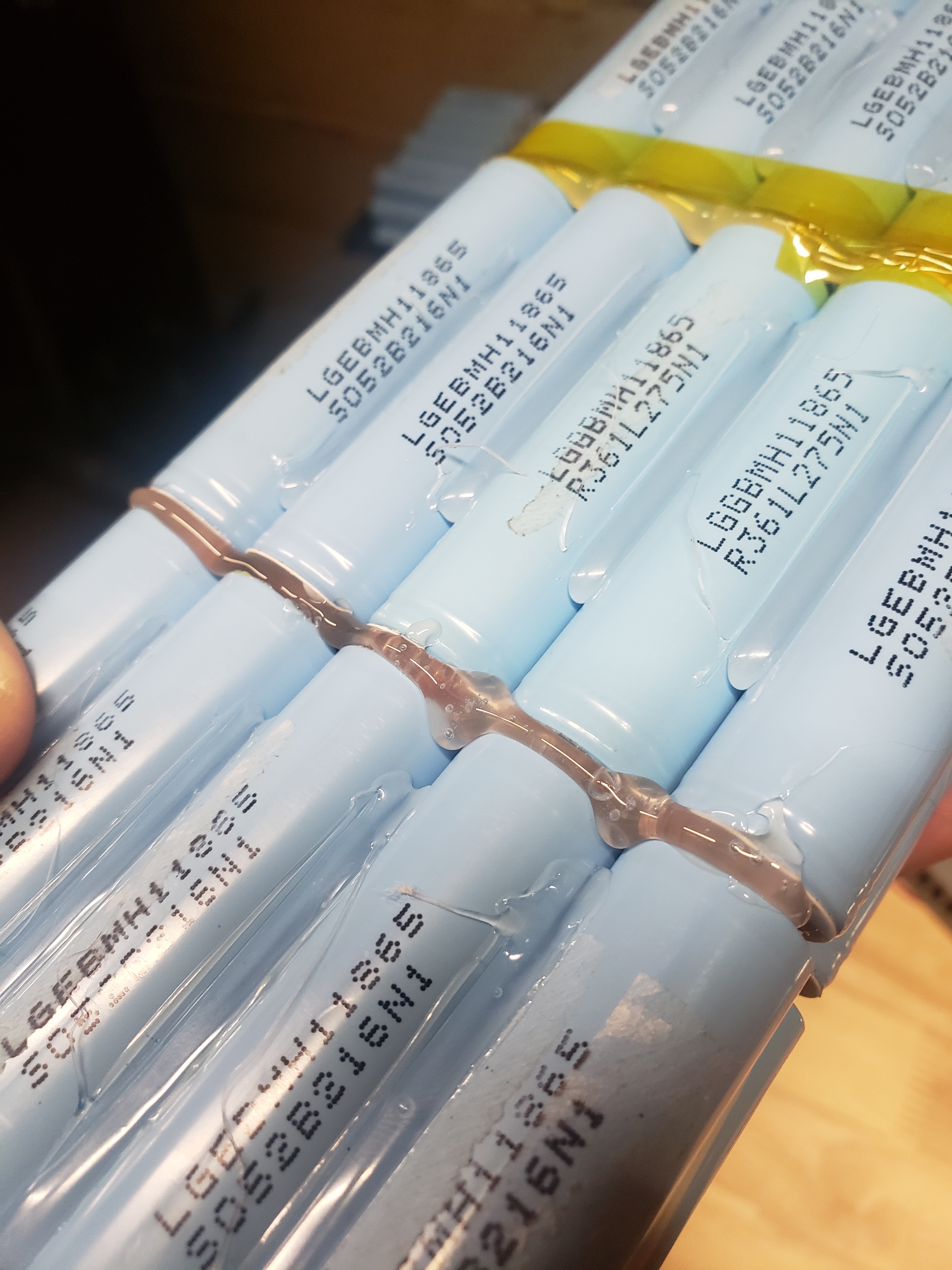

Wait. You spot welded the copper braid?
Yeah, you can :joy: it doesn’t carry full current in the case of using it to jump across bridges, but to hold it in place to be sandwiched it works great
Fucking awesome solution :ok_hand:
Sure did! Just tacked it on there, and it seems to be holding well!
Lil bit of hot glue to keep the ends from fraying
Interesting approach. Are.you aiming for no flex pack?
I see you have OCD like me and have to face all the label print on one side :joy:
Lol! Yep! :laughing::laughing::laughing:
I dont see much of a need for it to flex, it’s going on the evo. I think the more rigid the better. Right?
It’s always good to plan for a little bit of flex, even on a stiff deck, a good bump will flex the chassis. In your case you should have enough play still in your pack to account for it. My tip would be keep the folded side up. Because if the pack flex downwards, you don’t want it to pull on the fold, but rather let the pack “unfold” slightly.

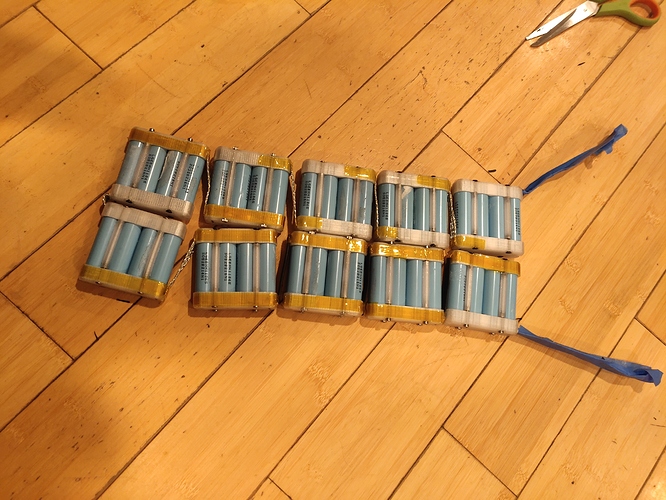

The stand off is ok for now. I just find out that only about 4 to 5 mm on each end of the standoff is engaging the screw threads. The middle is larger then 3mm. Here is a picture of a just put together 10s4p 3d printed holders battery. I will need to in balance wires and bms and insulate the wires and fisch papers too
Yeah that’s awesome!
