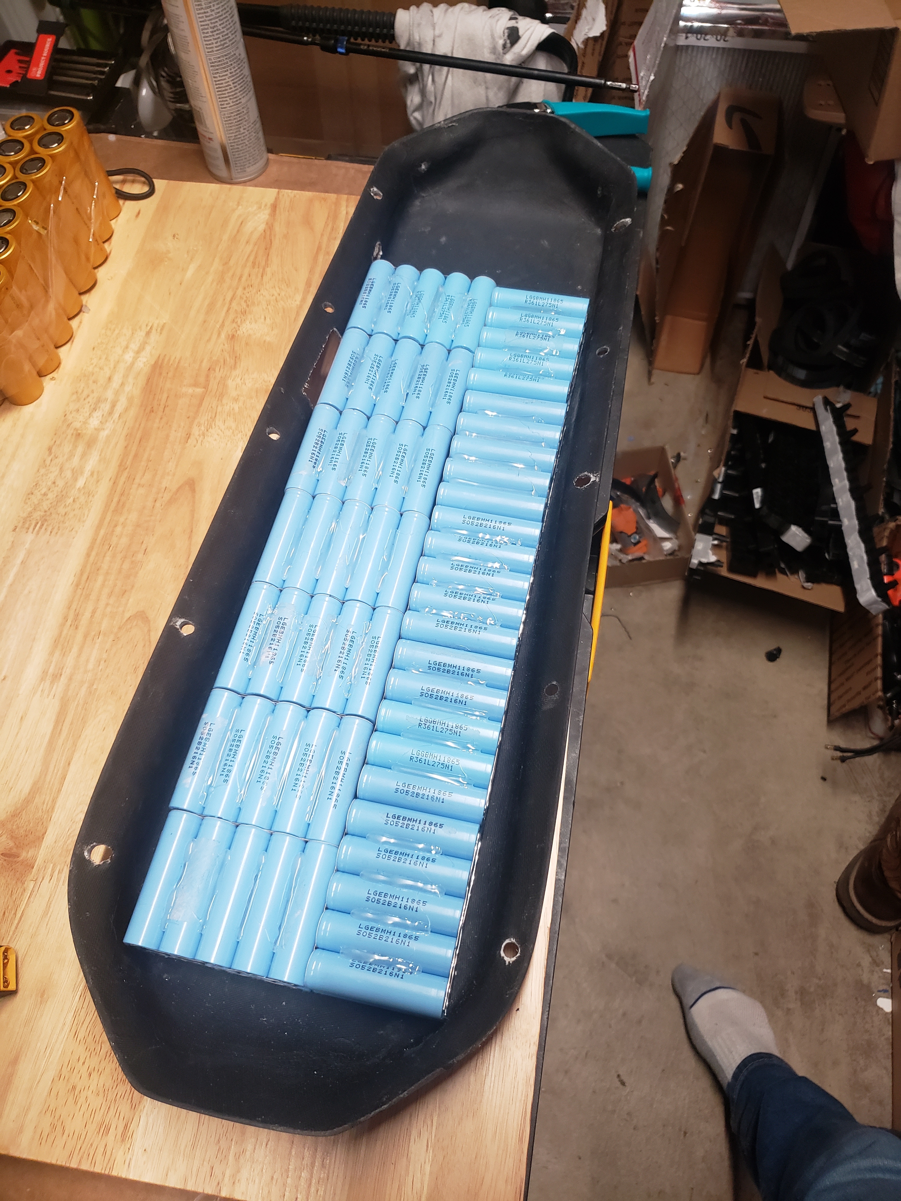

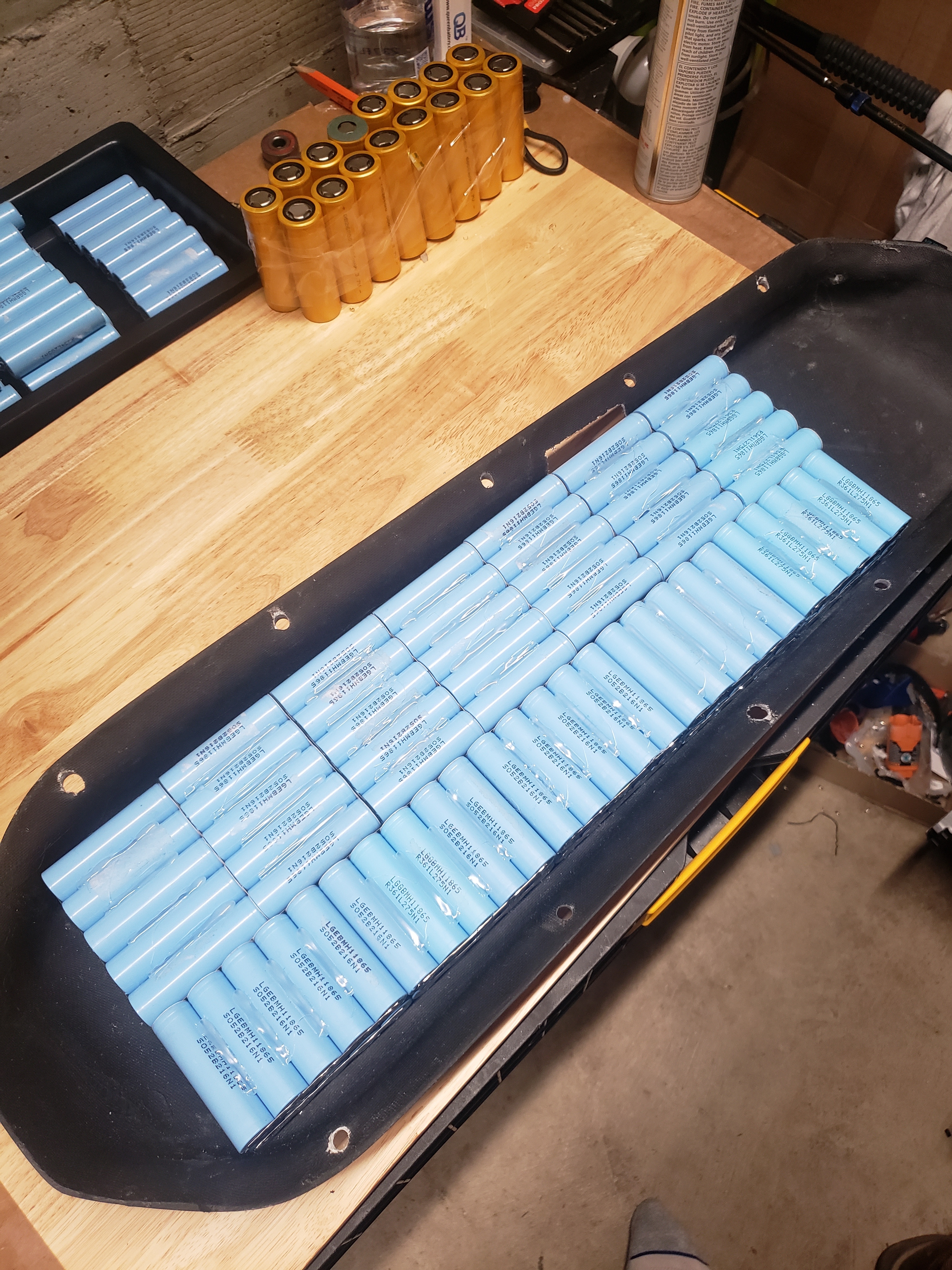

They don’t fit in the monster box, I should have checked. Fail. We just shot the shit.

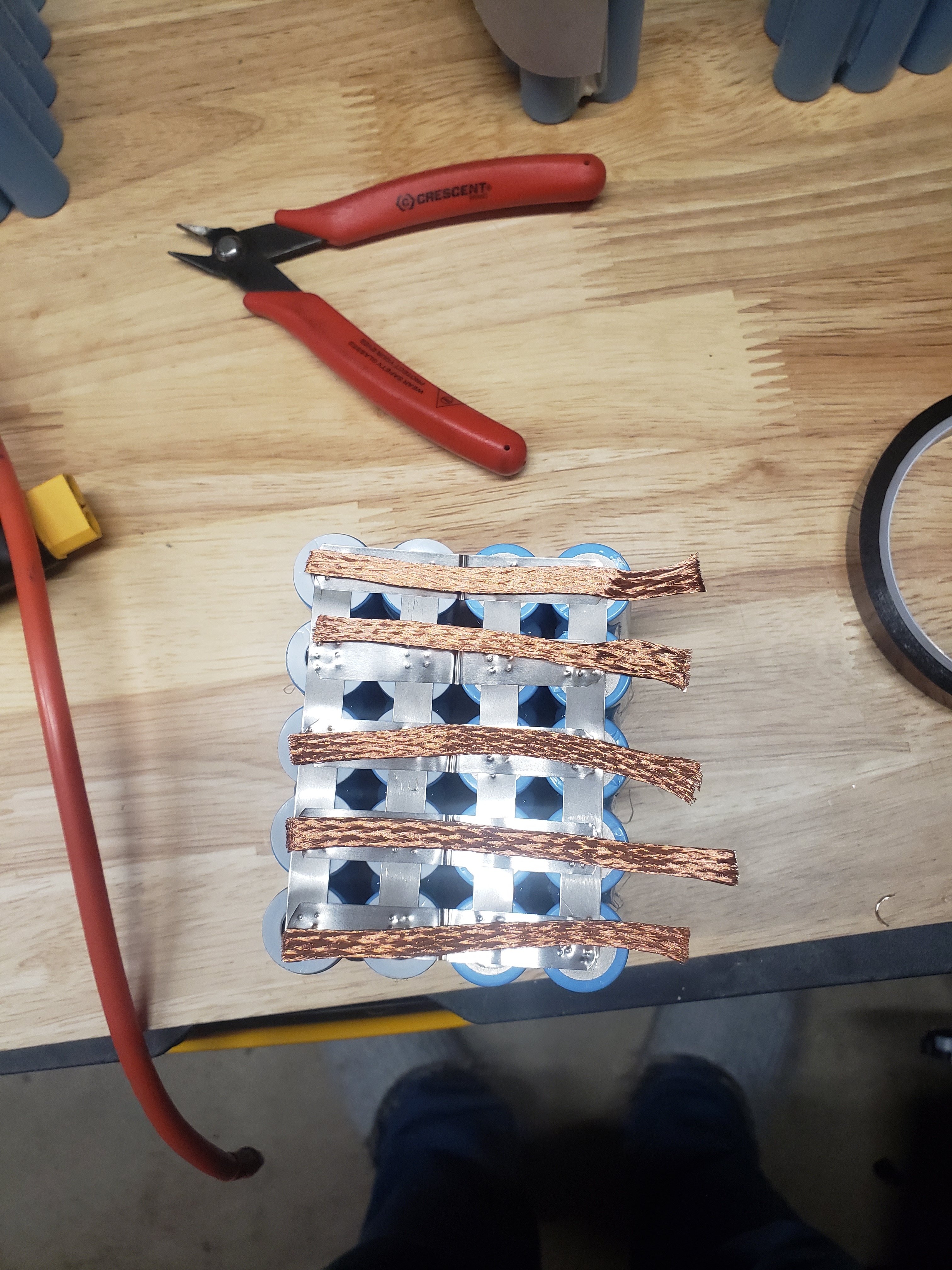

12s10p is the plan

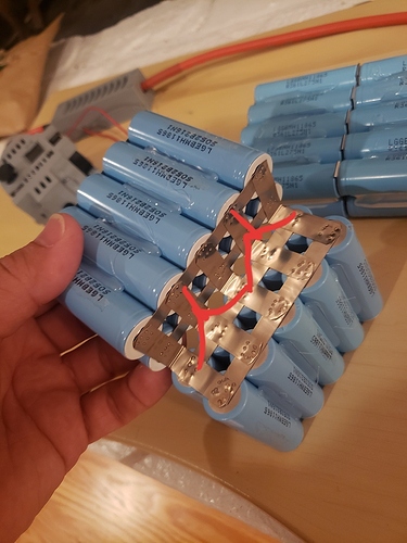

What do you guys think of the folding over method? For that long series connection
As long as it’s not likely to flex then its ok, but I wouldn’t do nickel connections in that orientation for a flex battery. What size is your nickel? 5 nickel strips per series for 100a battery is a little bit on the low side of things but will probably be fine.
Would you recommend more nickel directly over the nickel? This is not going to be a flex pack at all going into and evo enclosure the deck is stiff as heck!
Why?
No, if you double layer that nickel it won’t fold well…
But you could probably do something like this
Are you planning on using the whole 100a? If not I wouldn’t bother.
Folds are fine but those folds are sharp! I would fold them with something in between to create more radius. the rounder the fold the less likely you’ll create stress cracks at the edge and failure from vibration.

So you think maybe a few layers of fish paper in between will do? What do you think current wise? Is 5 strips enough for the series connection?
Actually, instead of fish paper you could fold in something conductive, a strip of copper braid sandwiched in the fold would significantly reduce the load on the nickel alone. Because its sandwiched you probably don’t even need to solder it, tack it on in spots with the spot weld on the edges and you have a solid inbetween connection. But even without, 5 strips at 120A is probably fine. Continuously non-stop it might get hot, but for short periods of time it should be just fine.

Dope! Going to do the braid

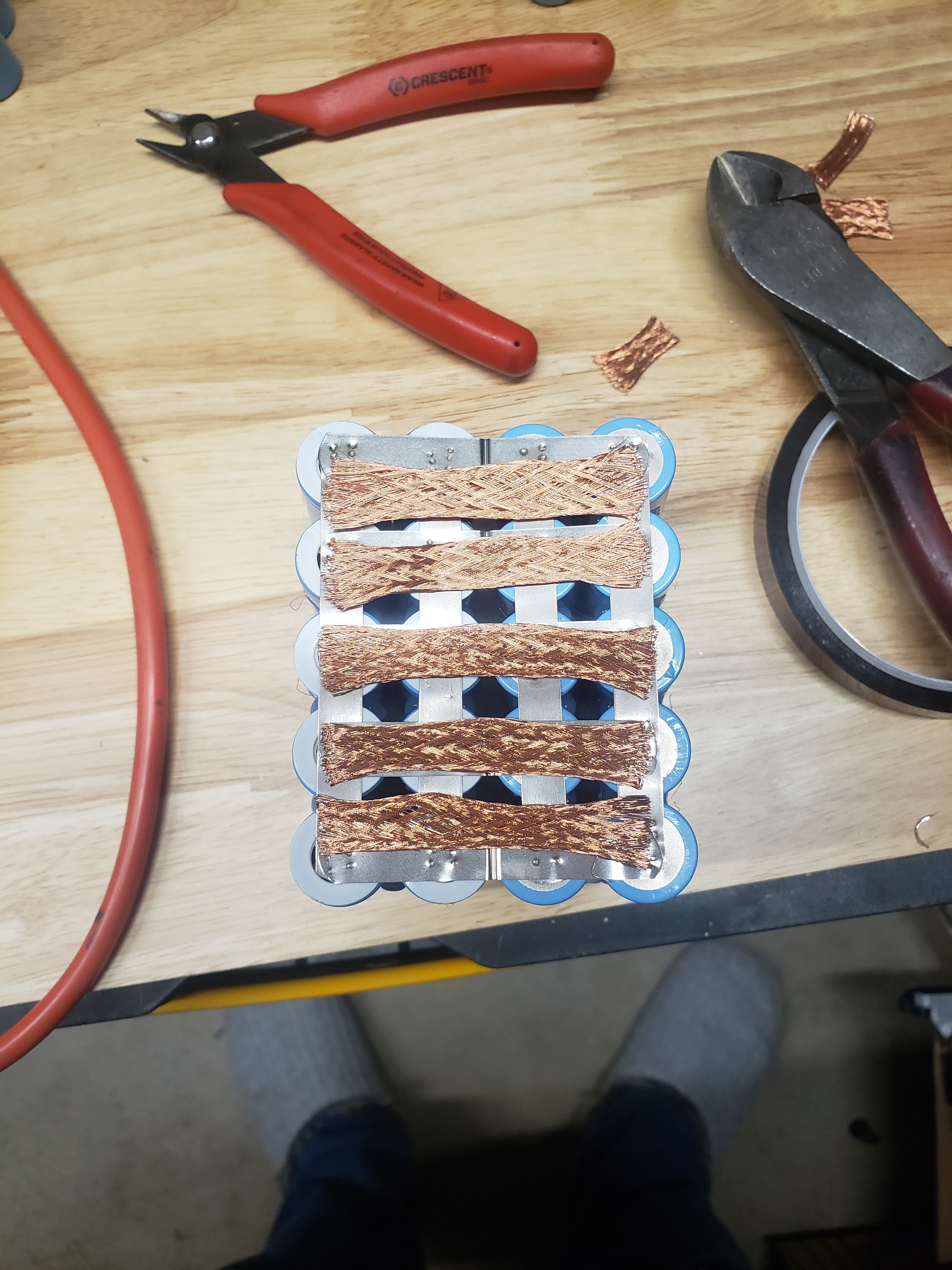

Or maybe this better? If cut to proper length
That way, length wise. So you have a continuous length across, without the chance of creating hot spots of contact. The copper will have enough contraction to allow you to make the fold without putting external pressure on the nickel.
Also watch the edges of the copper, just to make sure it doesn’t fray too much and poke somewhere its not suppose to.
Like this right?
Yeah, that’s actually such a solid connection it’s almost excessive. Going to make one heck of a pack though.
Woooot! Kk gonna weld it real quick
Wooot!!
