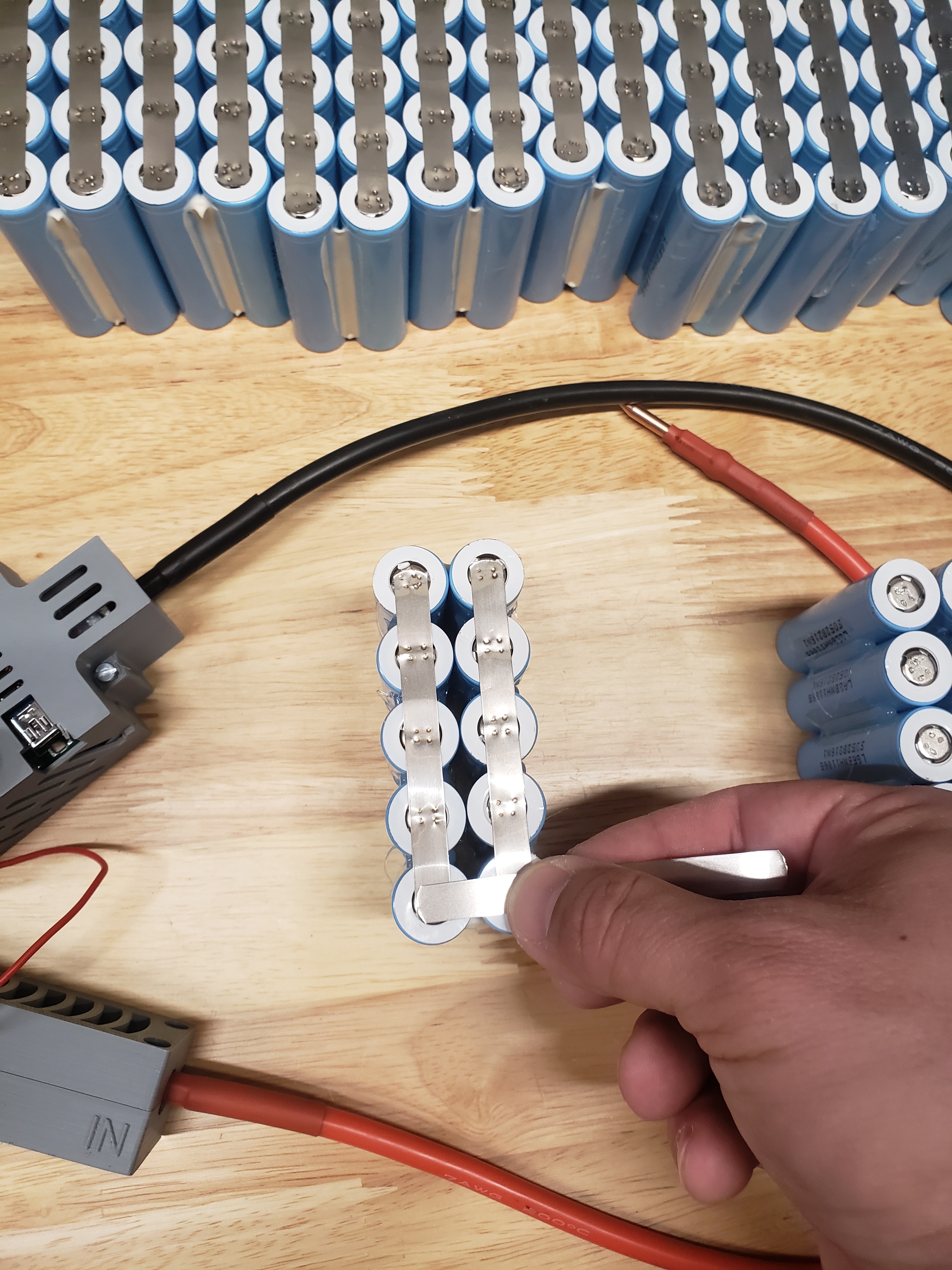

Need some advice regarding p group configuration for nickel strips, should I cut mini pieces and solder them like this
Or will this be ok? Cause this way is waaay less work lol
Depends on your current draw, either way you should not be soldering strips on top of other one, kinda defeats the purpose of welding them. I would say go across, because making an X like that means technically, there is really just 2 strips going across still, would make no difference doing that than if you just welded 3 straight strips directly across (might be better even because shorter path).
I was gonna spot weld the strips to the spot welded strip is that not a thing? Should I have planned better lol?
Oh, yeah that you can do. Thought you meant literal solder. But yeah, Minimizing distance and maximizing material is the best, shorter distance = less resistance = better.

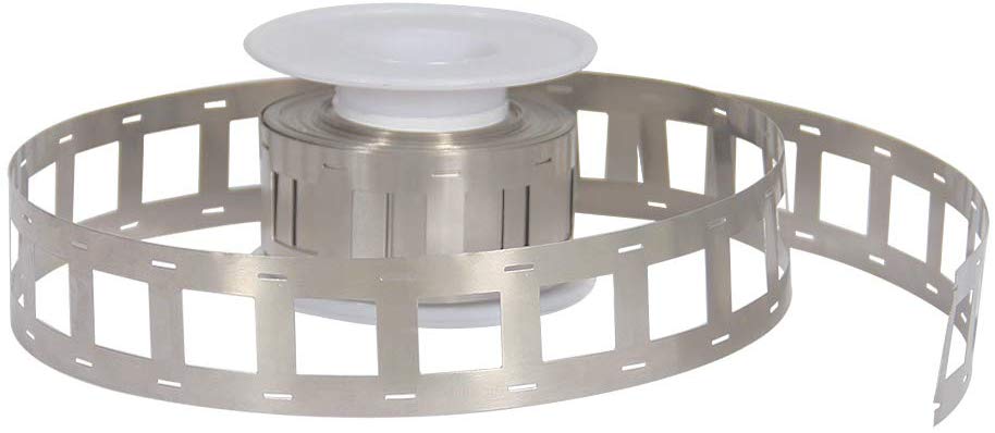

Also for future reference, these things. I love em for what you’re doing.
Dang that means I’m gonna have to weld 10 little piece onto each p group :laughing: 240 pieces, that’s alot of work!
Yeah should have gotten these, and was thinking about it, but i thought they are dimension specific for cell holders?
A bit, yeah, but they come in spacing for 18/20/21 cell diameters. The bridge can sometimes be slightly off but for groups of 5 in a row or less, they line up close enough to do the job well.
Also you can do some math and see if you need 5 bridges per P group. Depending on your amp draw maybe 3 per group, just need to take into consideration where your S connections will be and how much current will flow through where etc.
Planning to draw 80-100amps
Absolute max would be 120, I have been happy with my 60 amp battery, cant imagine needing 120amps lol so that comes out to less then 10amps per p group
All the amps go through each P group. P group is for amp and S is for voltage. 120A means 120A per P group but divide by 10 cells, so you’re doing 12A or less per cell.
The way I see it is, if you do the X pattern, it would actually be helpful IF you connect your series jumps in the middle of the X. That puts the shortest distance to all cells via nickel. But each P group will be extremely stiff, so more prone to breaking welds via vibration if the cells are not properly braced. (the X will be a lot more structurally strong but that also puts stress on the connections where across can flex and tolerate more bending).
Gotcha, yes thay makes sence. Hmm gotta think about this. The x solution not looking too bad, plus I think it will work with my lay out
