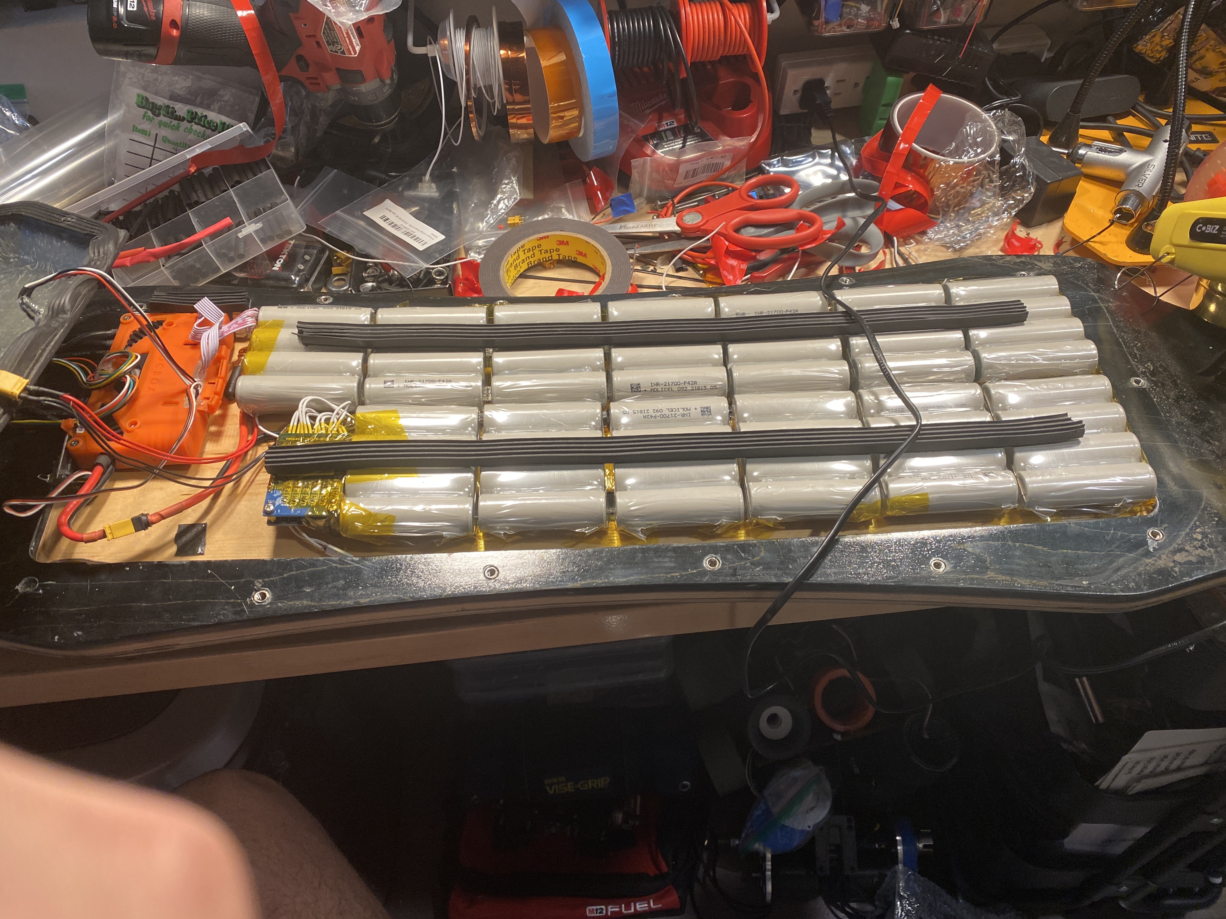

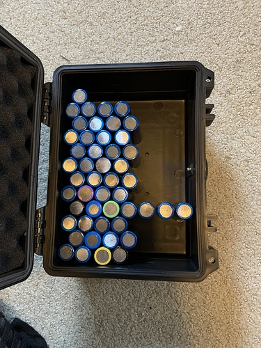

I’m planning a 12s4p and 12s3p 30Q pack for my eMTB, I what to have the 3p one removable so I can transfer it to my other build on occasion…should be just possible if I put the BMS and wires on the top right? I’ll have a splitter on the charge port and discharge port through the enclosure so I can charge both then connect the second to the ESCs
I think maybe I can slot the BMS at the end, it’s pretty thin…12mm?
Why not BMS above? These cases are usually much taller than needed for cells even with foam securing on all sides.
True true, think I can fit 2 BMSs and all the wiring on the top? It’s another 20mm to the top but I need to account for the copper bus bars and nickel on either side of the cell
You shouldn’t need bus bars if your cells are that orientation. You’ll have a series connection between each cell with the parallel connections.

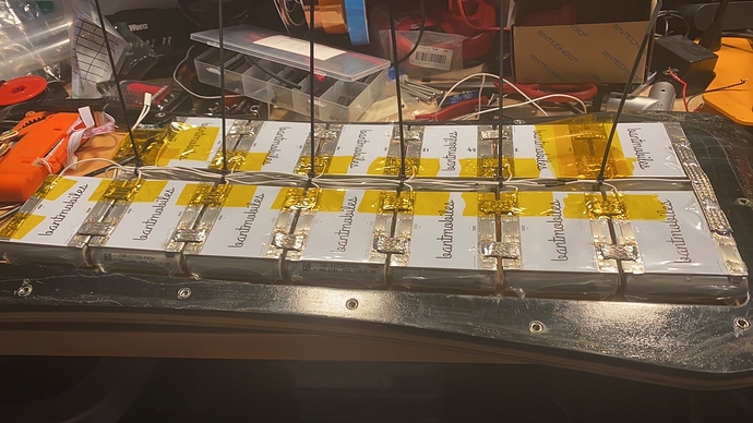

What do yall think? I doubled up on the nickel but didn’t get a pic of that.
My only concern is possible friction damage from the zip ties
Yeah I didn’t pull on them hard. Just enough to keep it together. Should be fine tho. 22GA balance wire shouldnt warm up at all.
Why not use shrink wrap for wires? I’ve taken tubes and cut 5mm lengths for all by balance leads instead of zip ties, super neat if you plan them right
That’s conter intuitive, no? If you cut apart a cars wiring harness every zip tie is drawn as tight as possible. I believe the operating principal is, you can’t have friction wear if you can’t have any movement. Build in slight slack if needed for flex and sinch them down.
It’s tight ish . I’m sure I can pull it one more notch but that will probably squish the wires together too much. Kinda afraid they will fuse together but it’s also not gona be hot from 50mA balance current
