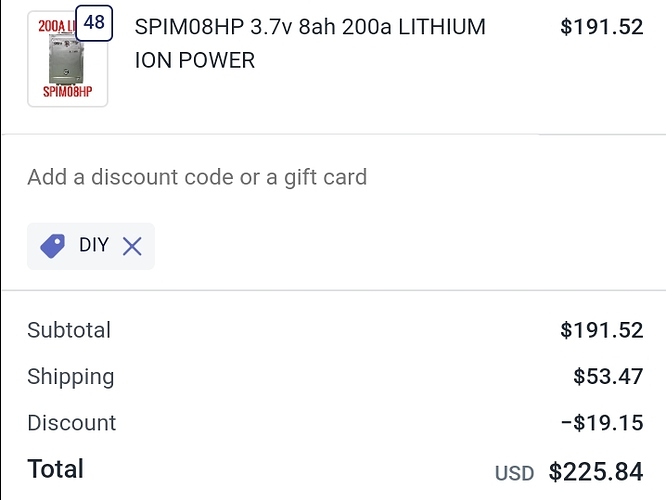

Must hold back… $4 a cell again
20S4P 2.3KWh and 60KW out.
whoa. where?
Haha, dude, stop! Have you found something really useful for these yet? I’m getting a spot welder just because I’m looking for reasons. My pouches will make their rounds through a few projects and probably end up in a cart, but IMO 7-8 nissan leaf modules would have been better, weigh less, and for less $ for some equivalent power.
That might be true actually, but the Nissan modules I would have had to tear apart. These come more or less ready to go.
Today I am spending $300 on @torqueboards so stop indeed I must.
@RyEnd damn one of the 4 32Ah cells is 118Wh for $12.5 :thinking: pretty compelling, the teardown video I watched was not though.

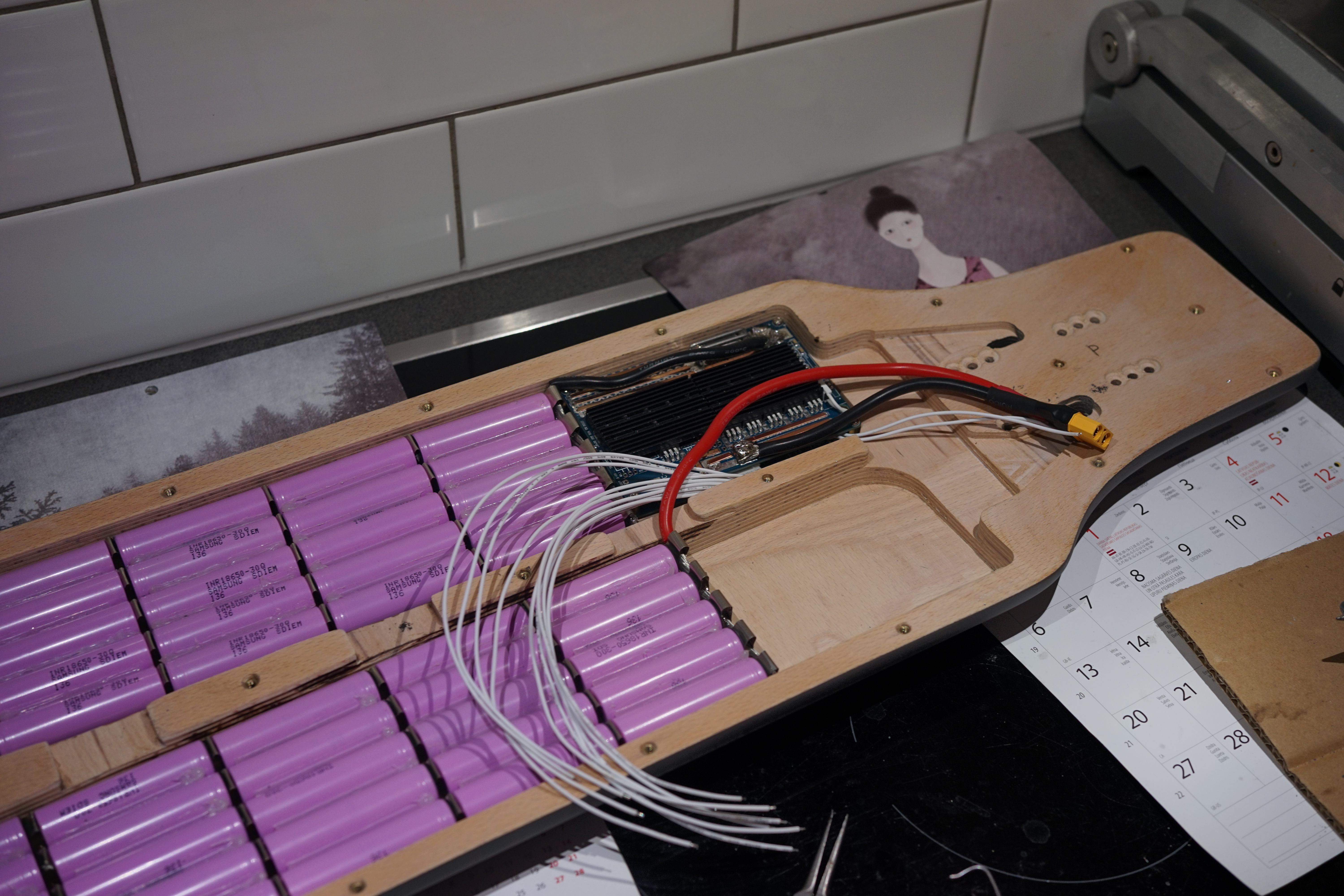

Hey guys, I’m nearly done making my first ever battery (wish it was a simpler design than what I have :sweat_smile::gun:), and wanted to check in with you first before I finish.
I’m pretty tired of sanding away the middle beam of the Haya shortboard, so I was thinking I wouldn’t wrap each group in fish-paper and heat shrink (which would make the pack wider, requiring me to make more space), but just put fish paper on top of each p-group, then solder the balance wires like I already did with the first (fish paper would be between the balance wires and cells, protecting from shorts). Finally, I would use kapton tape, and then packing tape (because kapton isn’t durable) around each p-group connection point to protect the balance wire connections and nickel from shorting with anything from above.
Do you guys think that would be safe? Maybe you see any mistakes I’ve already made? Any other ideas? Or do you think doing it properly by completely wrapping the groups + heat shrinking the whole pack is the way I should go…
I would trust that. Wood isn’t conductive, no real purpose in wrapping it more because nothing will short even if the battery wrap got worn through. Just lay some fish paper or cloth harness tape underneath the balance wires and maybe some thin foam or something on top to keep the cells from vibrating around. Could go one more step and put some hot glue between the cells and the side of the wood but don’t think it needs that either.
