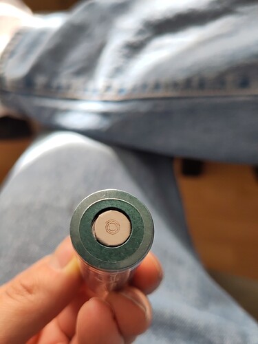

Is this the remnant of a laser weld?
Got the same thing on my 40Ts from NKON… supposedly new :upside_down_face:
Other than that they seem unused and the voltage within a box is super consistent, but I haven’t done any capacity testing
Did you buy them as “new”? I got mine as “Reclaimed”. According to nkon reclaimed cells have never been used, and are from unused packs. Mine were also very consistent, all within 0,05V.
Selling them as new would be a stretch though. I’d message them for some money back at least.
Mine: ↓
https://www.nkon.nl/de/samsung-inr21700-40t-4000mah-35a-clear-wrap-reclaimed.html
Wow, thanks for the heads up. Definitely bought them as new:
3.55€ a piece…
The fuck up is that I have already welded all the ones with the markings. Would you mind if I used one of your pictures? They look exactly the same.
Well, the exakt same price is a clue :smiley: Maybe a mixup? And yes sure, you can use it. Good luck with the CS!
Not exactly, 3.55 after ordering 200 (the screenshot is my confirmation email), I would have gotten them for 2.9! That’s how I’m sure there’s a mixup.
Thanks!

Oh yeah you’re right, just saw that. Then you are definitely entitled for some money back imo.
