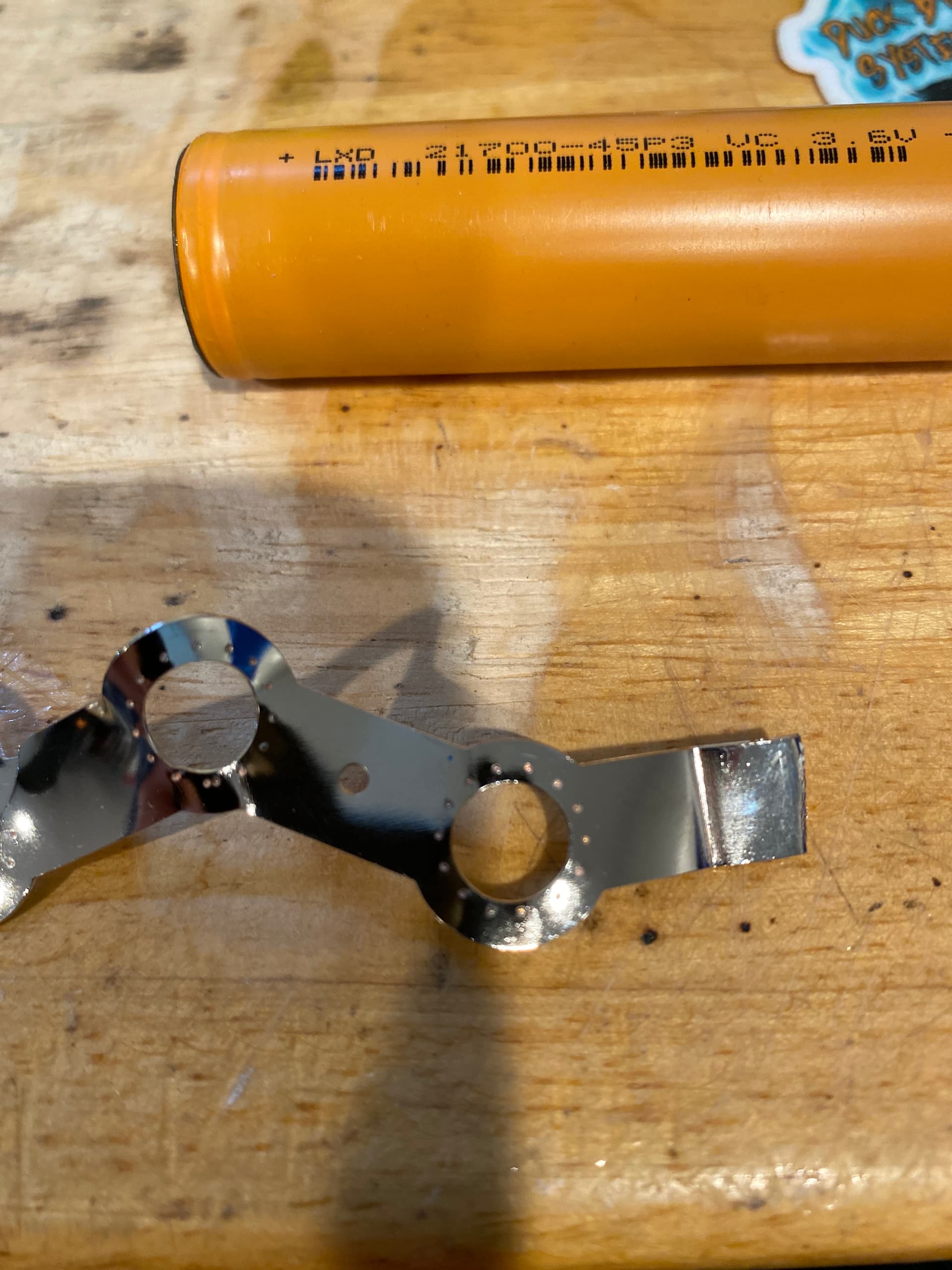

Ok so i got some ebike batteries from a shop I stopped by to recycle and found this stuff used for the Main positive and negative output groups of the battery. Really cool shit, its .5mm nickel clad copper with .2 mm welded to it for the cell connections. Seemed legitimately the highest ampere connection I’ve ever seen and i was kinda sad to tear it down as it was just a bad bms for the pack but the voltage was wrong for what im doing.
The cells in it are pretty cool but have no real online presence except on alibaba and tested at 4600mah and ir of about 100mohm. Spec on the one seller states new ones are 5kmah and ir of .02 but the ones i got were warranty discarded as the bms died at 5-10 cycles… so probably false specs.
@vegr0 i can send what i have from the demolition if you’re interested

I’m sorry to hear that. Are these the Lishen cells?
Absolutely false specs if that’s a DC IR spec. They could be 5Ah at 20mOhm AC IR though but even that is a bit of a stretch.
